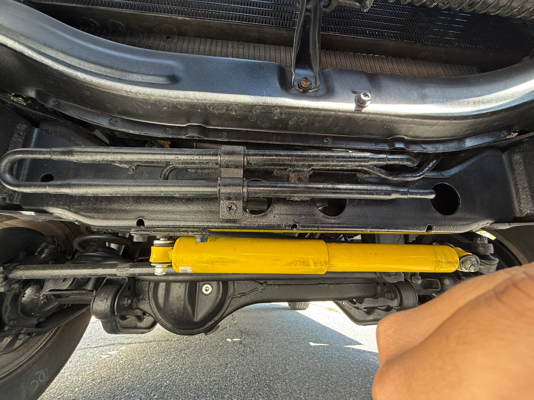

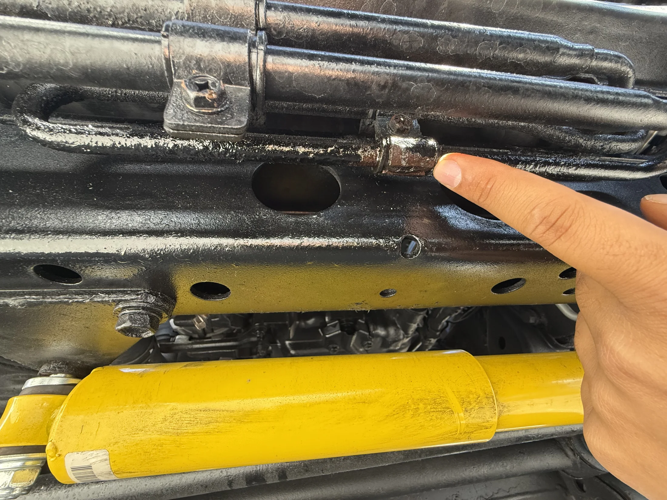

Hello, in need of some advice for my power steering leak . It seems to be leaking at the clamp that the cooler lines connect. Im having a hard time finding the part number for that clamp & the lines itself.

Leak is likely from the pipe (corrosion) under the clamp

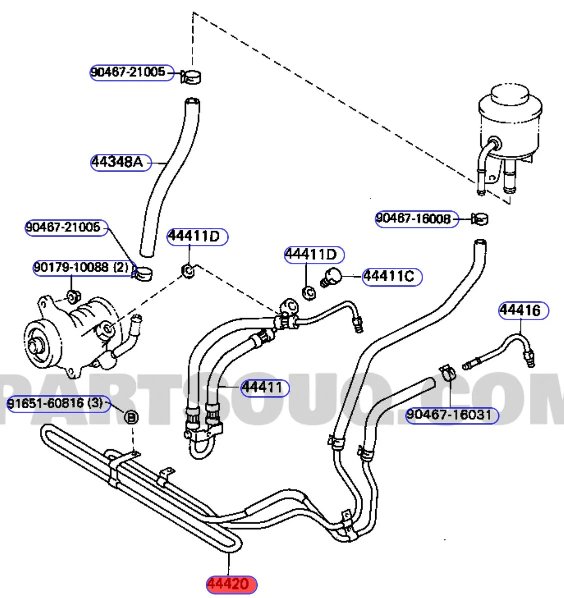

Diagram below is from Partsouq (UAE). Type in your VIN and your model will come up with diagrams and part numbers.
On the website, when you hover the pointer over the numbers, there will be a link to a photo of the part you're looking for:
Welcome to Mud
44420-60220 superceded to 44420-60221

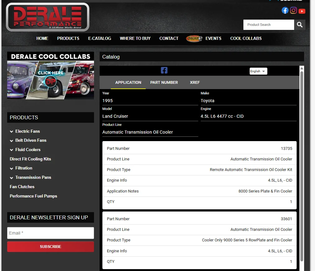

That cooler has never been cheap, but $400 OEM and $235 from the desert sands (less $250 brokerage and customs fees, not to mention shipping) is a bit much. As much as an OEM purist as I am, I'd have a hard time not buying A Derale fin and tube cooler:
Derale 33601

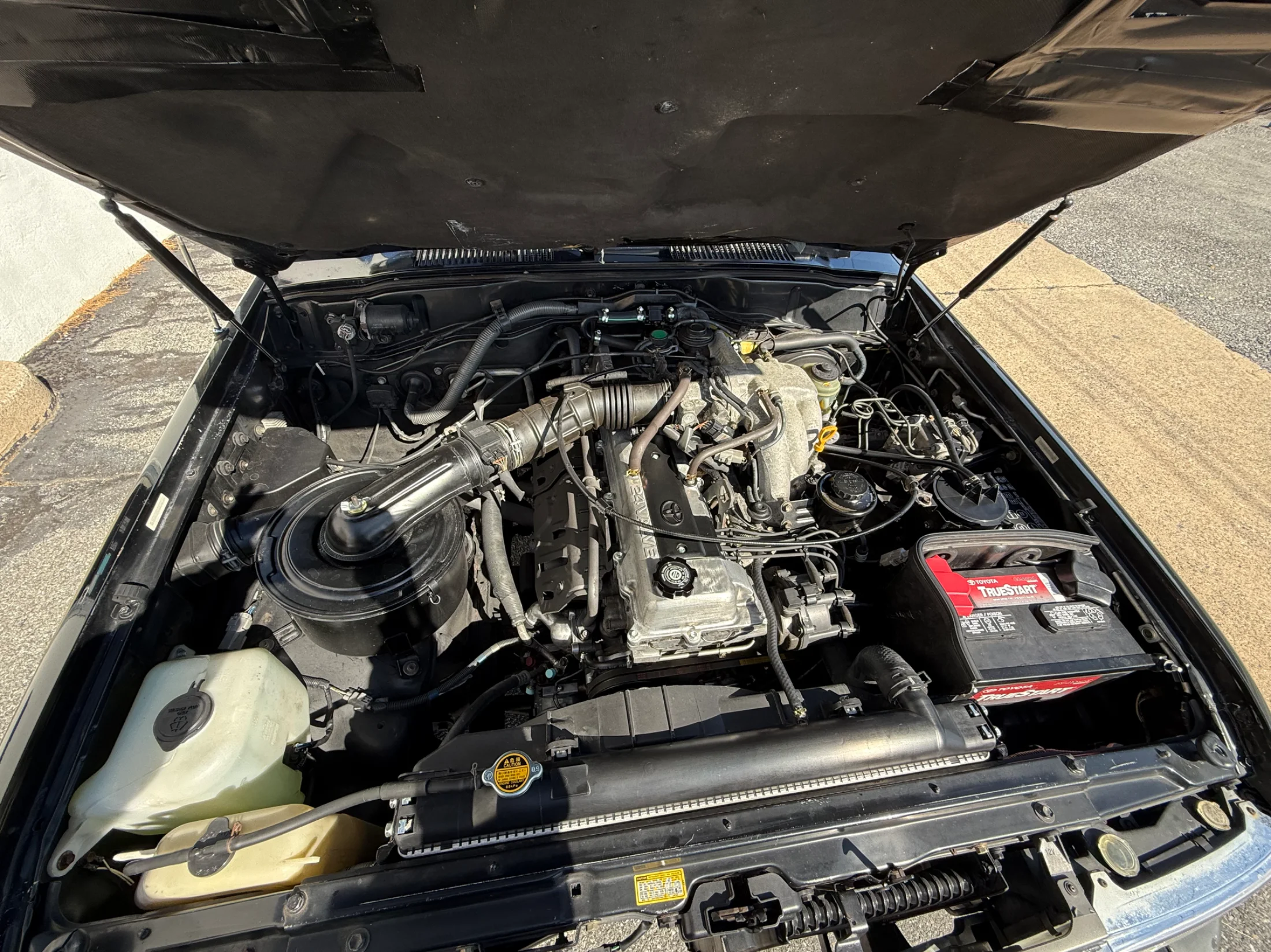

That is one CLEAN engine bay! Your grandad took super great care of that truck.
