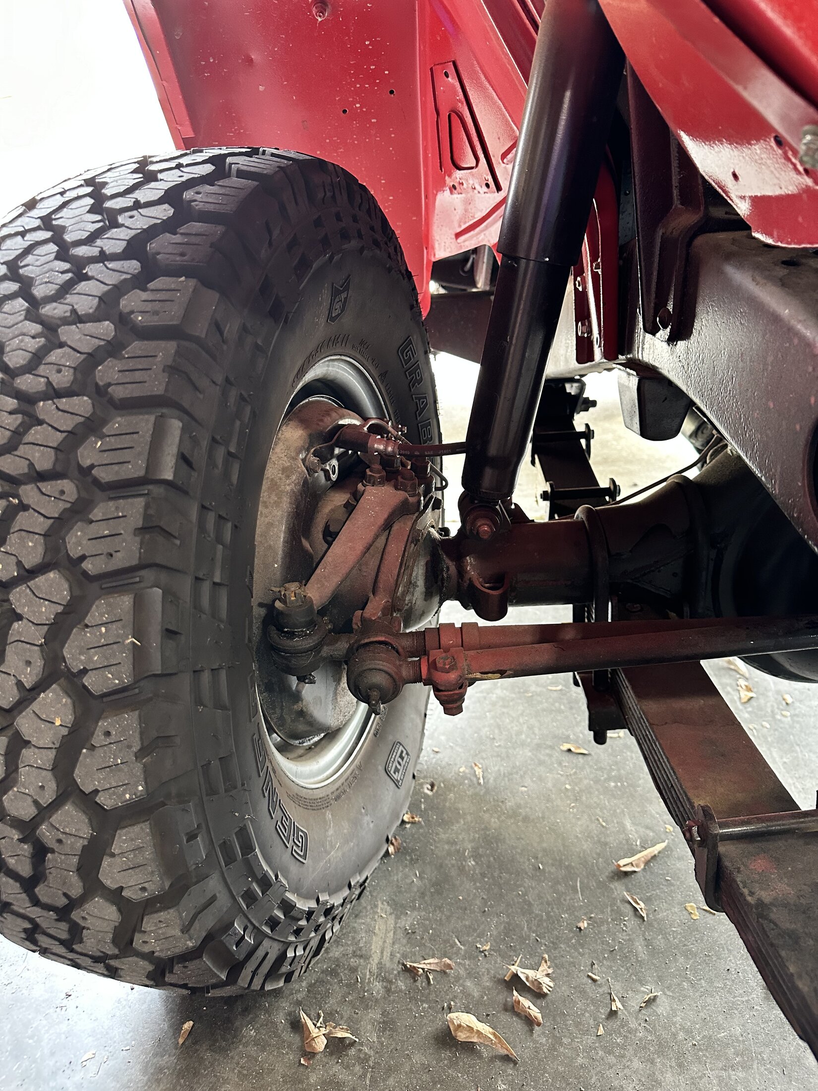

If it gets to full stop on the axle stops going left and does not going right, try shortening the relay rod from box to pivot. You can do this with the adjustments at both ends, don't do it all at one end.

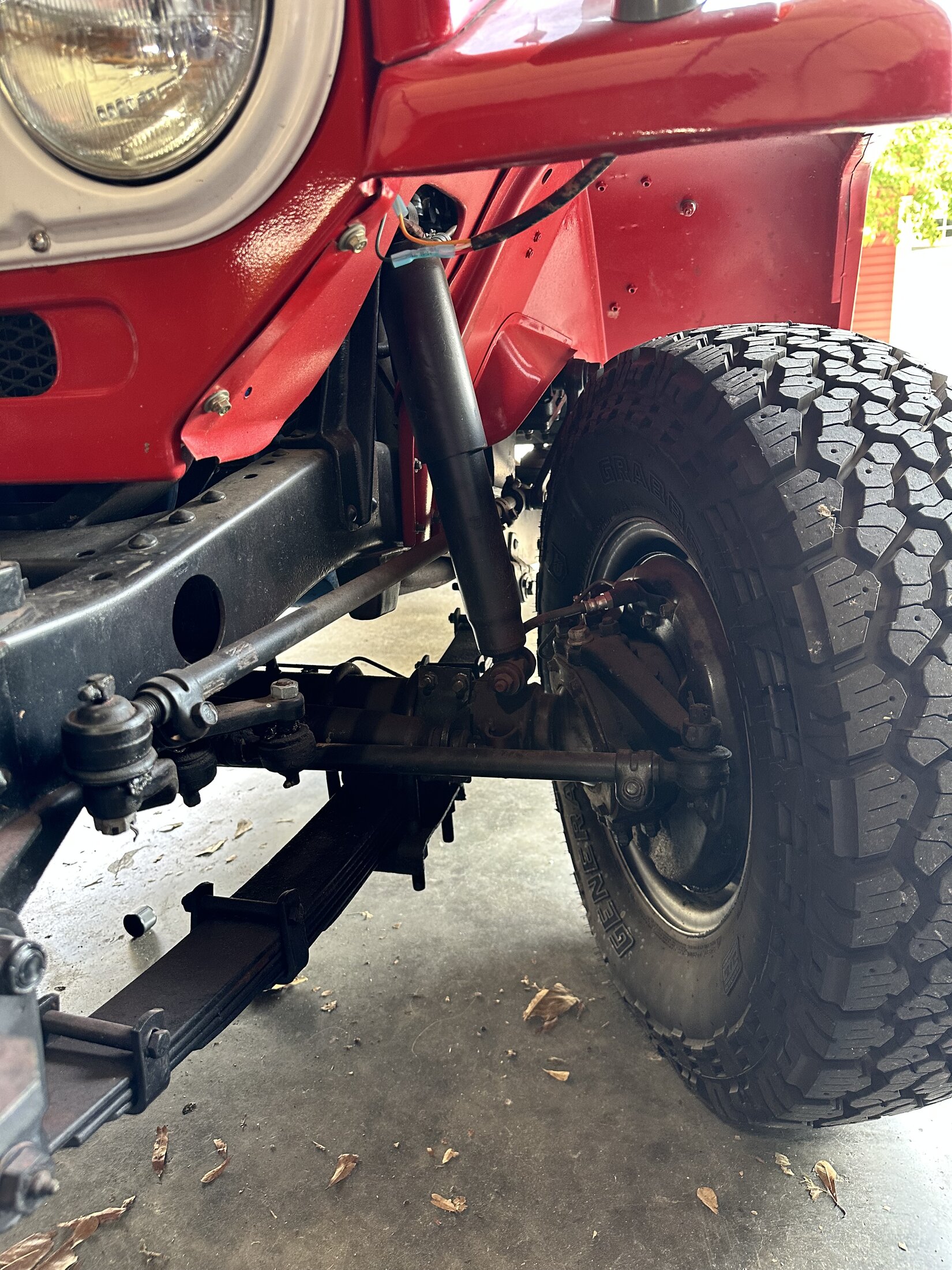

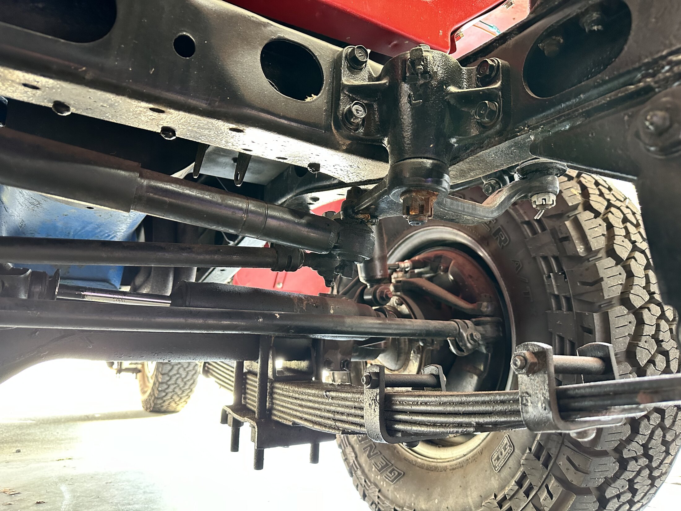

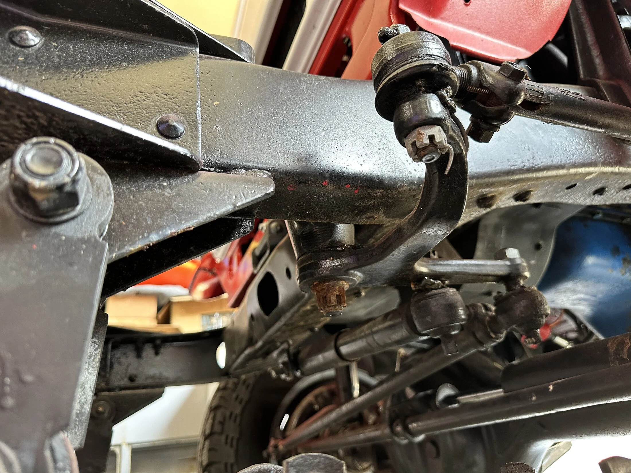

Unless you feel like doing the job twice, you’re going to need to replace that bent drag link first.

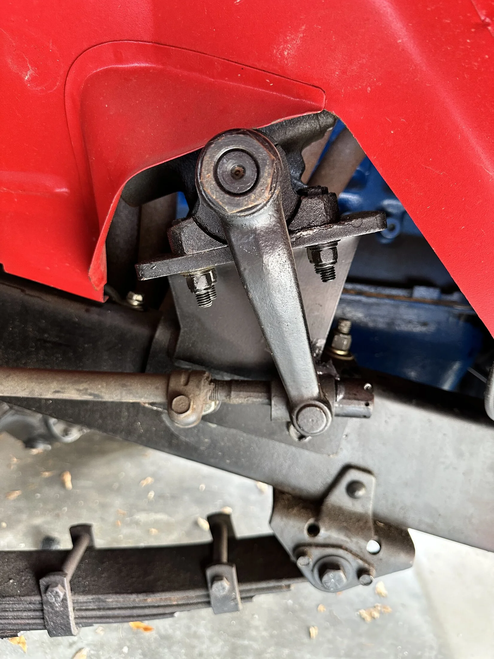

And unless there’s a gusset hiding behind your pitman arm, you should consider adding one between the horizontal plate the the steering box is mounted to and the vertical plate that goes down to the frame. Both sides.

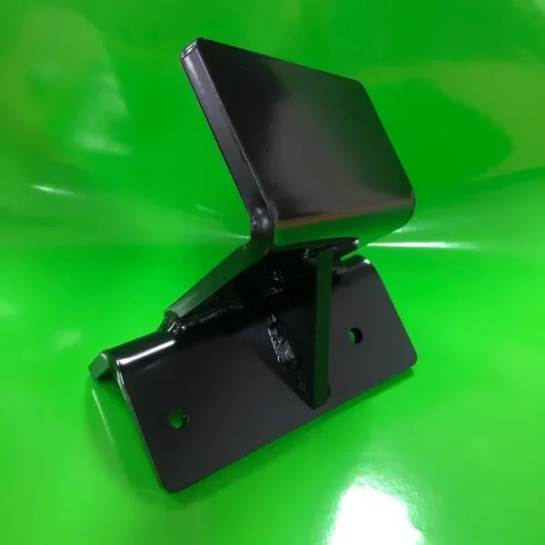

It looks like the bracket that JTO sells. Looks like the tow is way out maybe also. Missing cotter pin in center pivot.
