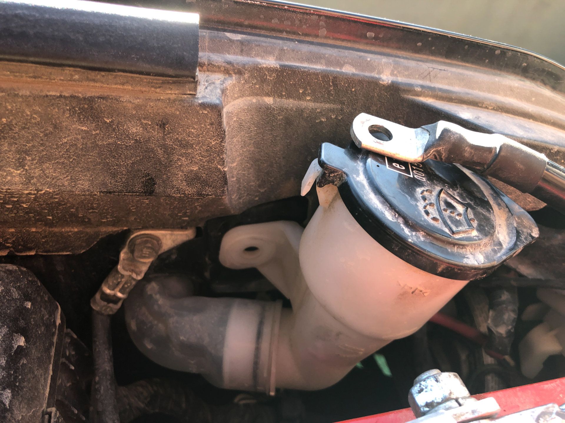

Help identifying missing bolt for windshield washer fluid mount (1 Viewer)
Feb 25, 2019
40
781
San Clemente, CA
Any ideas on a size x length?
It’s actually one of these push clips:
EZYKOO 100pcs Car Rivets,Nylon Bumper Compatible with Lexus Toyota Body Clips,Splash Shield Clips 90467-07201 Replacement Fasteners, Quality Push Fasteners with Bonus Fastener Remover Amazon product ASIN B074X9WF68
Simple enough, thanks!
Plastic clip. Any Toyota mechanic should have every size for your rig. My
im in Silverado. I went o HIROS AUTOMOTIVE in Costa Mesa. They had every size of clip @ the shop. They Gave me one. Check a Toyota or Lexus dealer. I’m sure they have them. How mine popped out I have no idea.
Thanks. The frustrating part is i noticed less than a week after i had my 70k service in which they top off the fluids. Would have loved for them to see it missing and replace it.
Also, probably not a good idea to ground to your washer reservoir! :rolleyes:
Ha! Was investigating some battery gremlins, that’s from the winch.
Gotta love mud, I just noticed I am missing the clip (90467-07217) for the filler neck (85301-60060) for the windshield wiper fluid reservoir (85355-60210).
