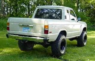

Eeek.... What's wrong with the 60 body? Or cut it back to make a pickup version? Or mount up a fj40 or 45 on the frame.
attachment.php
