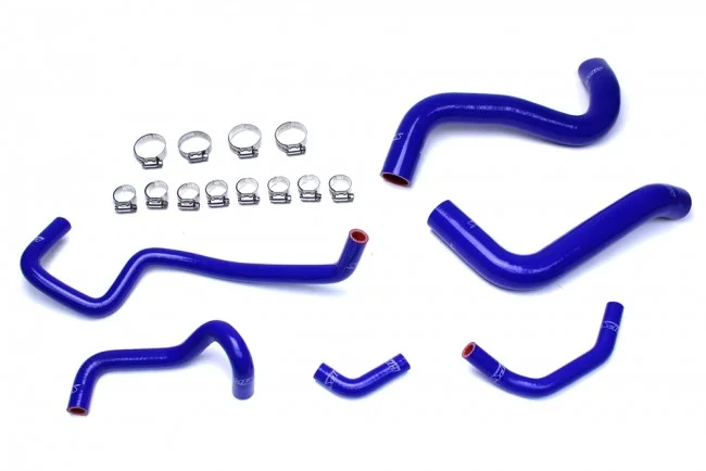

So I bought a silicone hose kit from HPS, figured now's the time since my truck's apart for the rebuild anyway. I know where 5 out of the 6 hoses go but cannot figure out where this last one goes. Here's the kit:

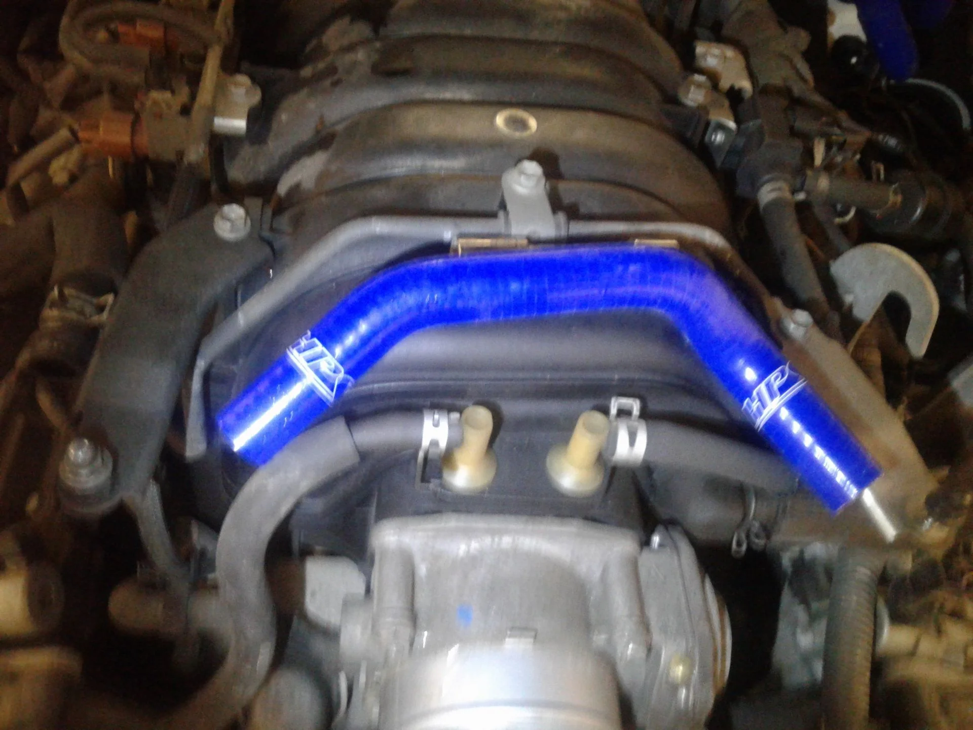

I've done the heater hoses and the small one that goes to the oil filter housing:

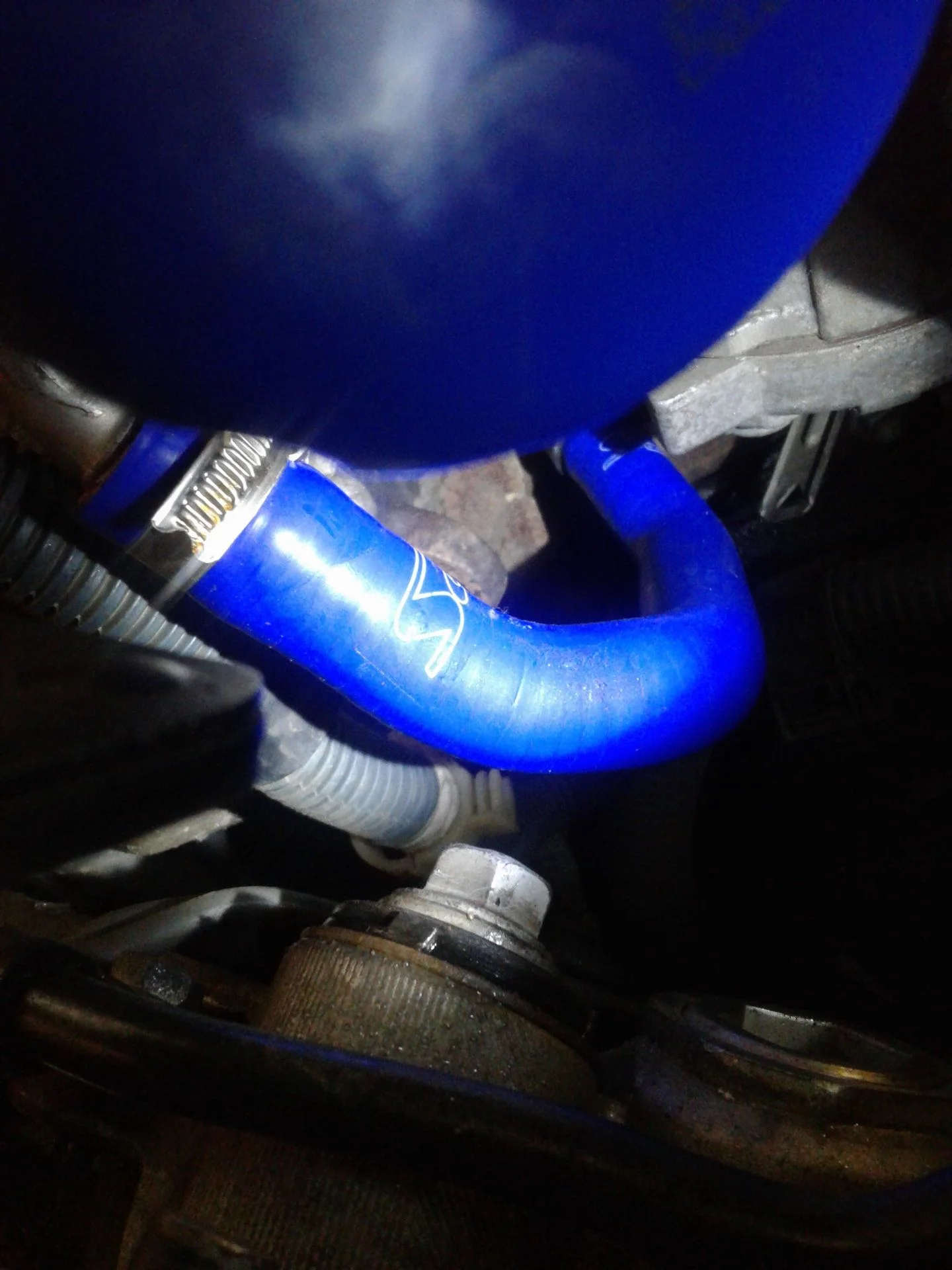

And of course the large radiator hoses are a no brainer, but I cannot find a home for this one:

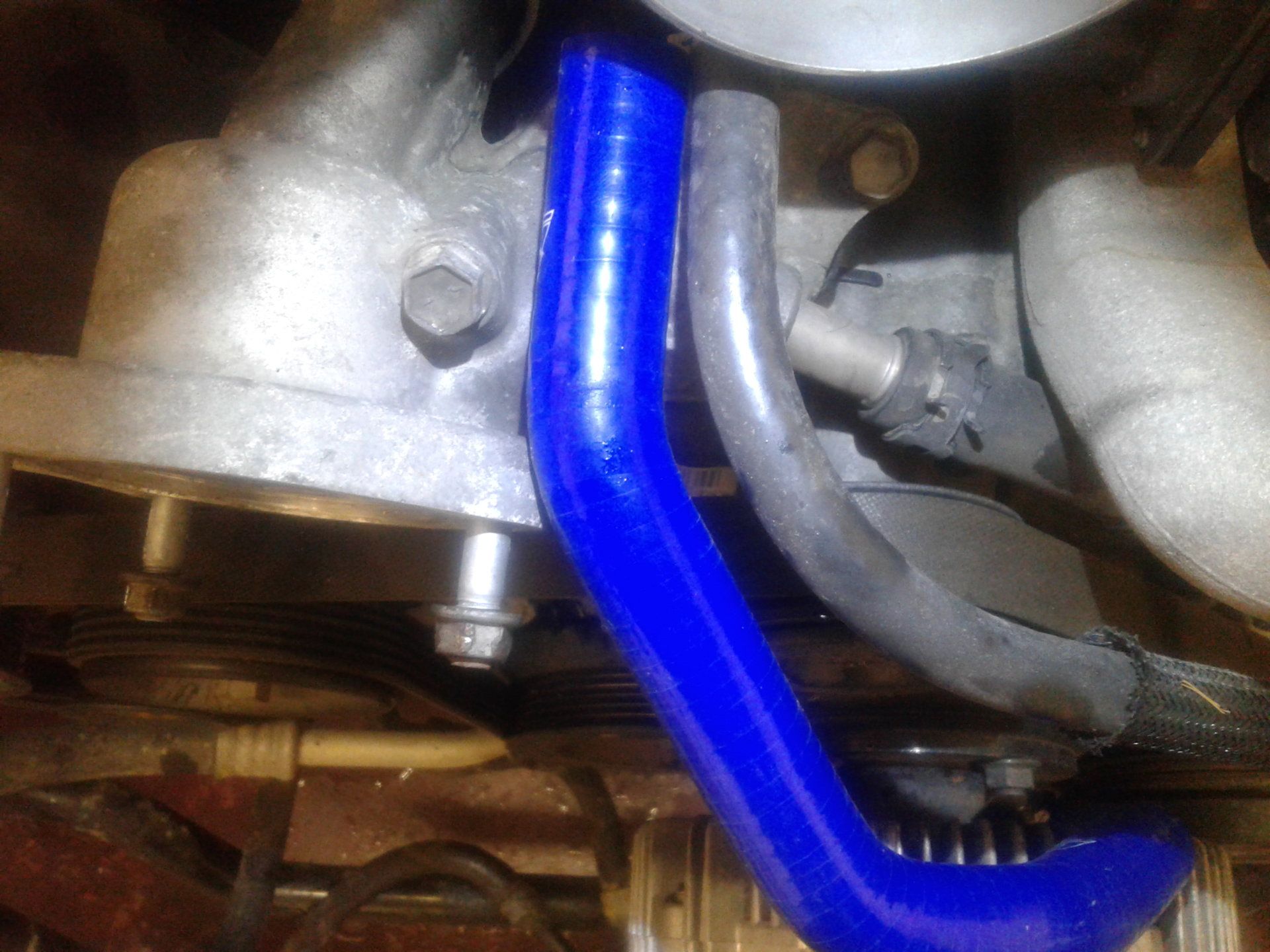

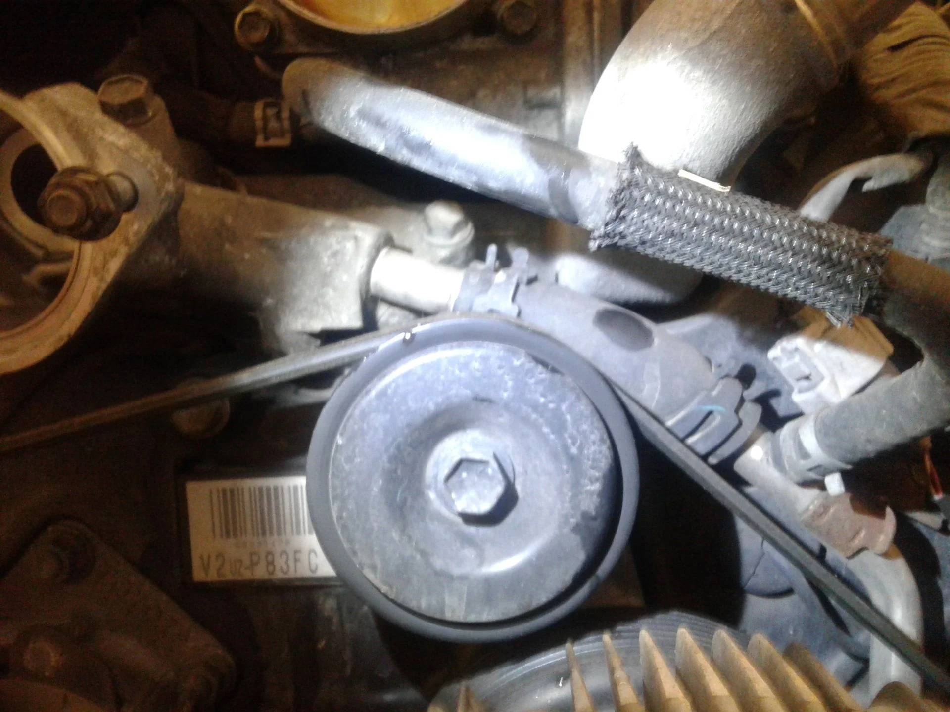

It's on the bottom right of the first pic in this post as well. The only other coolant hose I found was this super short one, above the pulley in the following pic:
Seems like that one should be replaced since everything else is, but the leftover hose is much longer and bent to fit "somewhere". No instructions with the kit or on their website, of course...

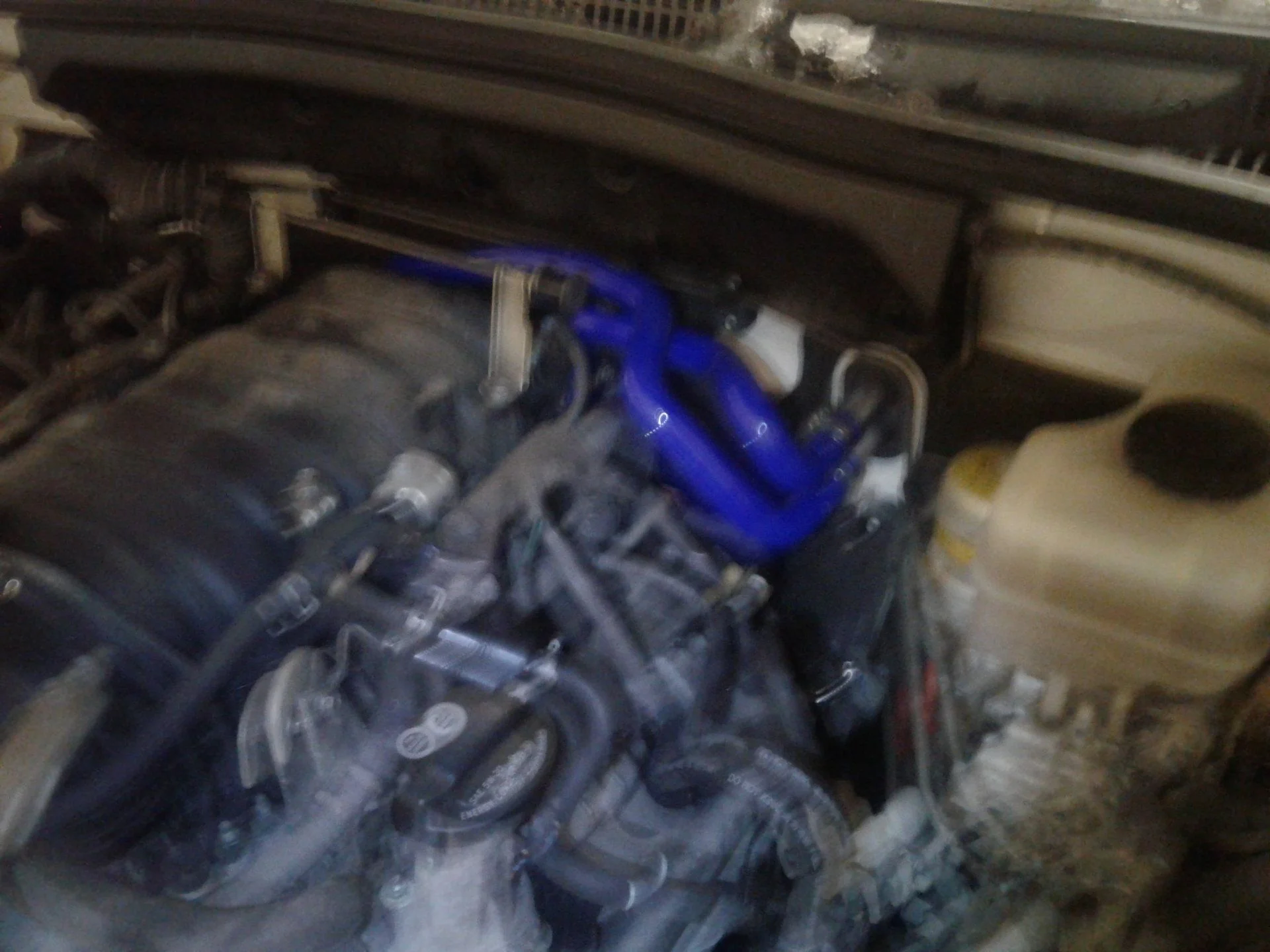

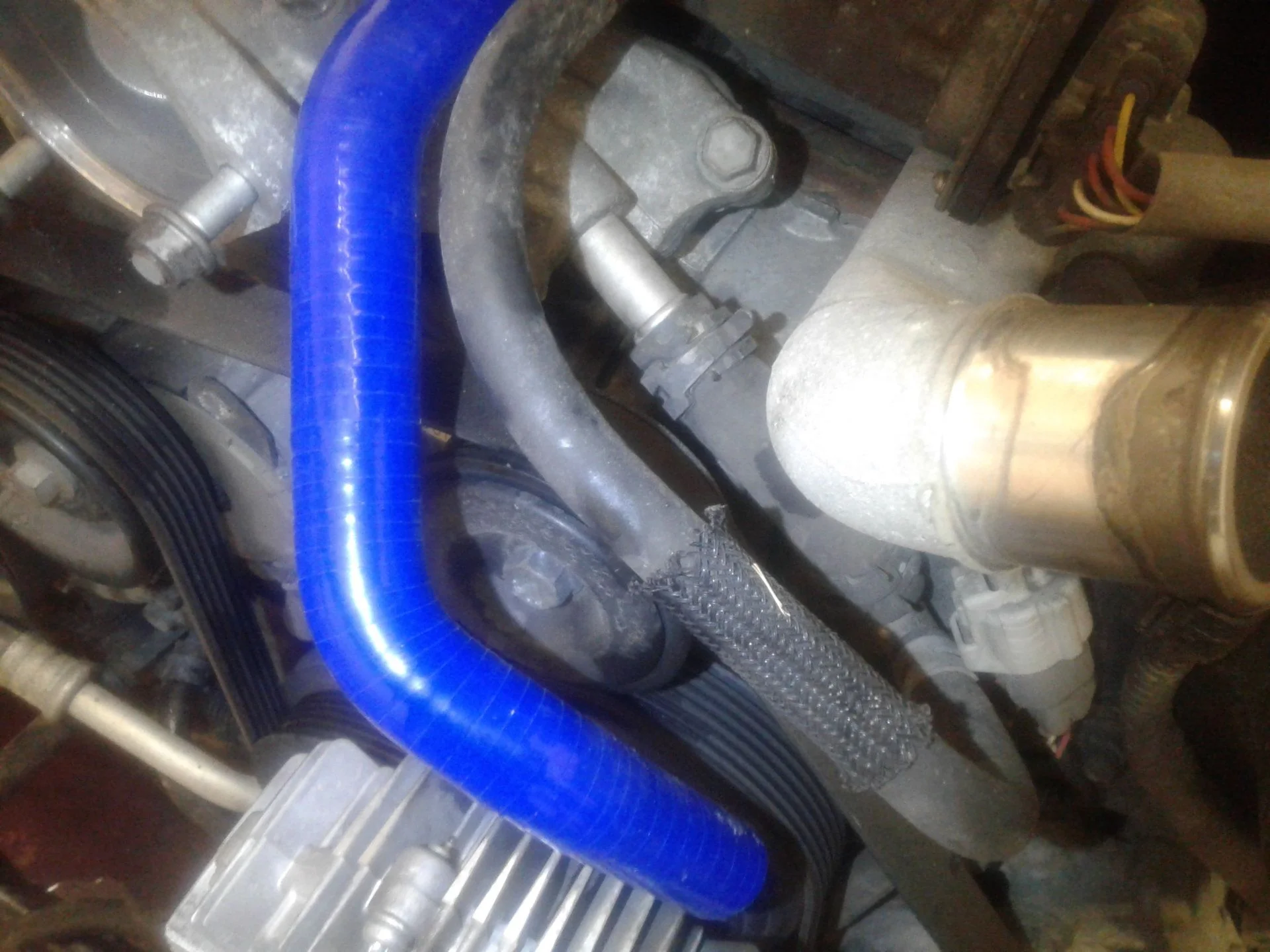

Found the answer on the 4runner forum...it comes out the rear side of the oil filter housing and routes to the driver side engine block right behind the AC compressor. Gonna be a bizz-nitch to get to the clamp, pics of the install and my bloody hand later...

Best pic I could get, while I can still get it...
