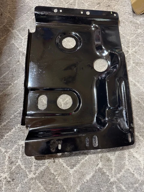

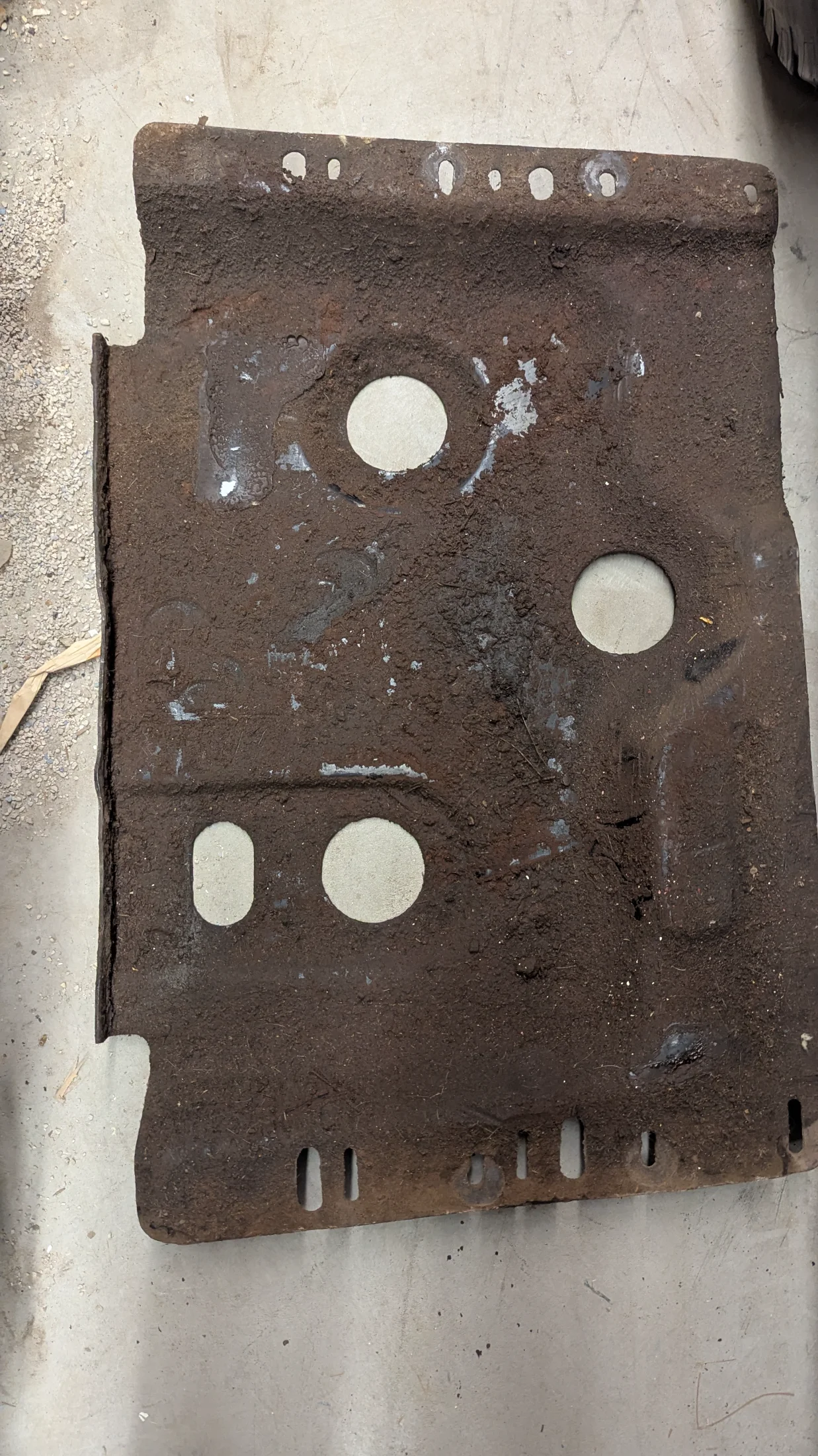

I “think” it’s a 4 speed but I can’t seem to match up the bolt holes on my ‘75 FJ40. Maybe I gave up too quickly. Your thoughts are welcome .
I know my 73 has four sets of fixed nuts on each side rail. Both fill three and four speed skid plates will bolt up. How long Toyota continued with four bolts not sure. If your 75 has four sets it will bolt up using the front three holes. How that will line up with the transmission and transfer I'm not sure.
Thank you….there are 4 holes in the frame so I’ll get back under it again tomorrow and try to get it matched up. I do think though that the 1” 90* lip on the back is going to interfere with the transfer case… I’ll get back and confirm

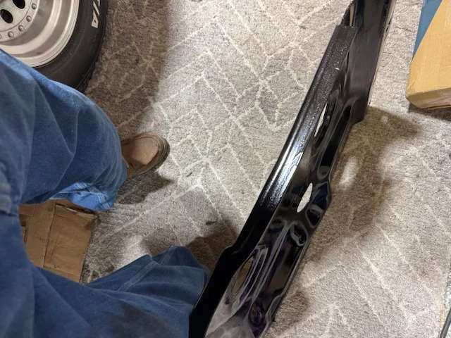

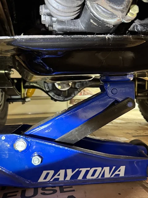

Hmmm… I didn’t have the greatest method of trying to line it up. My upper body strength wouldn’t engage as easily as I’d thought so tomorrow I’ll use a floor jack and position it better. It got heavy real quick after I didn’t get the holes lined up on the first tries.

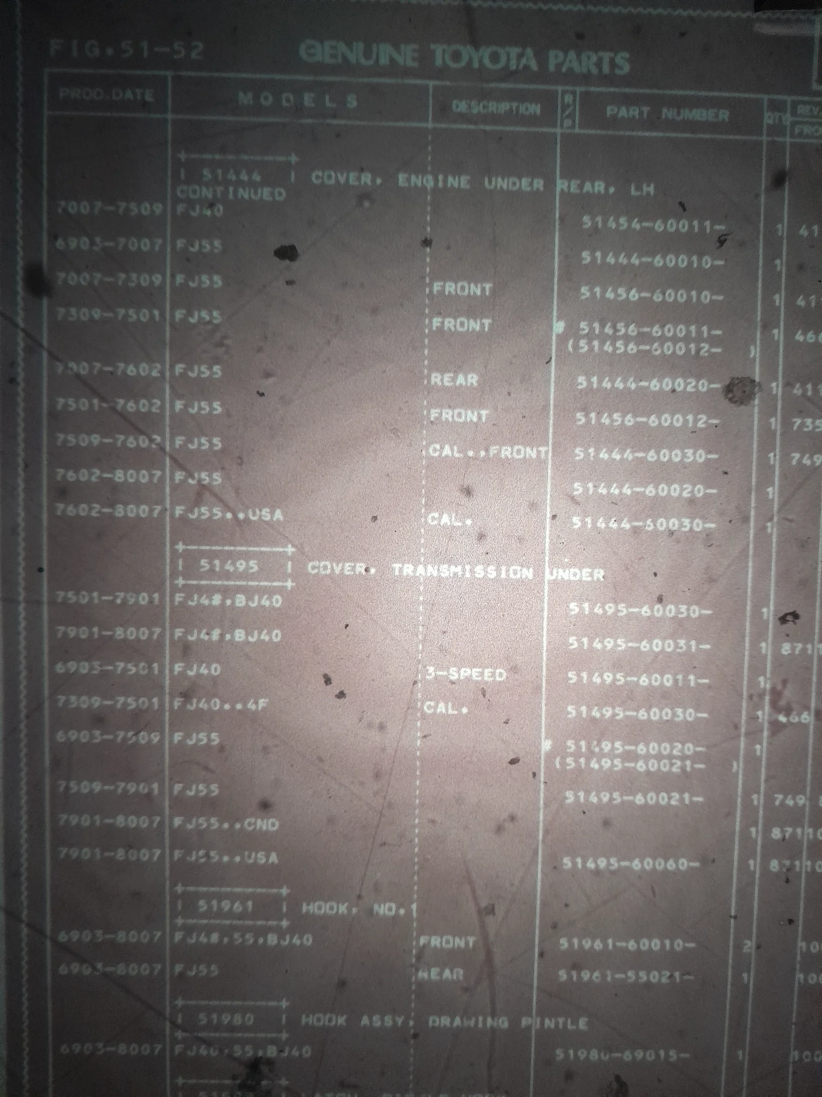

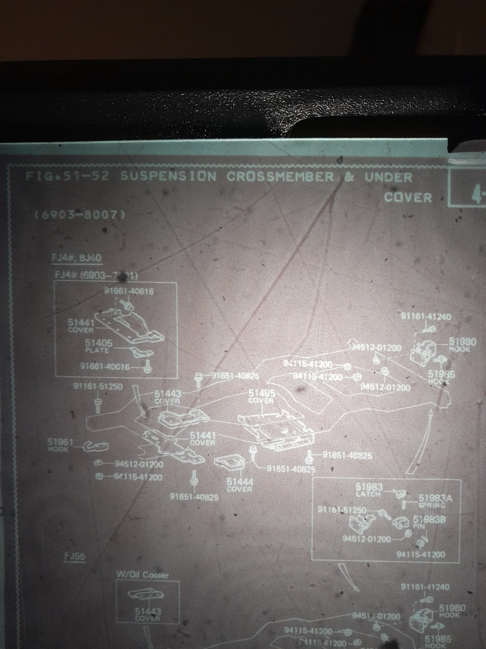

That skid plate looks nothing like the one on my 01/72 build with floor shift 3-speed. The microfiche only shows three different p/n's for the FJ40 series for the period from 03/69 to 07/80.
The part number that ends in 11 is the only one they show for a three speed. The one that ends in 30 is the four speed up to 1/79. 31 is 1/79-7/80 four speed. Change over from. Three speed to four speed depends on the market. US is seems to be 1/74. Some markets had the three speed thru the 82 model. The three part number for the three speed was still the one that ended in 11 1/75-1/79. 1/79-7/80 part number ended in 12.
Believe the skid plate on the left is 1/79-7/80. Center is 8/80+ four speed. Right skid plate is 10/82 on five speed. The holes for rivets and bolt all match.

What I have done is the past is put a box on one side on put one side of the skid plate on the box. Then go over to the other and left the skid and start a couple of boxes. I also have a Harbor Freight transmission scissor jack. Has it a long time, only only $40. Great for installing and removing Bull Bars, sliders, fuel tanks and skid plates.

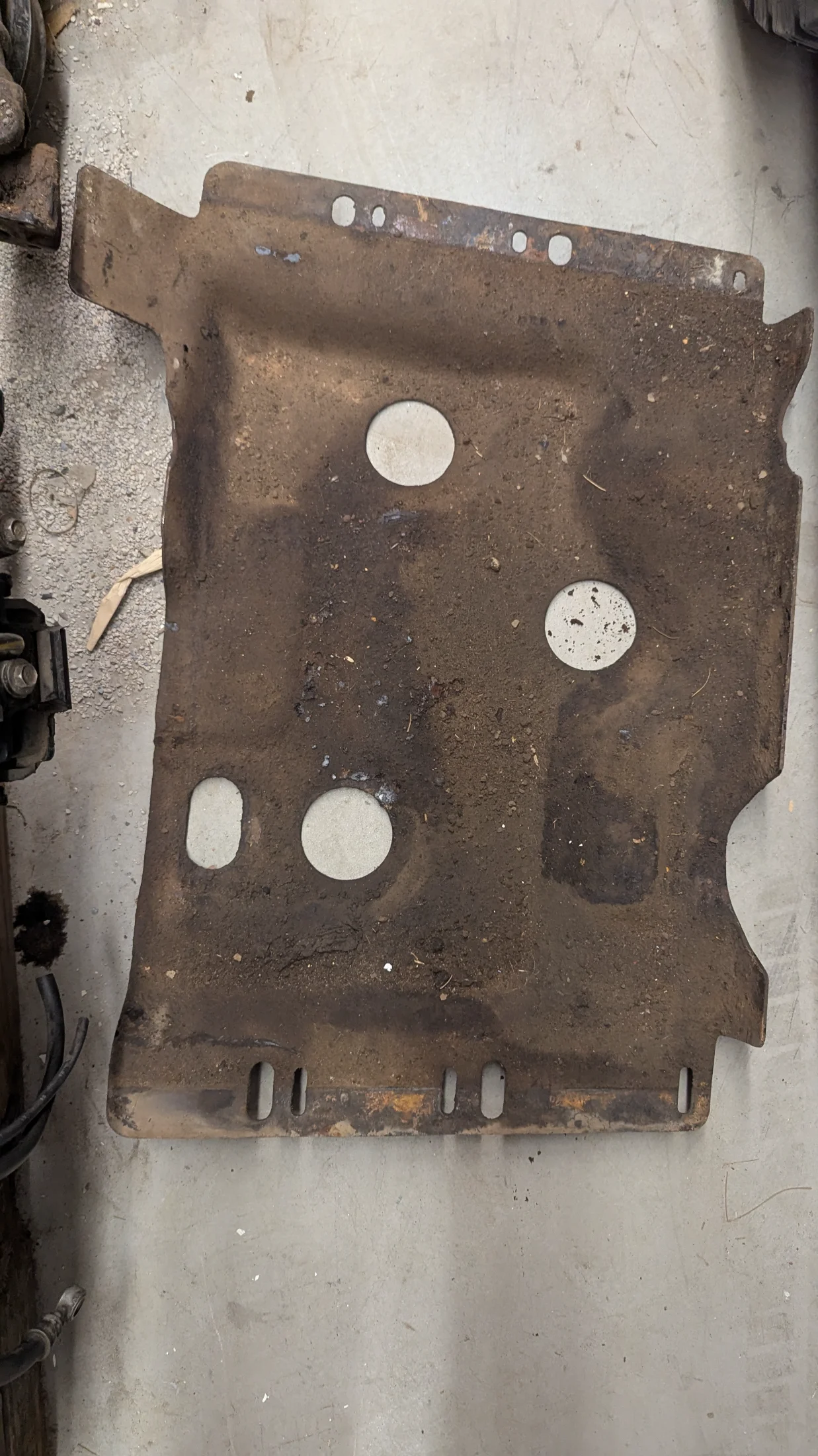

I have this skid plate that looks like yours
It's been trimmed a little in the front like yours. Have another lime yours that hasn't been trimmed. It's in a pile of six skid plates. There are two four speed pre 8/80 skid plates. One has the extra piece in the back other one doesn't. Other three are 8/80 and later.

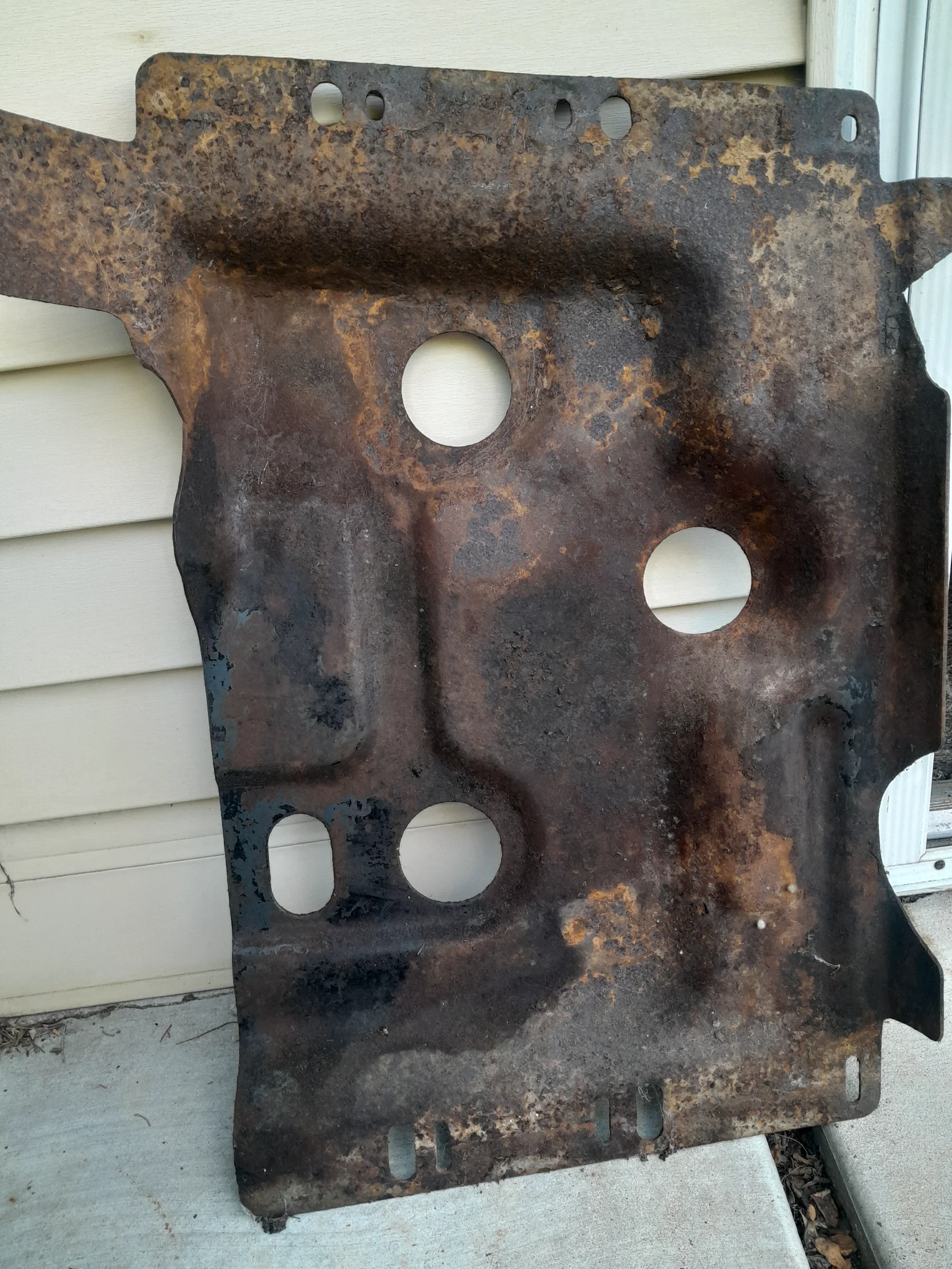

Believe this is the original one from my FJ40.
Can it has a couple extra holes drilled along the edge of each side. Can't remember for sure but believe I drilled back in 1994 when I added a four speed. It looks correct for the bash I did in November 2001 on an elk hunt.

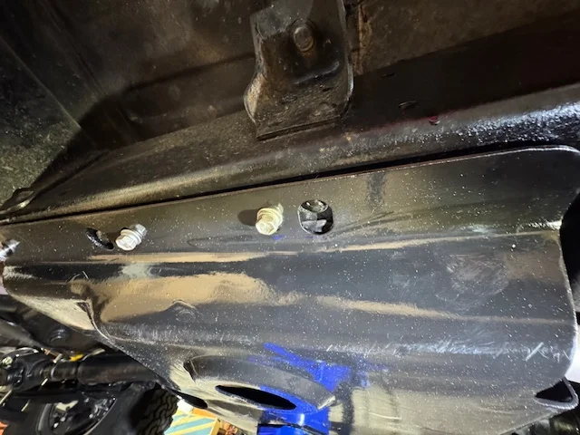

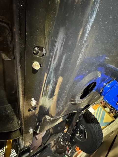

Well this adventure has concluded successfully…. @WarDamnEagle , your hole alignment trick coupled with the floor jack did the trick. Without having to support it on my back under the truck, the floor jack was like having it on a carousel and I could find the best set of holes to match up. Turns out it is the last set in the frame and uses 3 bolts each side. That 1” 90 degree lip lines up just behind the front of the u-joint and parking brake backing plate.
Yesterday, I could not fathom how this could be fitted without major trimming. The one I have is identical to the greasy one you show in the above photo this post. Thanks to all contributors. Makes things so much easier when it works !
