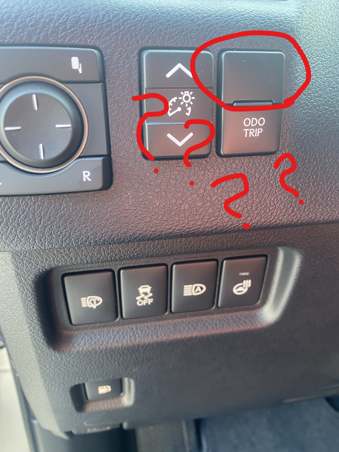

I am currently planning out a light bar installation for my new GX460, however, my vehicle does not have a blank small switch spot. I saw that I do have a blank spot above the odometer reset button but cannot find anything online similar to the blank. If any of you can help me determine if a switch exists as seen circled in the photo, that would be great. If something doesn't exist what are my other options.

Have you looked at any of the international Prado's or GX's? Maybe check the Canada manuals in our manual's sticky post. In the earlier models, Canada had options we couldn't get down here in the U.S.
If nothing else, stick a light or compressor switch there! 👍

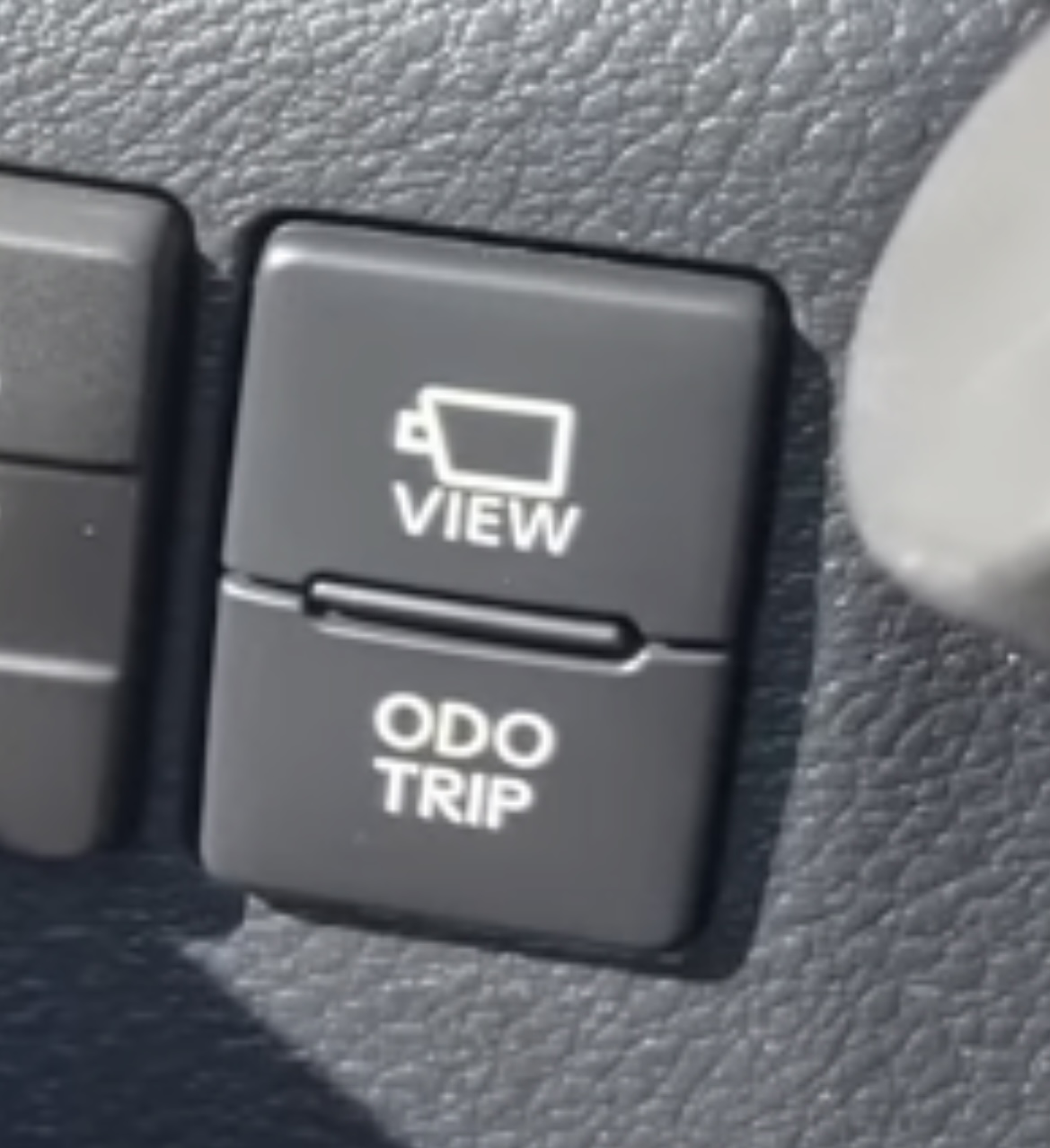

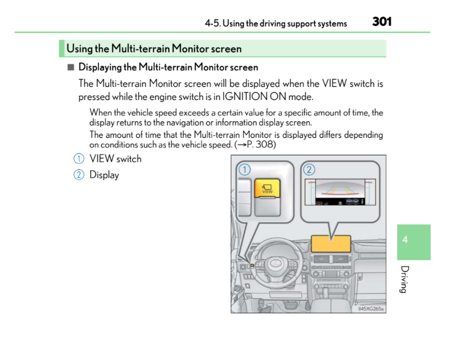

So, it's a view switch! I'll look around and see what comes up.

I’m in the same boat as you and that little view button might make a good switch.
Have you had any luck on finding a part number for this little thing? Or did you go a different route.

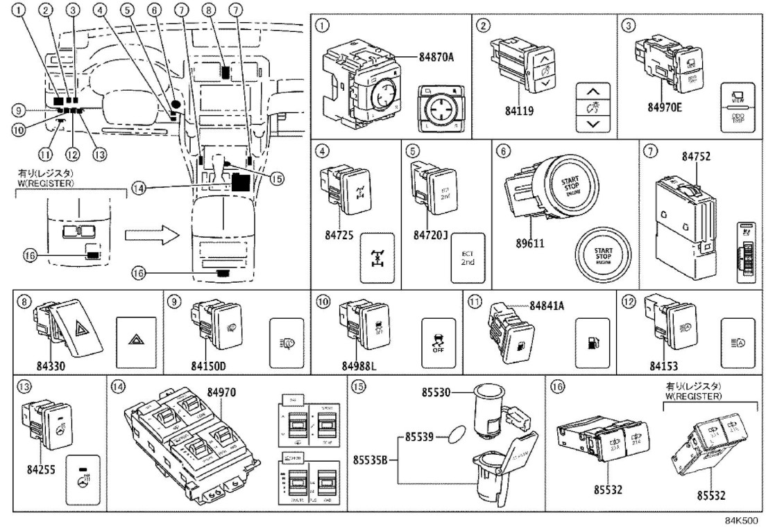

Curiosity got the better of me, so I did some digging. If anyone is interested here is what I found. Unfortunately I didn't copy the source link to these diagrams and now I can't find them. They are for the 2021 MY and show the switch with Multi Terrain View switch.

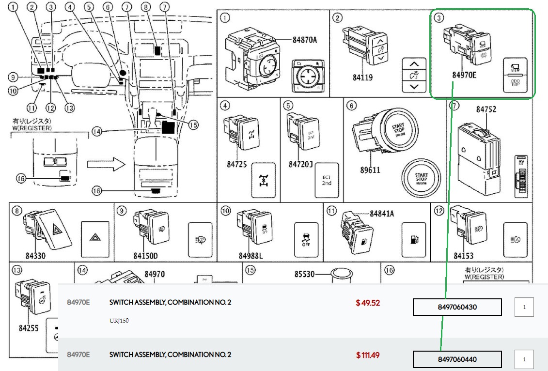

I was able to find what I believe to be the two switch PNs for item #3 84970E (w/ and w/ out the view button). They are pasted at the bottom of the second photo.
