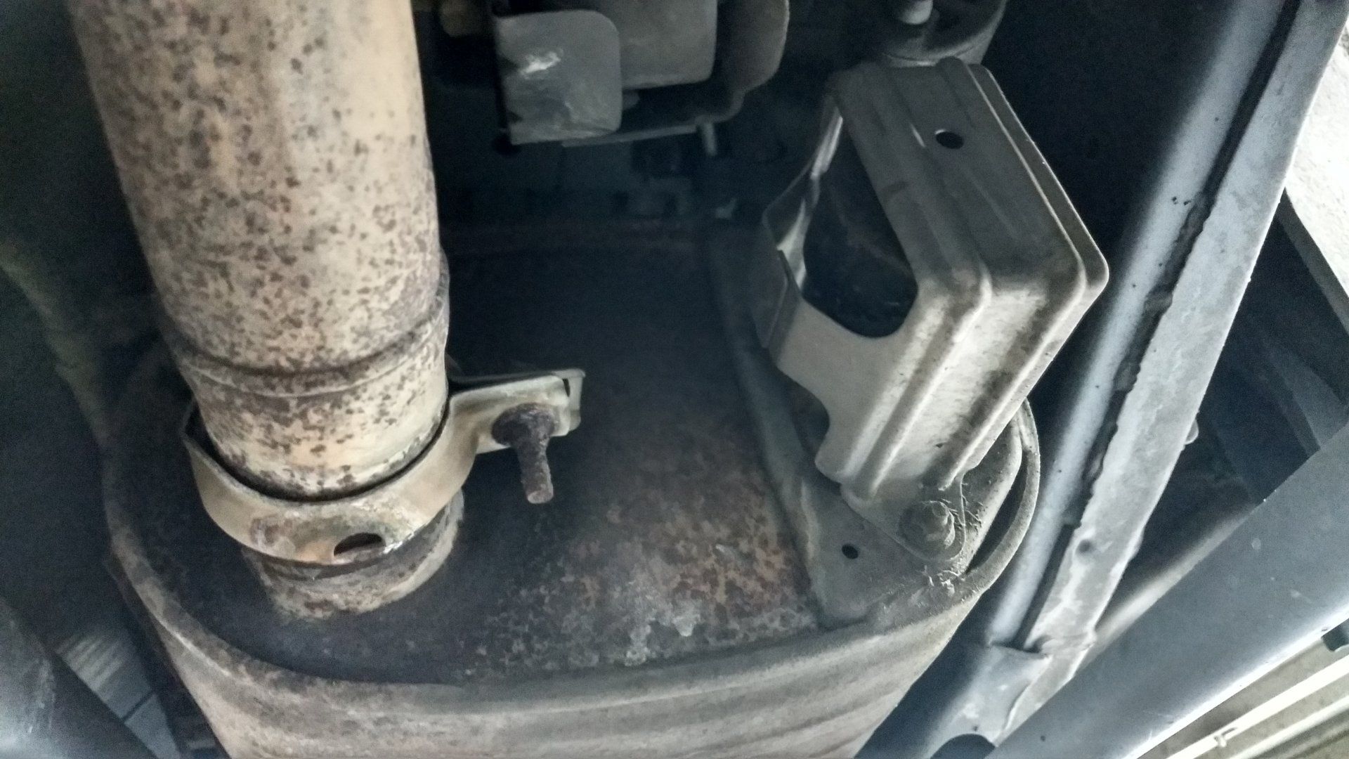

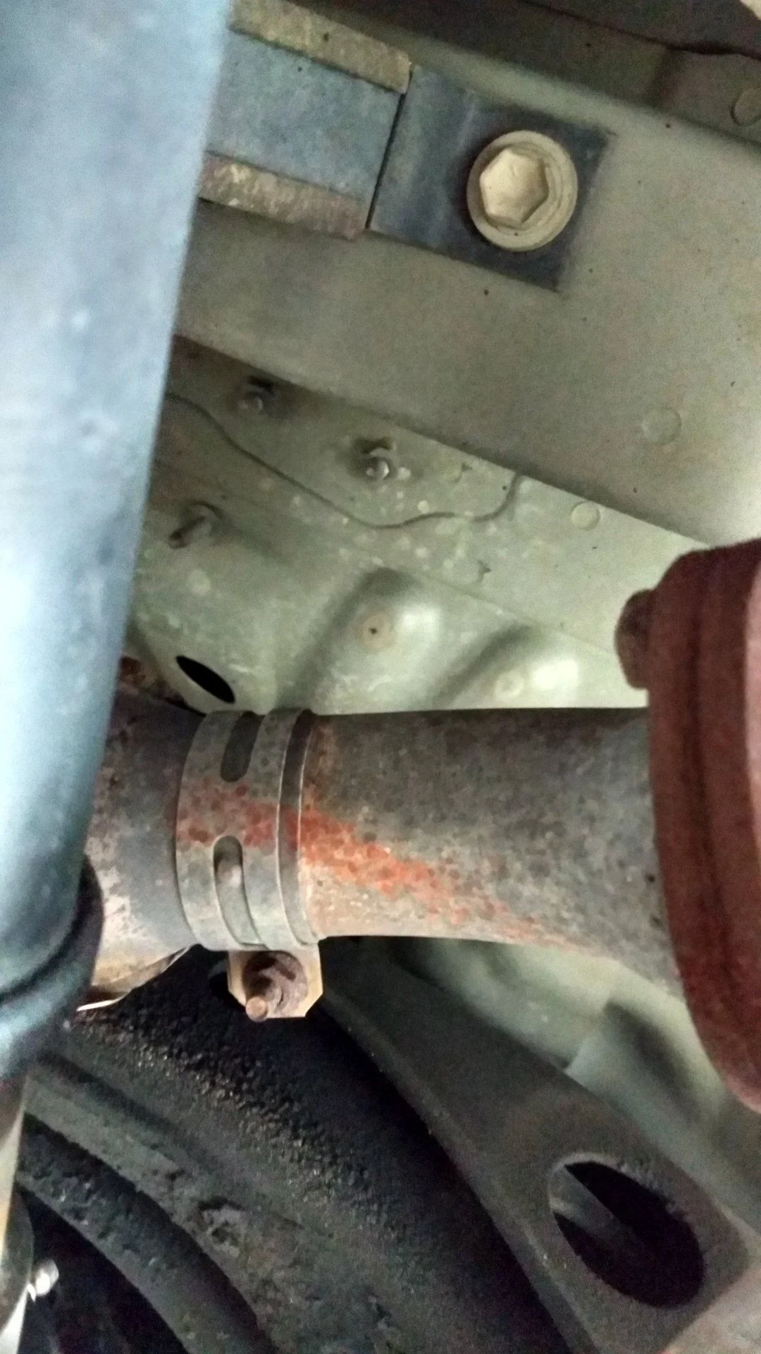

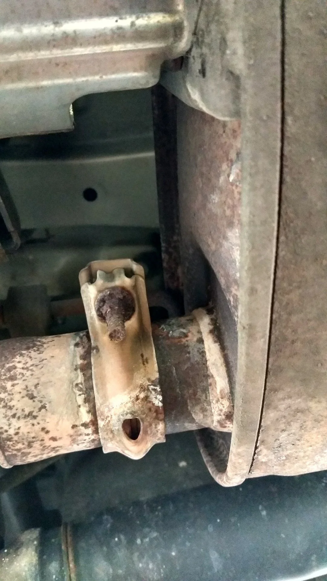

Thank you hickuptruck! I found one frame weight on the frame on driver side. I do not know how to check if it is good or not but it looks okay to me. I do not know what muffler weight looks like, I did not find anything similar near muffler. Here is a pic, not sure if that is a weight or damper.
One more puc
The exhaust weight is in the silver “cage” in your first pic. So that is apparently not your issue
