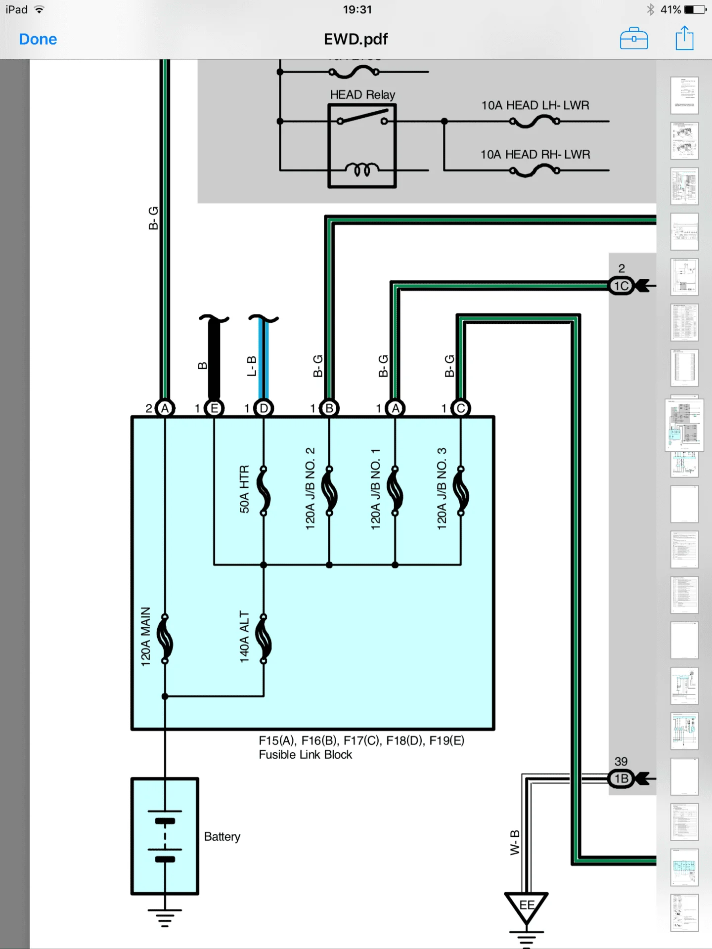

I bet someone didn't disconnect the battery when working on the alternator. The Alt fuse is inline with JB2 fuse and these power your shift lock.

What is the "jb2" fuse?
Sorry they are fusible links
I am pretty sure that is what mine looks like. Is that the part I should replace?
Mine is an 03, so should be same as your 2006. That is the exact part I used on mine (the one Julian listed). It should be obvious if you take the back off of the fuse if you need to replace or troubleshoot further.
You guys were correct, it was the fusible link. Thank you! You saved me a lot of trouble, I'm sure. I spoke to service techs at two Toyota dealers and they had no thoughts on what it may be. They had never heard of this before. One other question, I was able to remove all connectors to the fusible link, except the nut that attaches to the bolt post next to the positive terminal connector. Is there a trick to doing this?
