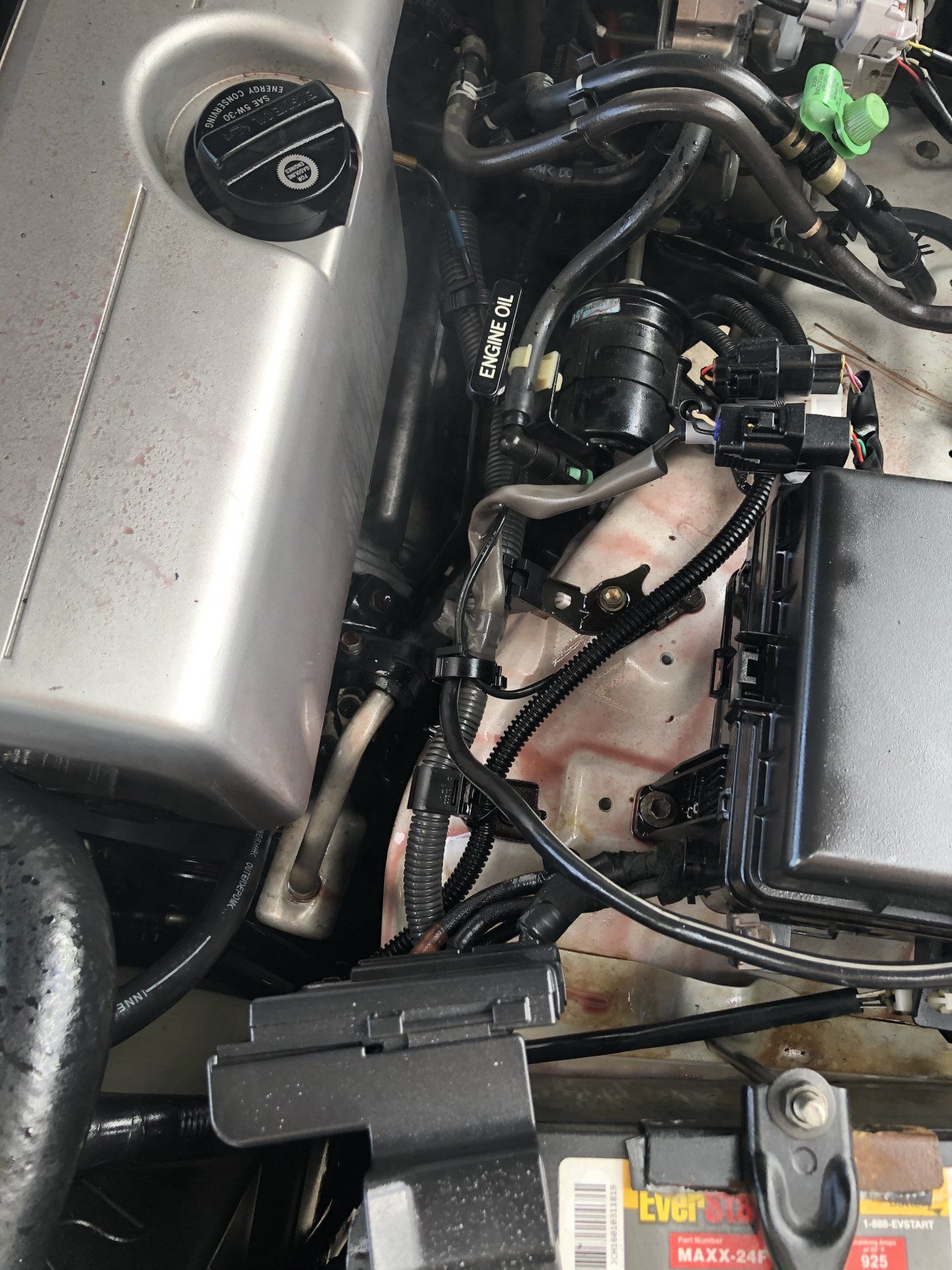

Help! Car just overheated and started smoking... red fluid all over engine compartment...
Jan 9, 2020
38
261
CO
I checked engine oil level, that looks good... what happened...?
Don’t drive! You have a bad coolant leak somewhere. Check radiator, radiator cap, upper and low rad hoses, heater Ts, oil cooler hoses, water pump, etc.
Tough to tell on my phone, and maybe I’m seeing things, but that fluid looks an awful lot like ATF rather than coolant. How old is your radiator?
well AAA on the way. I put on the gas out of a stop light and it didn’t respond well, I could decide if I was imagining it... then gave it some gas and little to no response. The engine temp light came on. Pulled over immediately, started smelling smoke, opened the hood and saw smoke come out. Car then proceeded to dump fluid all over the ground once I pulled over.
The odd thing is all of this happened right after I washed the back windshield, I walked back there and there is red fluid back there too....
I just took it in for a check up last week..... curious if something wasn’t put back together right.......
hoping this doesn’t end up being a major expense....

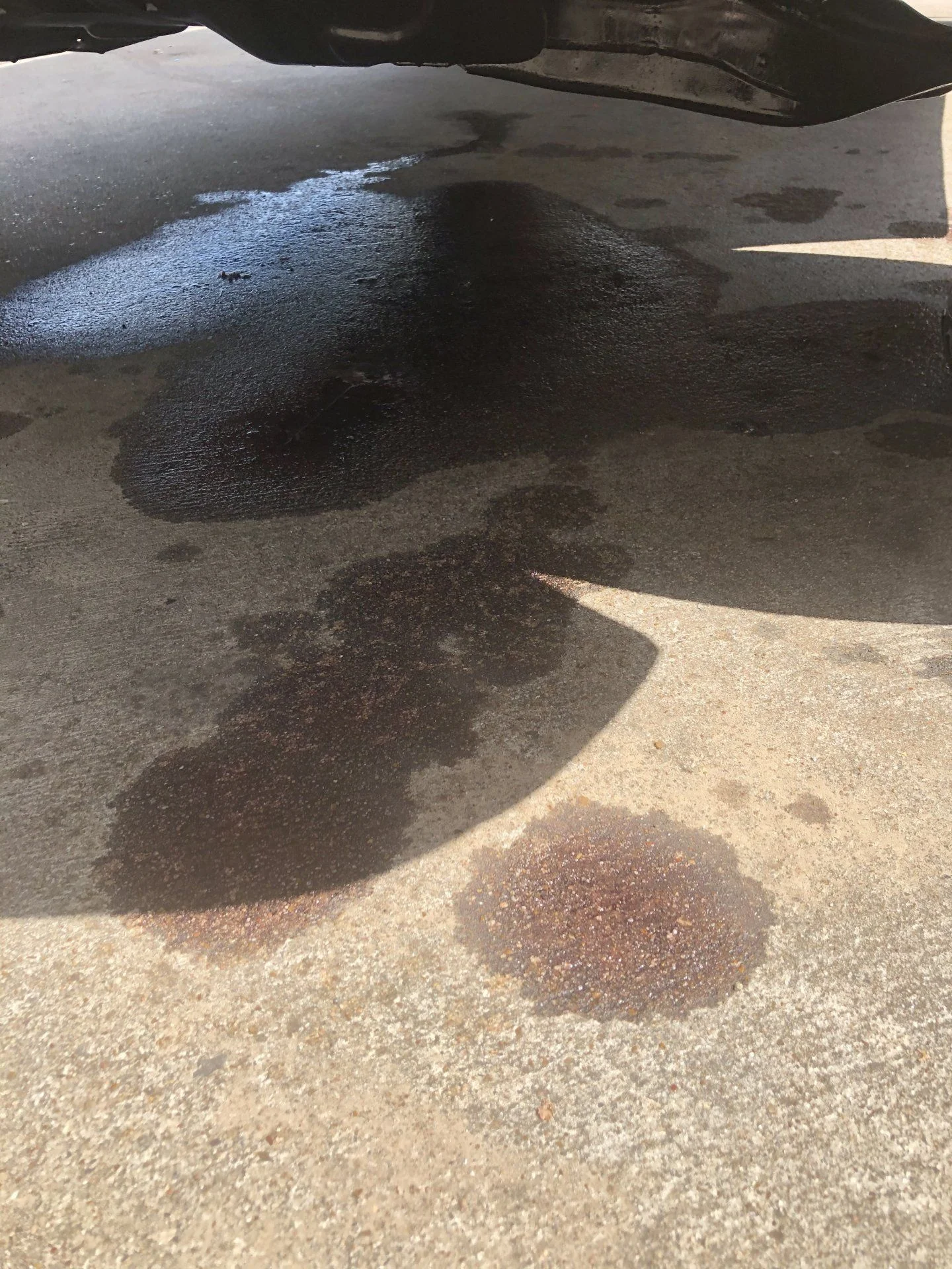

Does the fluid feel oily or watery?
just checked coolant levels. They are still at full. Looks like ATF then to me.
Now that I have some time to search mud as I wait for the tow, looks like that was the same problem someone else had
Looks like you either lost a trans cooler line or you lost a power steering line.
Then your cooling fan slung the ATF everywhere.
This happened to me yesterday, one of the high pressure steering line rubbed against something and put a hole in it, spraying ATF everywhere
Yours look like it's from a transmission line, but that wouldn't be slinging like that unless shet hits the fan.

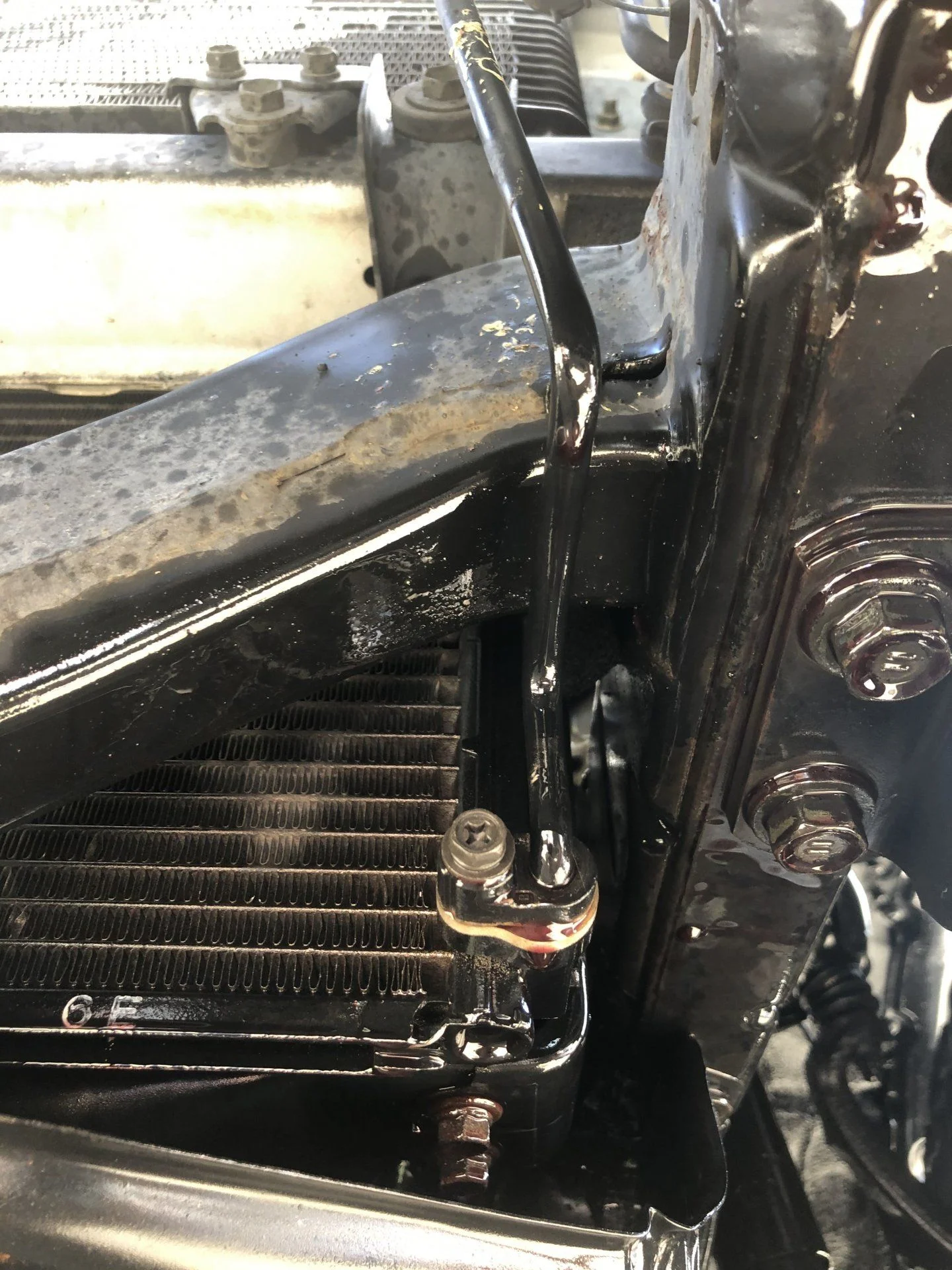

Follow the transmission oil cooler (in front of the radiator) and it's coolant lines that lead to the transmission.

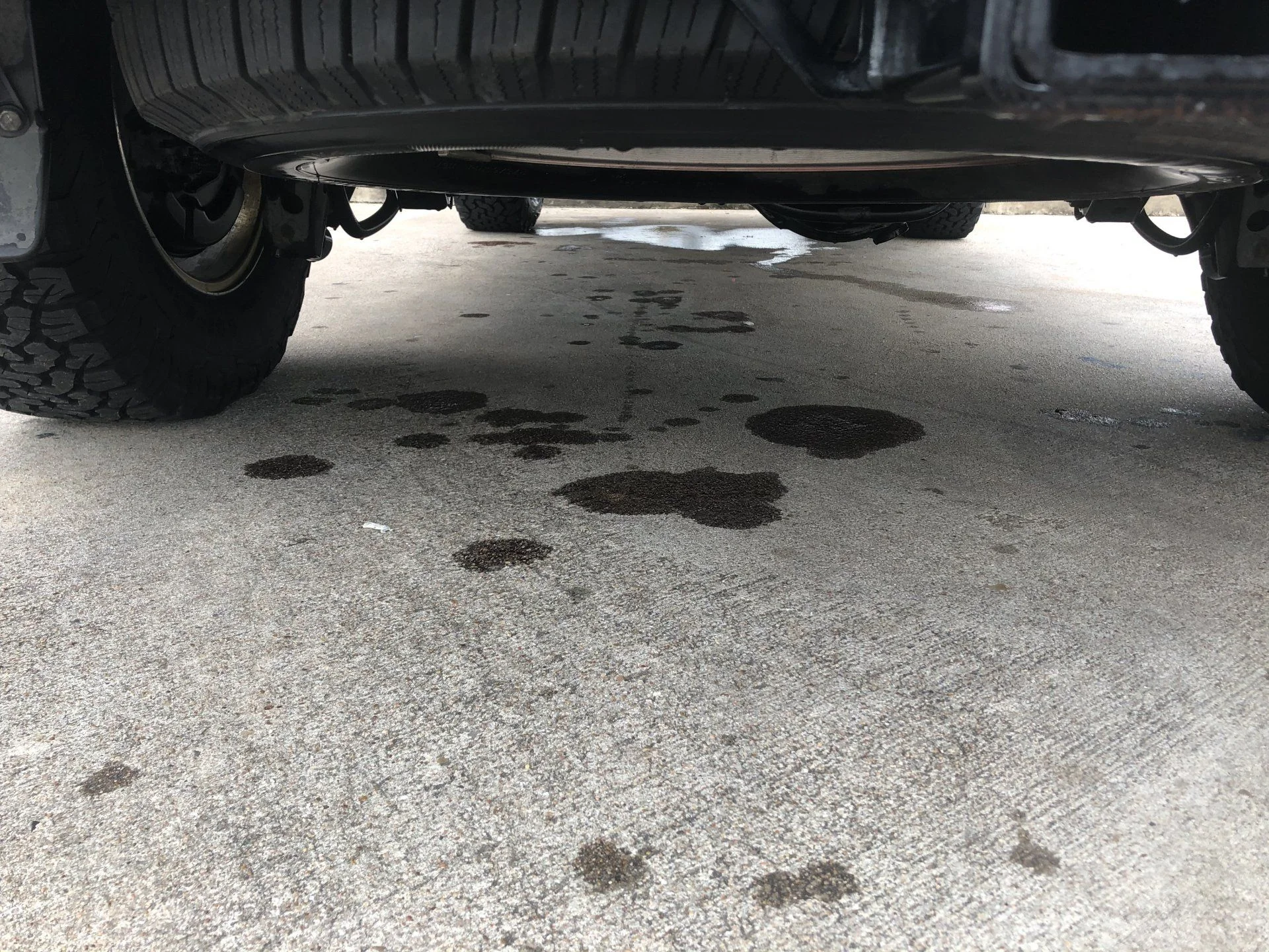

Edited to also add picture of the leak at the rear and the red fluid that somehow came out of my windshield washer despenser
Could be it...
leak at the very front of the car and see a leak at the base of that line
