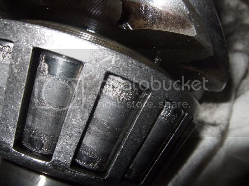

BTW it sounds like your pinion bearing may already look like the one above, you might try retorquing it, but I would look to get a replacement asap.
alrighty
yea, by the sound of my rear, the bearings look worse than that.
