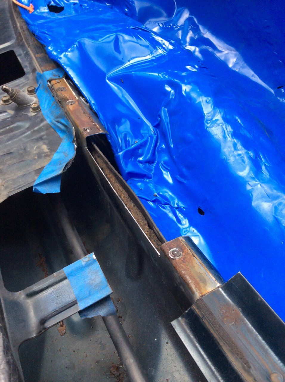

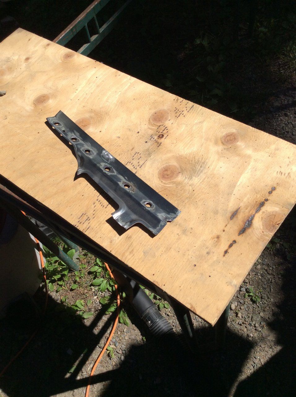

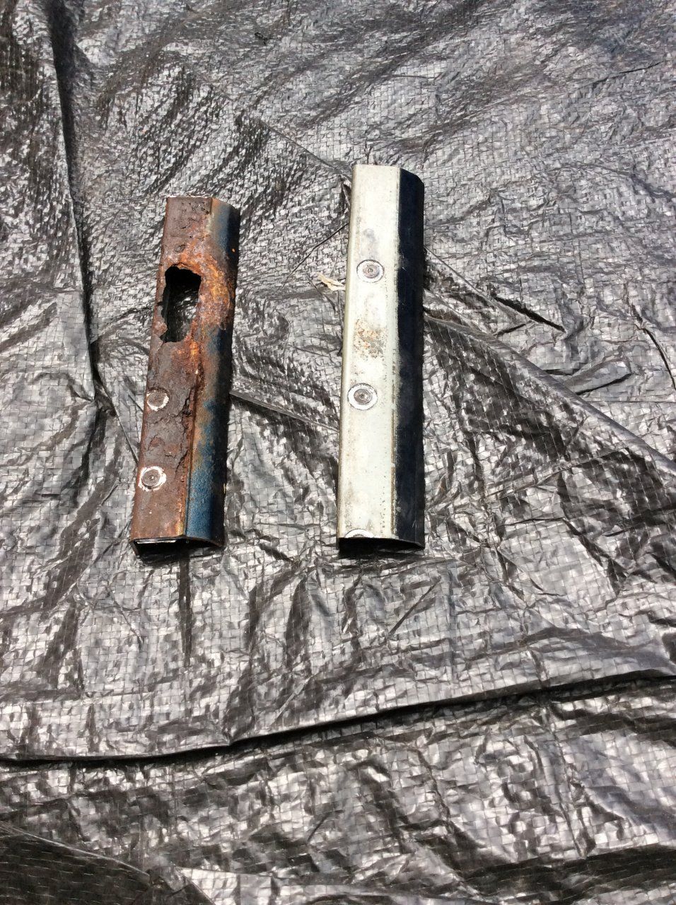

Did mine myself last year after getting a call from the glass shop as well. I was lucky enough that a friend was parting out an HDJ81 that I was able to scavenge parts from. My rust was pretty bad though.

I have some nasty rust issues on the front window and the proper fix is the same as what canman did.....section the rust off and weld a new piece. For me it's on the upper side, do its a bit of a pain and not too cheap to fix.

Yeah, that was ugly :crybaby::(
Hope yours is nowhere near as bad, because your winters are nowhere near as bad.
Good save, canman!
Heh.... If ya think that looks bad, you ain't seen s***...
My 44runner was hella worse... Like, required welding worse.... :)
Mine looked like that when I got a call from the glass shop, I was lucky enough to get it fixed by my local mechanic

Looks like welding to me...
But maybe you welded in an entire new windshield surround?;)
