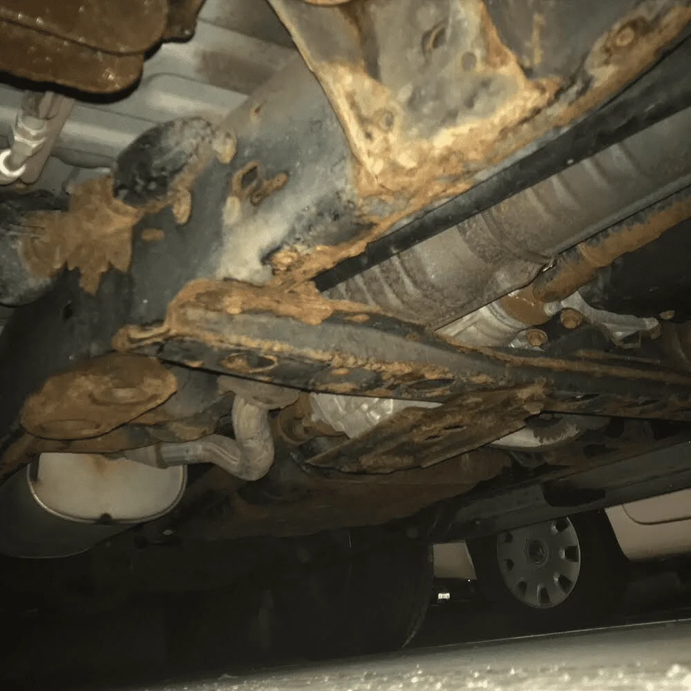

Hi,
I’m looking for an original as possible FJ100 or 80 as a DD, surf wagon and for some camping with the wife. Had a 95 FJ80 15 years ago, probably should have never sold it. Question is, I’m in San Diego and interested in a truck in LA (2001 470), but don’t want to make the trip if the rust on this thing is too bad. Truck spent its entire life in the Midwest and north east. Owner sent one pic, but I can’t tell if it’s no big deal and worth a look or if I should just keep looking for a Socal truck with less or no rust? It’s low miles, clean and seems fairly priced, best I can tell. Again, being from here rust is far from my specialty
Thanks for the help, appreciate any advice?
That's no good. Hard pass on that.
Definitely keep looking. What are they asking for it? That’s not a California truck, unless it’s been regularly run IN salt water and never rinsed.
I honestly think it's not that bad, but I'm from the Netherlands, we have a lot of road salt.
The floor board in the picture seems clean, only some pieces on the frame have rust.
And that rust probably has not penetrated deeply.
I think that if you used a needle scaler of some sort and a brush + rust protection (I hear POR15 a lot on ih8mud) you could be finished in a day, or two.
But definitely don't pay top money for it, it must be cheap.
You will never turn a bolt on that truck without hating yourself for buying it. Get used to learning (or using) all the tricks for getting broken bolts out if you buy that one.
Pass. There are rust free examples for
Sale all the time. If you do your own work, it is so much nicer to be confident that your bolts will back right out. So many jobs are 20X harder with rusty bolts.
Also - the bottom of the driveshaft is rusty, but not the top. Which, to me, means it sat somewhere not moving for long enough for that to rust on the bottom, only. If it sat that long, the tires are probably flat-spotted.
It is not the worse, but I will stay away as much as possible and look for a rust free rig, just so much easier to work on rust free clean vehicle.
Yeah, that looked like a red flag to me too, but I had to double check with you guys. Thx.
