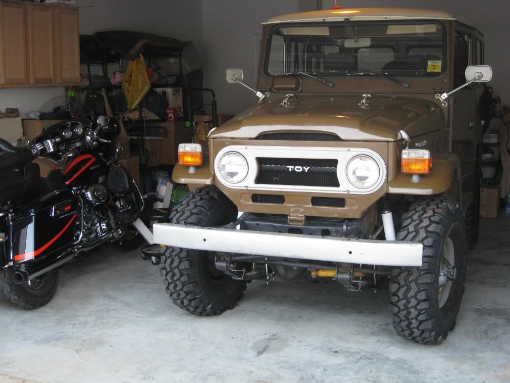

LTB's installed...AWESOME
Got them today they are s*** on the road, but bad ass...I will try to take it on some trails this weekend and see where I am going to rub...stock shackles still.
FYI, 4" Hell Creek, stock shackle = scrub fiberglass top on 40...just enough to knock the dirt off.

Teaser pic of new LTB's installed
Hi All,
Here is a pic of the LTB's installed.
Brad
Those tires will get a bit better with age. I hated them at first, but once you get some miles on them, they will soften up and round out. I love those tires and would have bought a set if they made them in a size 35.
I'm curious to see the clearance in the rear wheel wells. And how about some pics in the dirt rather the garage! ;)
Also, don't expect those tires to change shape much when airing down. The sidewalls are HARD. I regularly run below 10 psi and there is no change in shape.
Edit: Just noticed in your last pic that you're Ubolts are hanging down below your skid plates. Sort of defeats the purpose of the skids. Do you still need to disassemble for shims?
