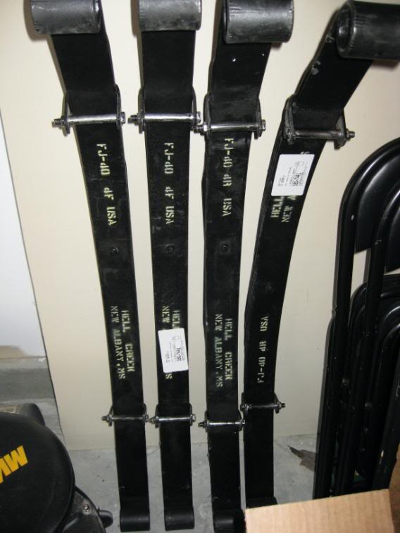

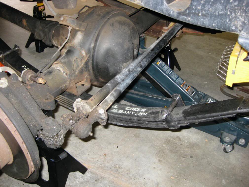

Better pic of the springs

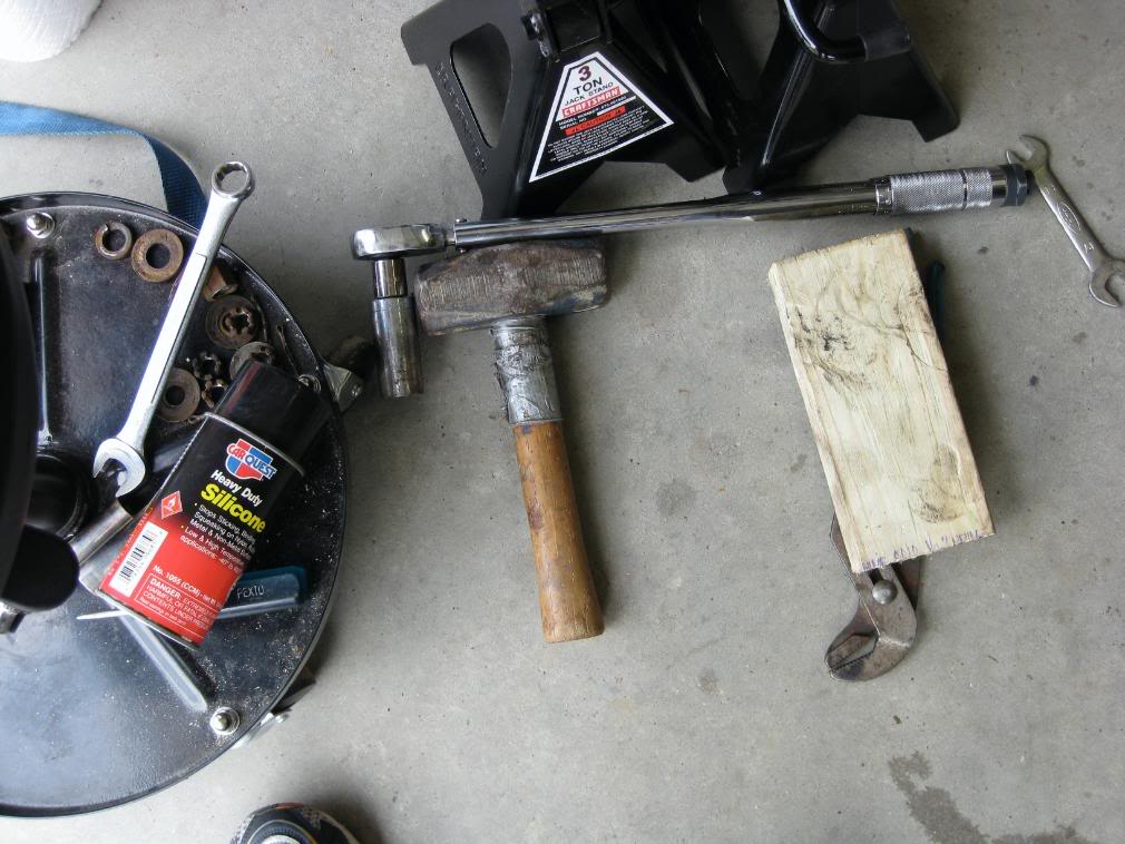

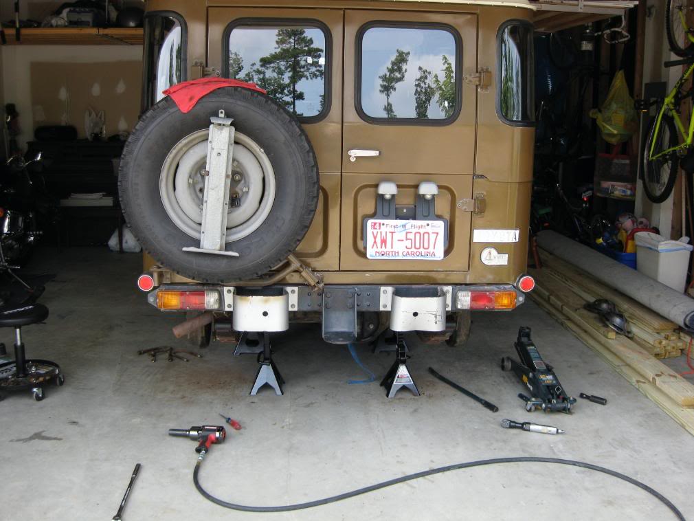

In friends garage getting ready to install lift.

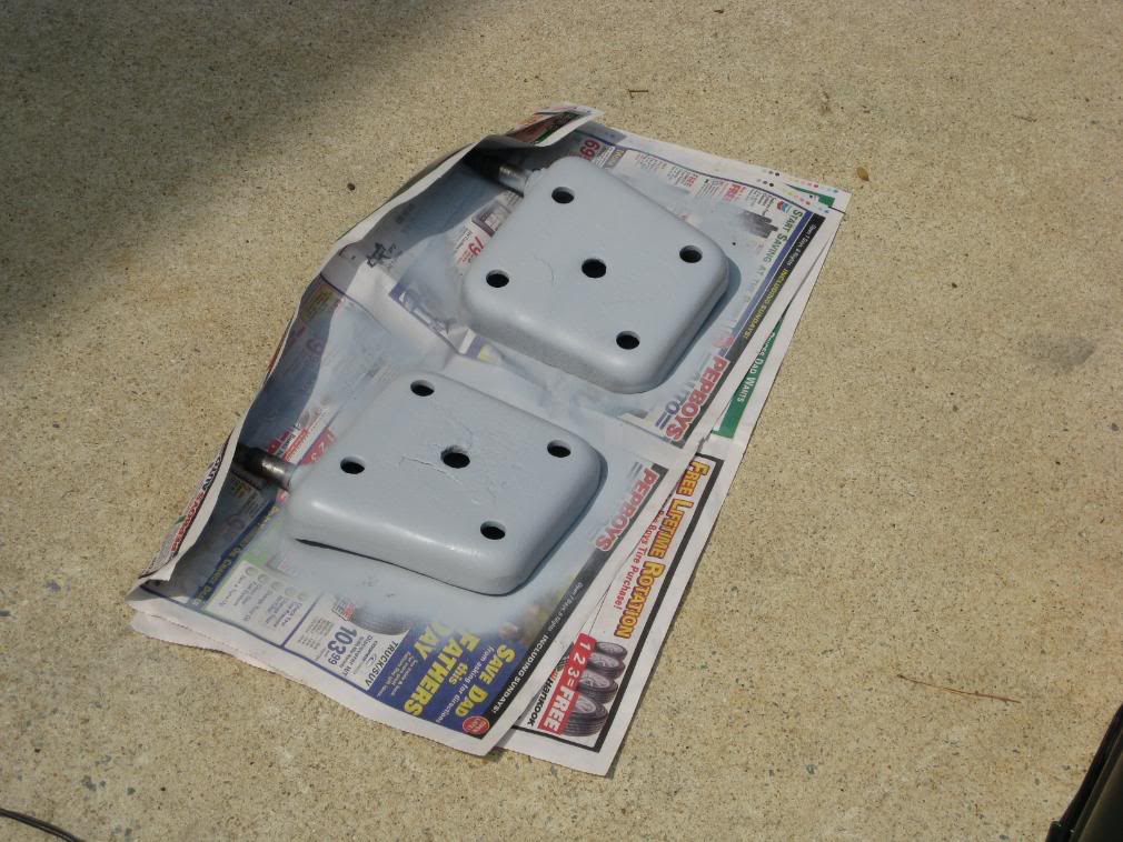

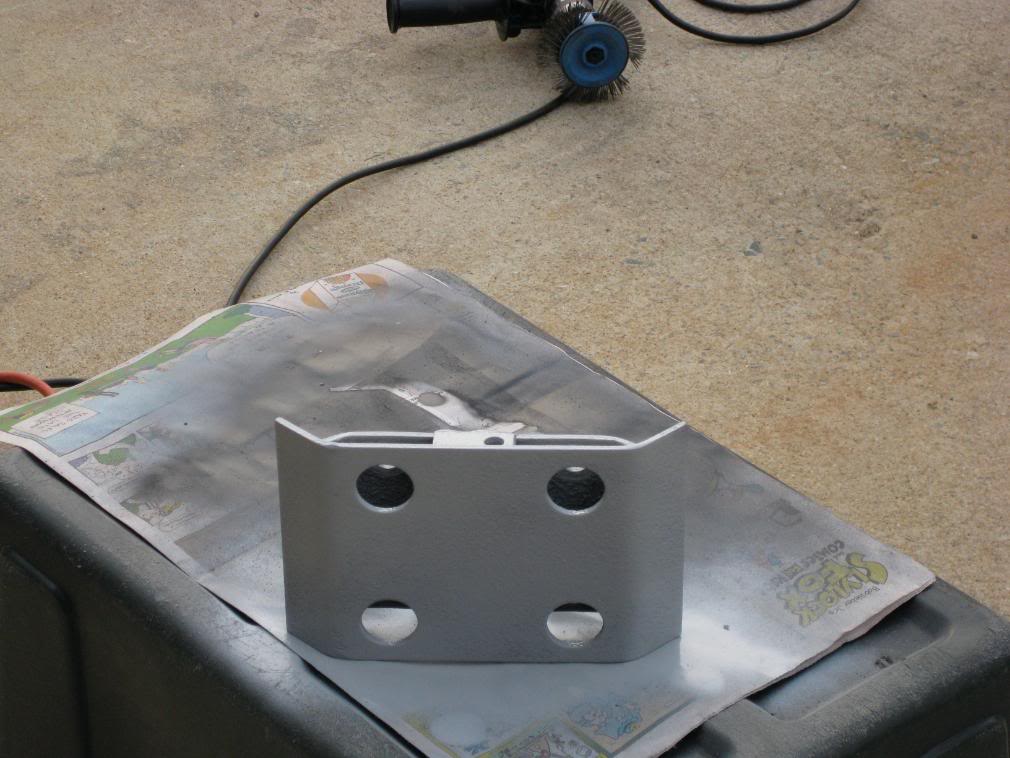

Sanded and painted the old skid plates
Need to replace the stabilizer and do some general cleanup.

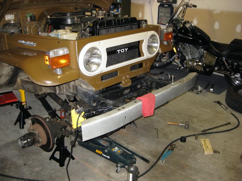

Almost finished with the front
Front springs complete, just need to add the shocks.

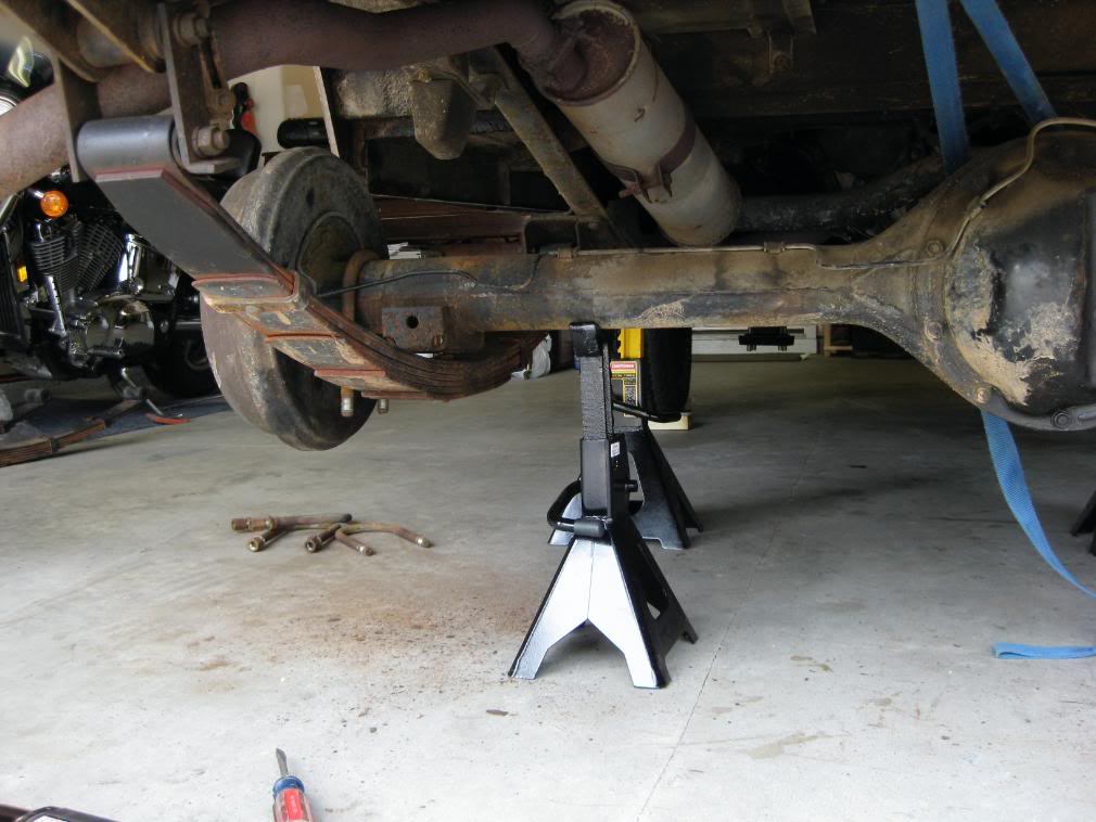

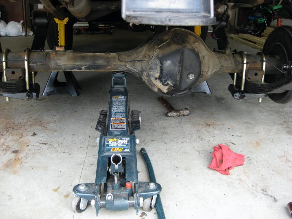

starting on the back now.
Prime and paint rear plates
Tie off pumpkin so it does not twist to much
The help with a wierd look on his face! [he might be tired at this point]. :flipoff2:
Both springs on the rear now, just need to add shocks.

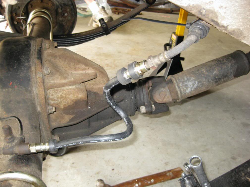

Funny looking brake line :D [Something similar but just as funny on the front...ordering some this week to replace these.

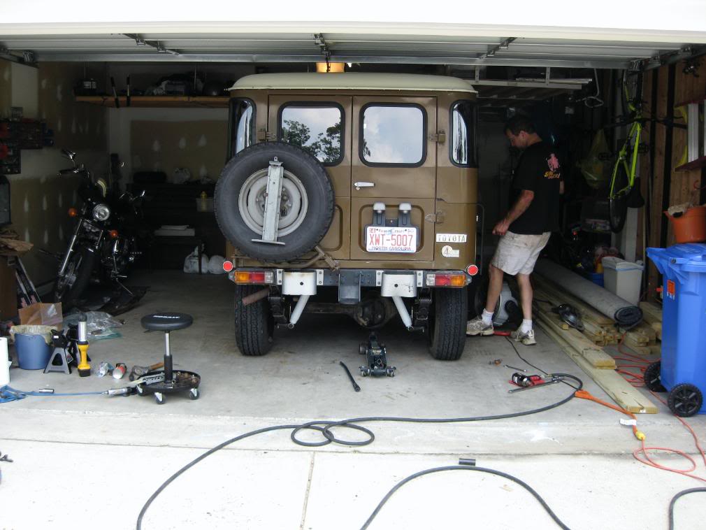

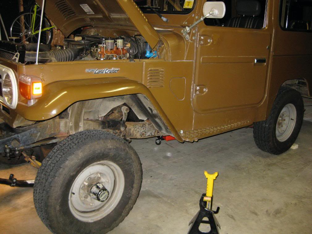

Finished! about 8 working hours with a few minor problems.
Not much room to come out of the garage

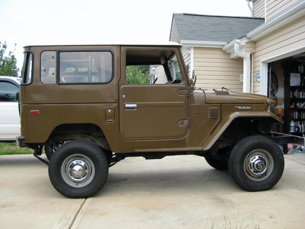

Outside for a pic with the little 235's on it . They will be coming off this week adn be replaced with the 34x10.50x15 LTB's.
