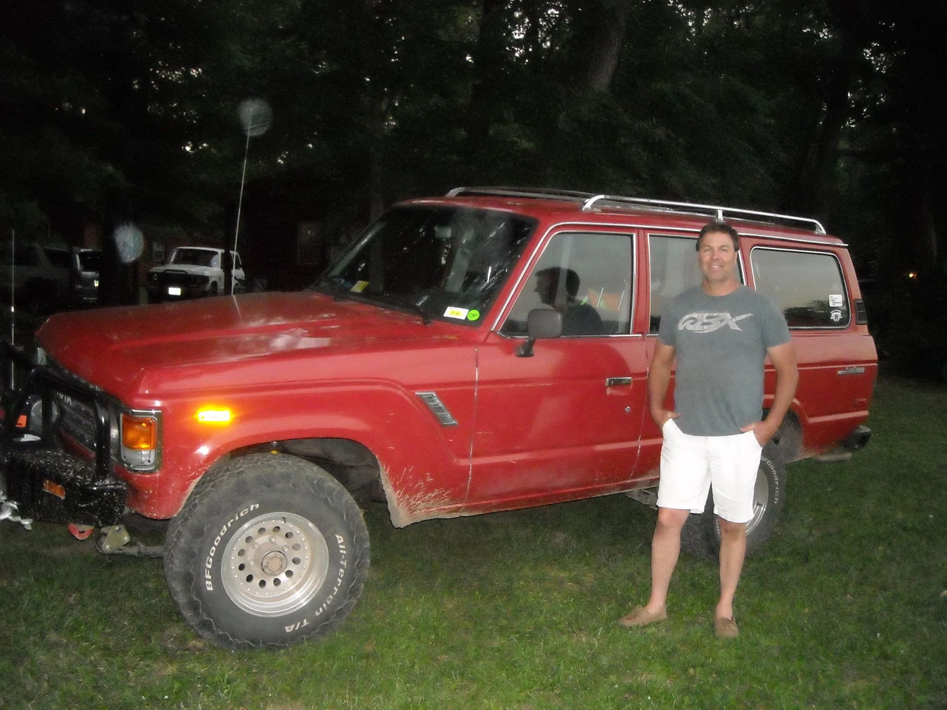

Nah imho not too small pic here are ..31x10.5x15s bfg ko2 on 2 1/2 ome heavy lift :
