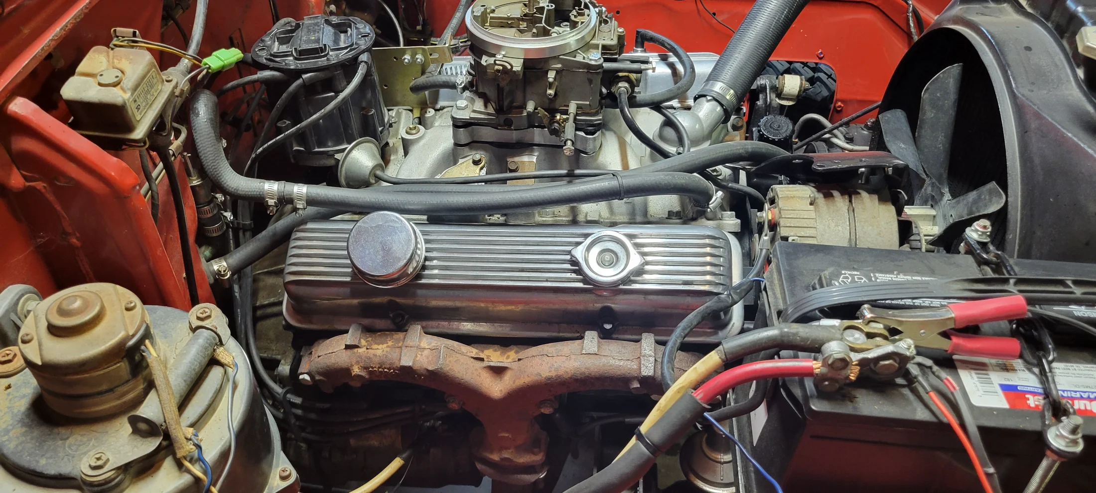

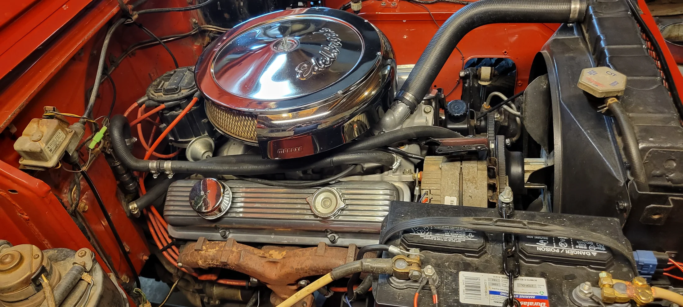

Hi All, ive tried combing through the numerous 350 motor swap posts with little luck. I am hoping someone can give me a bit of guidance regarding the routing of the heater hoses from the top of the heater valve and the small brass 90 degree fitting below. I purchased my FJ like this and would like to route it correctly for heat this fall. Pics attached for reference.
I used fittings for 5/8 hoses. It looks like they didn't leave you much room between the firewall and the valve cover. Do you have any cooling problems?
It appears someone put pipe plugs in the heater hose ports. I'm glad to help. Anytime

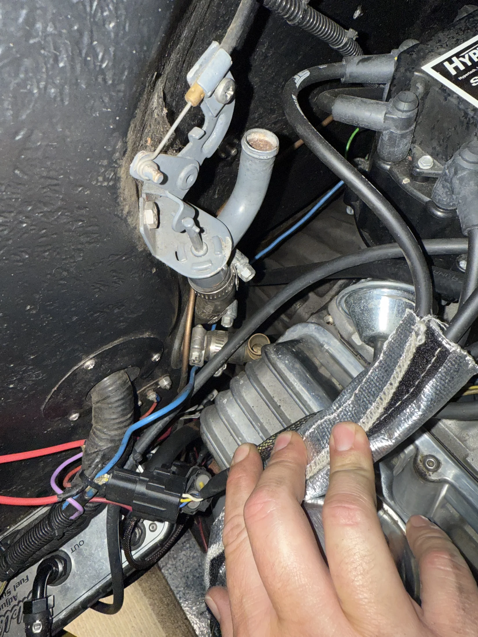

Best picture I could find of how I handled mine.
This was from 2015 when I switched over to EFI. Original '73 had the manual valve and not a cable actuated valve. I originally found a cable valve at Pick A Part off a GM vehicle I believe. It had been on the vehicle since I swapped over to the SBC in the mid '80's. If finally rusted up so I found this plastic version to avoid the rust issue. The cable I used to activate it was the choke cable which was no longer need when I did the original conversion. You may also note that I continued to use the factory hose bracket that was mounted to the passenger inner fender.
