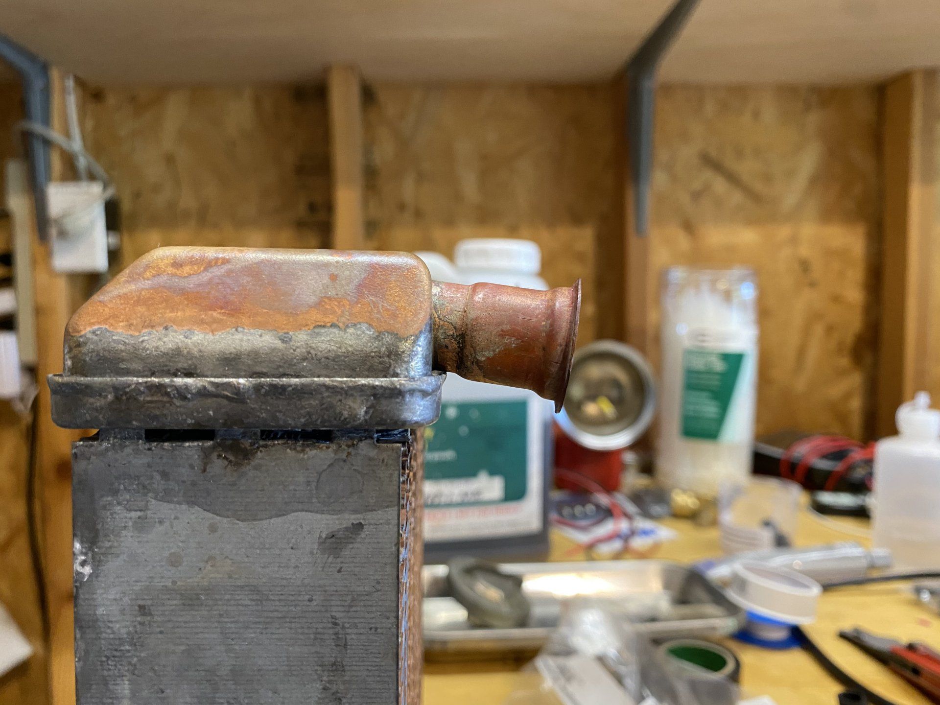

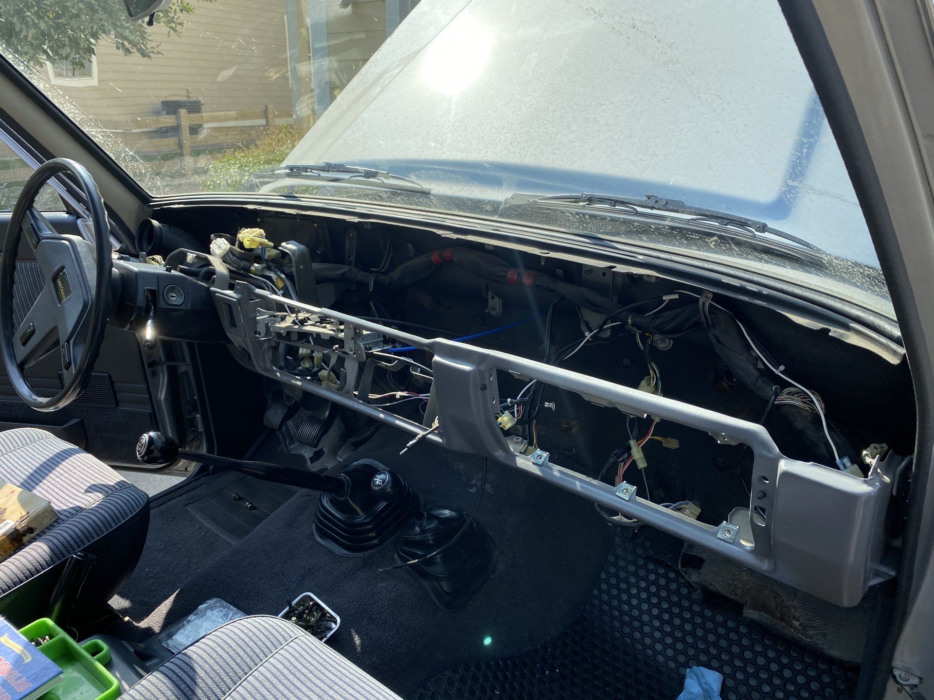

I finally got to my heater core job today. Not too bad if you remove everything. Here I am ready to install my replacement core from SOR and one of the inlets is at an angle! Frustrating.
None of local parts shops have them, but I might have luck looking for another Toyota that shares that part. The pickup or others???

Is the 'angle' just a bend (damage) or by design?
Quick update. I really wanted to just get this job done so I used some heat to bend the heater core ports into the correct position. I installed a tight fitting socket into the port so that I could put some force into it without distorting the metal. It's very soft. The heater core is installed now and there are no leaks so far.
To answer the above question, no, the angle was not bey design and it wasn't even close to working. Those o-ring seals are probably my least favorite piece of Toyota engineering and it leaves very little tolerance for misalignment. The heater core from SOR was pretty rough looking overall, but I'm guessing there's only one manufacturer making these anymore. I'm keeping my old one just I case it makes more sense to repair it down the road.
I didn't there were any new FJ60/2 heater cores being made by anyone. I agree that those copper tubes are about as bend resistant as overcooked gluten-free pasta.
