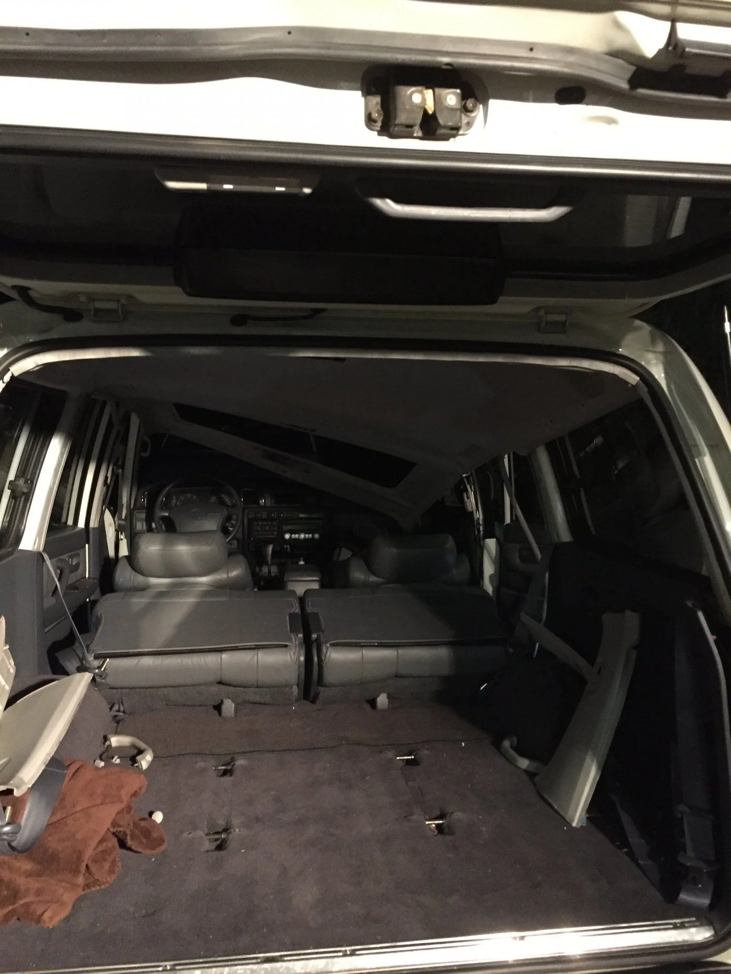

Found small specks of rust around the nutserts when I removed the factory rack this afternoon. This all came about by me removing my tail fin because it interfered with loading the kayak (Jackson Big Tuna) on the factory rack I noticed slight rust. around the nutserts.
The nutserts did not spin but they spun when I tried drilling them out. Gonna take a grinder to them in the morning and I am gonna have my brother-in-law weld the holes up.
The headliner was not a headache to remove at all, just took some time. The one piece unit was nice and easy to remove. Going to lightly clean it and shoot it some with frebreeze before I pick up some reflectix and put everything back together.
Most time consuming of it all is getting all the hardware out. Looking forward to getting this knocked off the bucket list. Crappy iphone pictures to come.

We decided to just pull the nutserts out. If you put a bolt in there and a vise grip you can wiggle them loose.
Then you make small rectangular pieces of steel that you put in the hole. Weld a big pointy piece on the small rectangular pieces so you can hold it in there. You then flatten the steel of your roof around the hole (it bends a little outward because you pull the nutsert out). Then you take a TIG welder and weld the holes. Then you can break the big piece off the small rectangular plate. A MIG welder makes to much sparks and is very dangerous for your headliner to catch fire! Welding with the TIG didn't make any spark. Just don't weld too long in one time, just for the heat.

The welds look horrific. Ha ha. But I think it is adequate.
I am getting ready to grind them down a bit and primer it. Only had a small fire and a couple of sparks that fell on the carpet. I forgot my moving blankets at home and already got to the my brother in laws.
I dropped the rear 5 bolts of the sunroof to access the front holes with my slag catch can. We took a piece of rubber weatherstrip around the top of a cut down coffee can with a bit of water to catch the Sparks.
I kept asking if the welder was set too hot....
Some of the insulation I peeled back did catch fire so beware to all those who attempt to weld without dropping headliner and remove the insulation.
