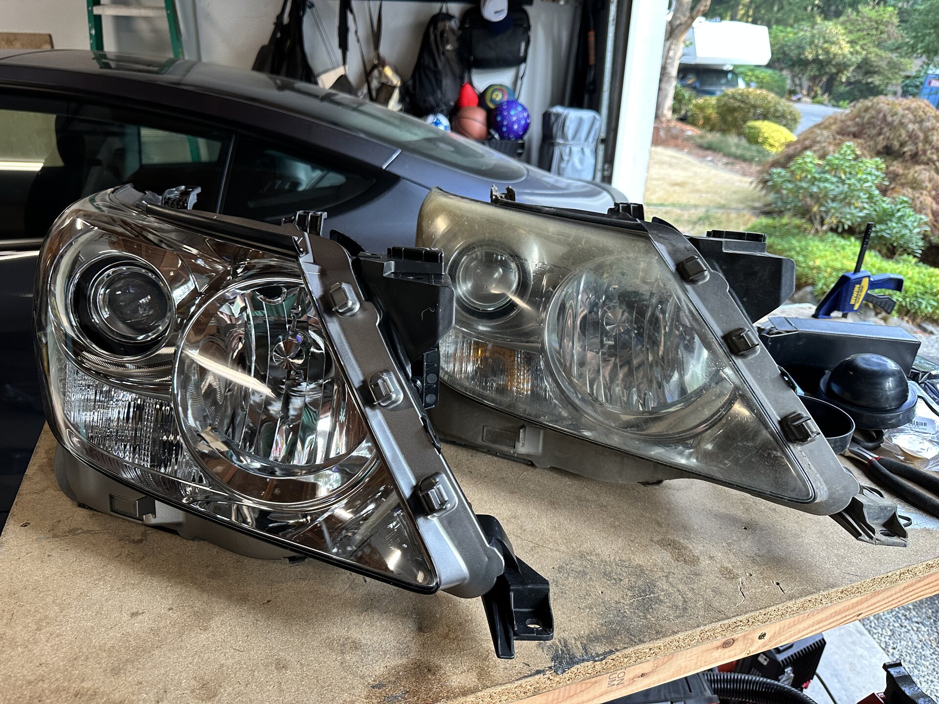

Coming from the LC side of things, I would have to polish and seal my headlights every year or so… but I could never reach all the micro cracks inside the the lens. I just replaced my lenses and should have done it long ago. The difference is massive. Vote for buy one , cry once… if you can swing that. Nothing wrong with polishing though
Did you have to pull the front bumper cover off to replace them?
Sorry another question. Did you apply anything to the new lenses to keep them from fading?
Yes you have to pull the bumper cover. The bottom bolts are under the bumper cover.
I put some opti-seal on them. It won’t hold up but I’ve got some time. It’s still gray here in the PNW. Might get some xpel or something.
