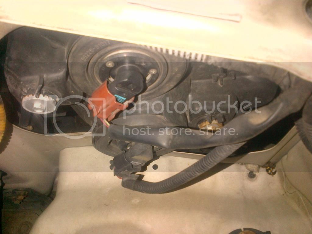

I have a 2000 LC and need to adjust the low beams. They are way too low and it's unsafe. There are two bolts on the back of my light housing. Is one of them for the vertical adjustment of the low beams? If so, what direction do I turn the bolt for up? For down?
BTW, this is the passenger side light.

Both are bolts. Neither takes a philips.
Or are you saying forget those two bolts and adjust the whole light housing?
Is there no DIY on the board?
Socket, top one is height. Lower is side to side. DOT states for every 25ft, they need to have a 2.5" drop. Turn slowly, the plastic uniballs/adjuster threads can get brittle over time.
There is a 8mm head, but I'd go nuts doing it that way. So I use Phillips as you can stand outside along the fender and watch what you're doing.
Others may do it another way.
