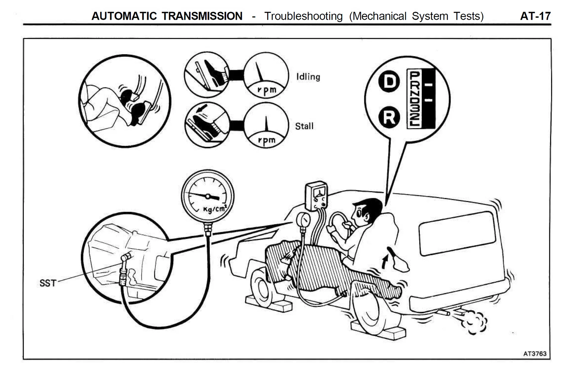

Hi guys was wondering if you can put a transmission temperature gauge sensor in the transmission test port using some sort of an adapter?
anyone know where the test port location is and what thread it is?
I had the end of my cooler Union tapped for the sender. Either are easily achieved
old thread but I did the same as you just TEE in to the output line but wondering why no one uses the test port to check pressures on the A442F and put a temp sensor in its place. looks like the port is on the side of the shift linkage
