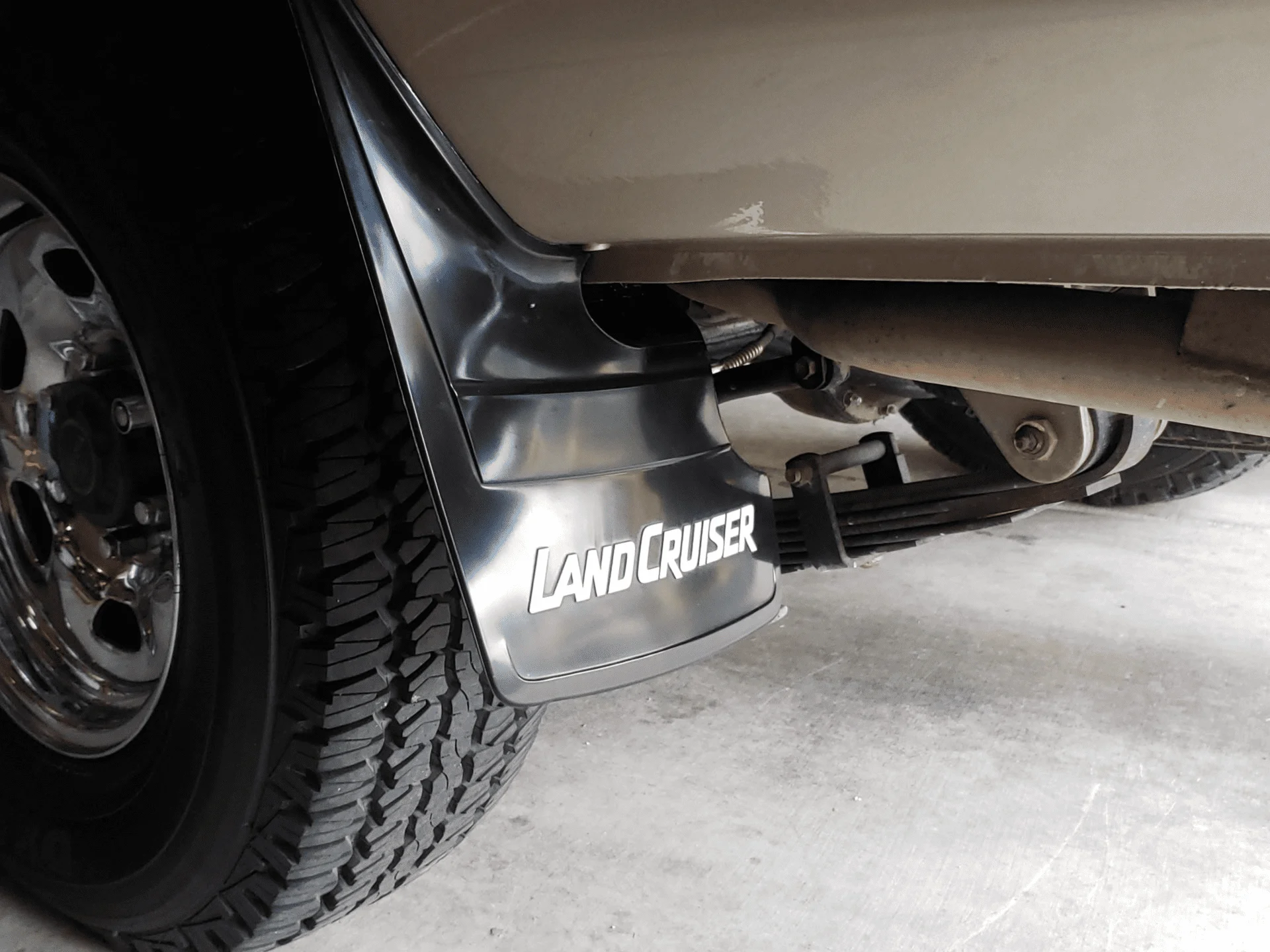

The pen looks like a pretty good product. I didn't know of this when I restored mine last year. I did use an ad hoc version of the same with a piece of high density foam and FLAT white enamel...and a lot of patience. Builds - Sentimental Restoration of Family 1990 FJ62
FWIW, I also coated the metal inside surface with black Flex Seal after cutting out the old and prepping the surface which required sanding out some corrosion. Upon installing back on the vehicle I did a fresh bead of the black silicon caulk (RTV) used from the factory in the channel where the flap snugs to the wheel well/fender metal.
x2 on the white paint pen from art store and patience.

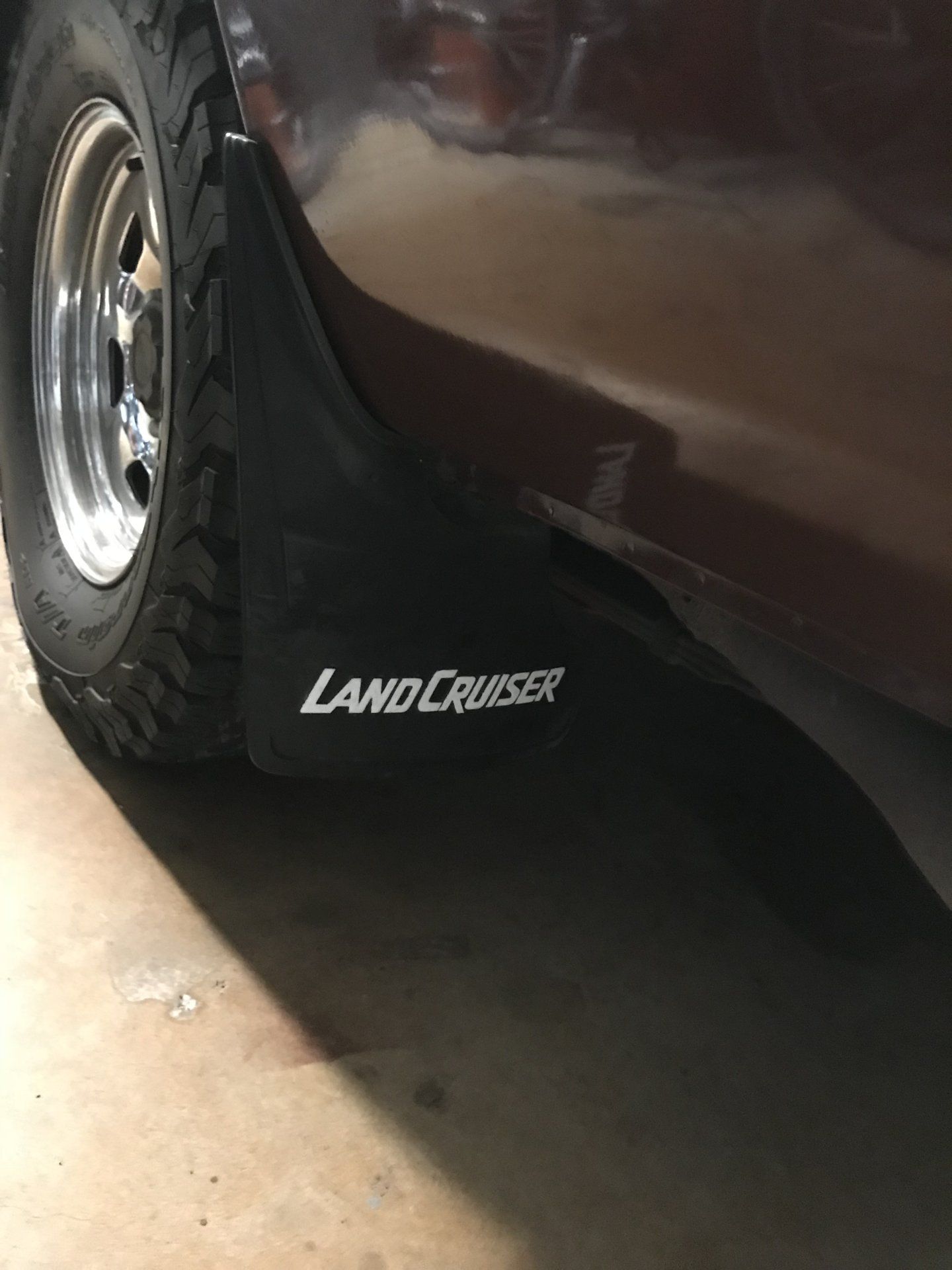

I used a white sharpie paint pen I got from Home Depot. Not a sharpie but they make an actual paint pen. Like @CaptClose mentions in his thread, I found dabbing the paint on worked better than strokes. Because of the way the paint flowed out of the pen, stokes would just spread the paint thin around allowing the black from the flap to show through. I did this with the flaps on the truck still but would have been infinitely easier to do if they were off the truck. Worked well:
