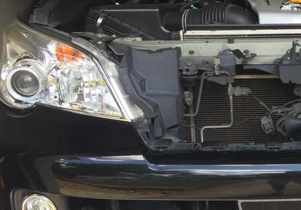

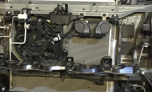

I have not seen anyone specifically do this on a 460. Side note… 460s with 3 zone HVAC have an electric fan for condenser on front of passenger side radiator…… 2 zone do not.
EDIT: This condenser fan setup for 3 zone HVAC exists for 10-22 model 460s. Starting in 2017 a base 460 could not be optioned with 3 zone HVAC.
The quick 3-zone interior check while shopping are the rear controls
And my truck has this...so I guess I'll be staying with the stock fan :)
What year is your GX? I know early 100 series also had the additional electric fan (my '00 did) but they dropped it in later model years, despite no changes to the 3 zone climate setup - my '04 did not have the fan. Never had overheating problems in either. But regardless, the clutched fan moves a LOT of air. If it's strictly the noise, and you live in a cool enough climate, I guess you could always mess around with the viscosity of the fan cluctch oil, but you're still going to have the sounds-like-a-737-taking-off sound at startup. Switching fan clutch fluid was a common mod to the old 80 series clutches to keep them running more frequently (switch to higher viscosity oil) to combat overheating issues on the 1FZ-FE.
