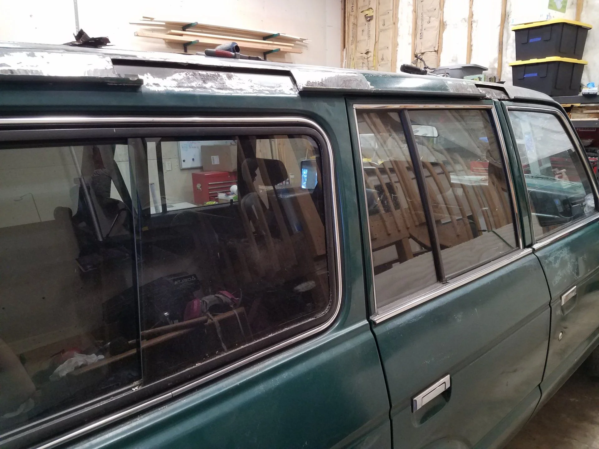

As the title says... and I'm curious.
It seems that the design is quite poor, frankly. Looking up automotive roof gutter rust and repair - in the custom world it's common to just cut them off and allow the water to run down the side.

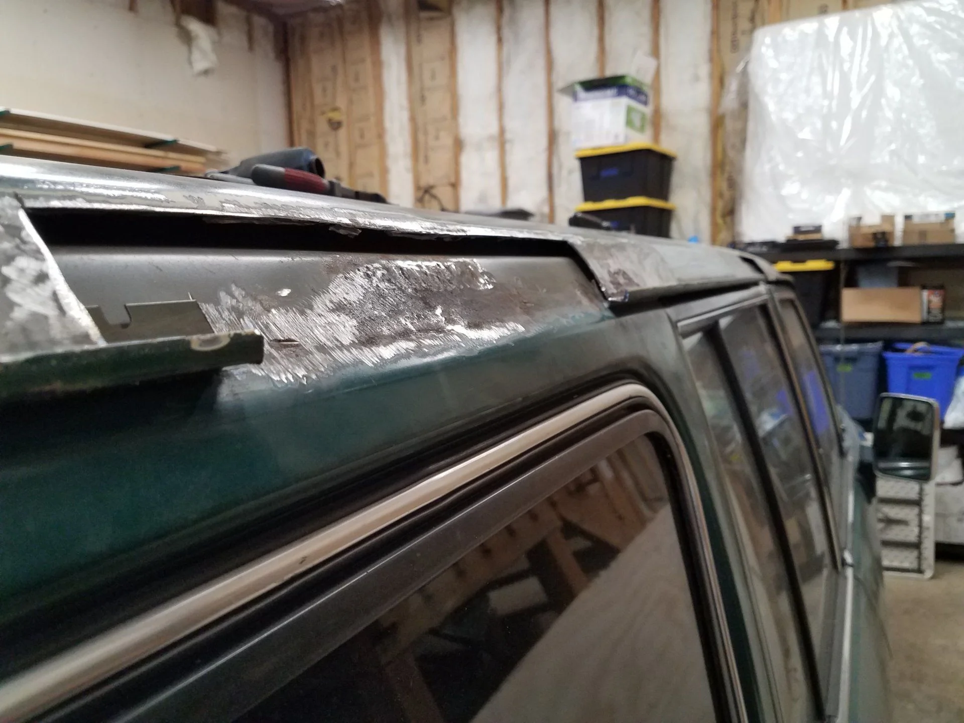

Curious if anyone has done that. I am in the middle of cutting out some bad sections and have about 18" without the gutter. It makes the roof look tall, but not bad.....
Seems like it wouldn't be terrible to cut it all off and weld the cap to the body....

The way the seams join and roll out, I am not so sure it's an easy thing. But for sure the head line would need to come out, then see what happened.

To give you an idea....
The headliner could stay so long as you do it in sections. The lines to do it are there.
As a reminder.... the body, roof cap, and gutter are 3 separate entities that are basically spot welded then seam sealed together. .

Sections of the roof above the gutter are bad, some of the sections parallel to the ground (in the gutter) are bad.
I attempted to weld shut some of the bad sections but even my Lincoln 140 at the lowest voltage burned right through the gutter.

How far in does the body go under the roof cap?
