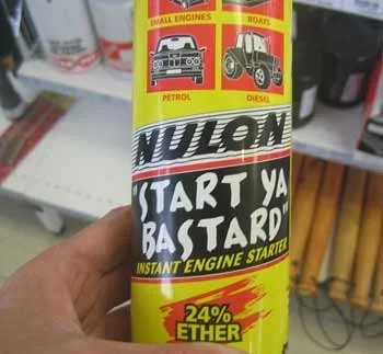

I've never tried starter fluid on my diesel. And I think that would be dangerous when you have superglow preheat, because you can't simply decide not to energise your preheat (unless you disconnect stuff) like I can with my manual preheat system. And if the starter fluid hits a glowing plug, it'll ignite instantly of course. And my memories of using that stuff on petrol engines in my younger years makes me consider it as a pretty ROUGH way to treat an engine. So the name "START YA BASTARD" on this Aussi starter fluid product is pretty appropriate in my view:
They should maybe show a toothless hill-billy holding the can as well... :D
But, if all other starting attempts fail .... and I really really want to hear the engine I'm working on actually run.. ..... Maybe...........
