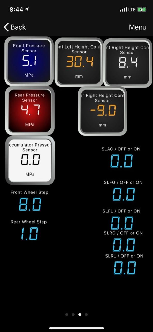

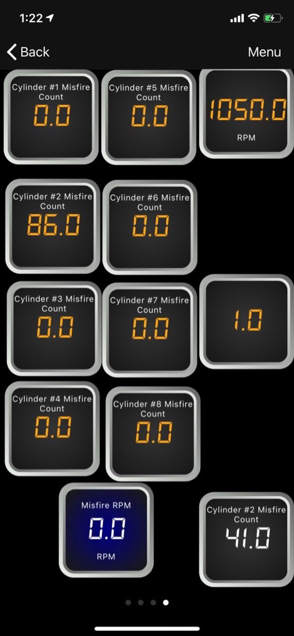

For what it's worth, I bought the OBDlink MX+ from Amazon that hooks to my iPhone via bluetooth and it comes with one free 'advanced' or 'extended' ECU that allows it to connect to the AHC (and the VGRS, ABS, VSC, Cruise Control ECUs). It allows me to read pressures and clear codes (have done it on the ABS and AHC ECUs already successfully), and it allows live reading (via a 'dashboard' or you can live plot the data (helpful for misfire catches). It just works so slick and quick that I always grab it first over Techstream (unless I have to use Techstream)
Here's a couple screen shots from my phone in case folks are interested in the dashboard setup for live data watching.
