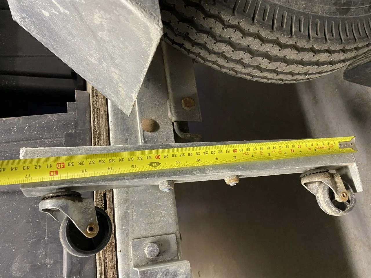

Can any of you fellas with a Harbor Freight or similar folding utility trailer help me out?
I need to fab up the bracket with casters to roll this thing around when folded. (Whatever that part is called.)
Planning to use some 2x2 L stock and either bolt or weld some casters on.
What is the over all length of the bracket? I assume it is centered on the mounting bolts. A close up pick would also be awesome!
You mean these pieces? They're part of the trailer, aren't they? Or are you building them for a similar (not HF) trailer?
@PAToyota, yes those bits right there. It bolts on, but I don't have them for my trailer. (Bought it used, assembled and tagged/registered, which is a thing in WA state.)
@eatSleepWoof, perfect. Thank you!!! I had guessed they were about 18" each and bought angle iron for that length. Those pics with measurements speak volumes. I had missed those little tabs for getting the trailer up on the casters.
Thanks again!!!

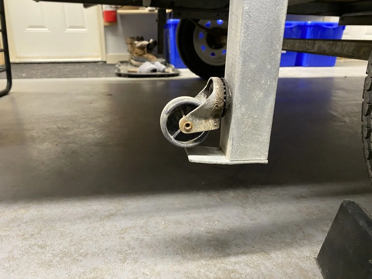

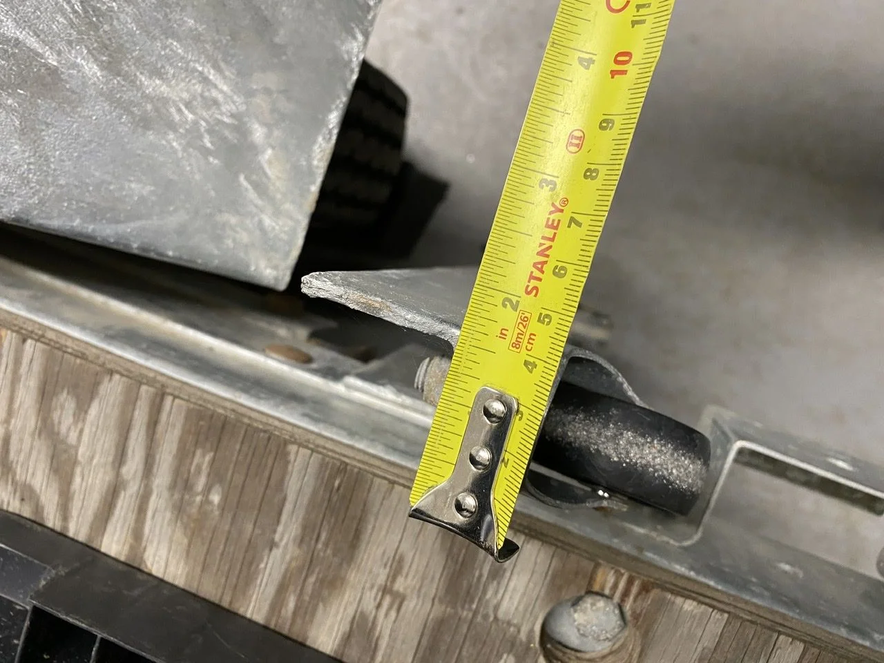

Getting this thing folded up has again become a priority. Looking at your measurements, I have 17" OAL and the first bolt-hole about 8.25" With that, the bottom of the bracket is only 2" off the deck, aka ground, aka likely going to grind-out when approaching my stupid steep driveway. Is that right?
That is to say, what is the ground clearance to that bracket?
