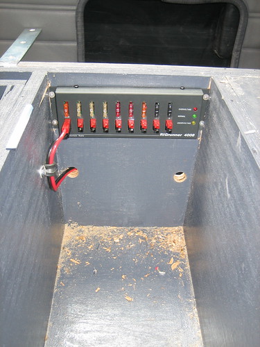

I agree, start over. Quite a few of us here have used the Solar Industries 24/12V converter. It's nice as it will also load balance your batteries. Check out Stone's excellent install thread, I stole their plan to wire it in with a relay so it only load balances when the truck is running.
For now I have the 12V power going to a Rigrunner. Have put Anderson Powerpoles on all my 12V accessories, then plug them right in, works great.
If my 12V needs exceed what the converter can provide (likely...) I'll install a 3rd 12V battery and charge it from the Solar.
