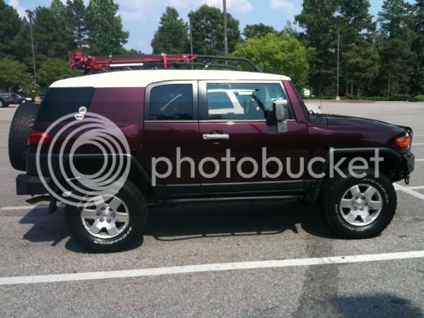

Here's a better side shot - cell pic.
I guess I need to get some new tires...these seem a bit small! I like the Toyo MTs (285 75 17 aka 34x11.5x17) but they are expensive!! OPEN COUNTRY M/T | Toyo Tires
I want a MT that will be good on road (since most my driving is pavement) - the Toyos seem to be a more aggressive AT than full on MT (suggestions welcome). I also think I'd like to go to a 16" wheel - tires seem a bit cheaper - who knows, pure speculation now!
She's definitely a bit taller! I nailed the parking garage cross bar at Crabtree w the highlift leaving today (I was foolish and thought I'd just waltz in and grab a new iPhone - not so much).
Might have to pull it off being it adds a good 4" to my height.

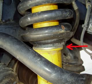

Install was pretty easy but might have overlooked installing a 5mm spacer in the coilovers - there is a slight lean to the driver's side. (OEM driver coilover is a hair longer than passenger)
For Joe's benefit - don't think it's a quick swap! (full disassemble required)
I'll have to see how it goes in a month or so - if it really bugs me (plus need to remeasure now that I've done alignment etc - think it might be a bit closer than it was)
Truck seems to drive true after alignment - do you think there are long term implications by not installing that spacer and having different coilover lengths?
