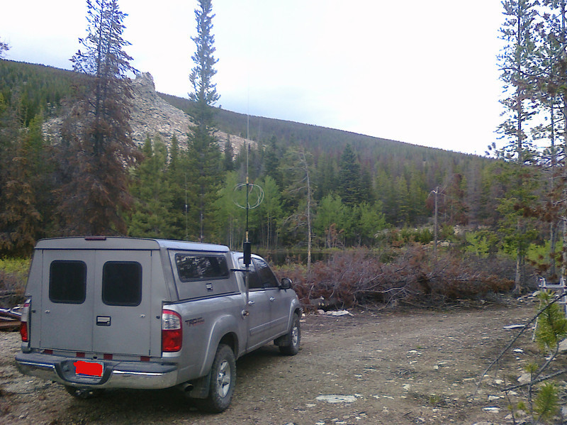

A picture of the truck on our property up in Montana working DX from the truck. 102" whip with a egg beater on a Hi-Q screwdriver. Radio is a Icom 706 MKII G.
Normally I run a 5' whip on the screwdriver which is a good all around length. Then remove whip and fold down the other 2 on the roof in tree country.
In Death Valley you will be hard pressed to hit POTOSI or Angle unless down at the south end of Death Valley. Been some that have been successful around UBHEBE Crater.
That is why HF is a good thing to have and also why I suggested the General upgrade in a previous post.
I did work HF from Furnace Creek while there and chatted with a guy in Sun City West Az on 40 mtrs.
