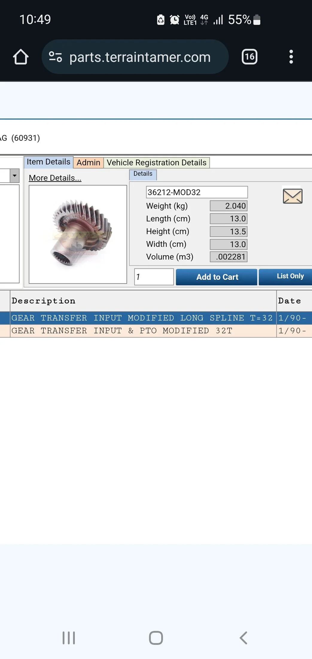

Terrain Tamer offer a modified output gear for the H55F to spread the load over a longer area of splines.
Anyone had any experience with these?
Will they mesh okay with the existing idler gear? (provided no excessive wear of course)

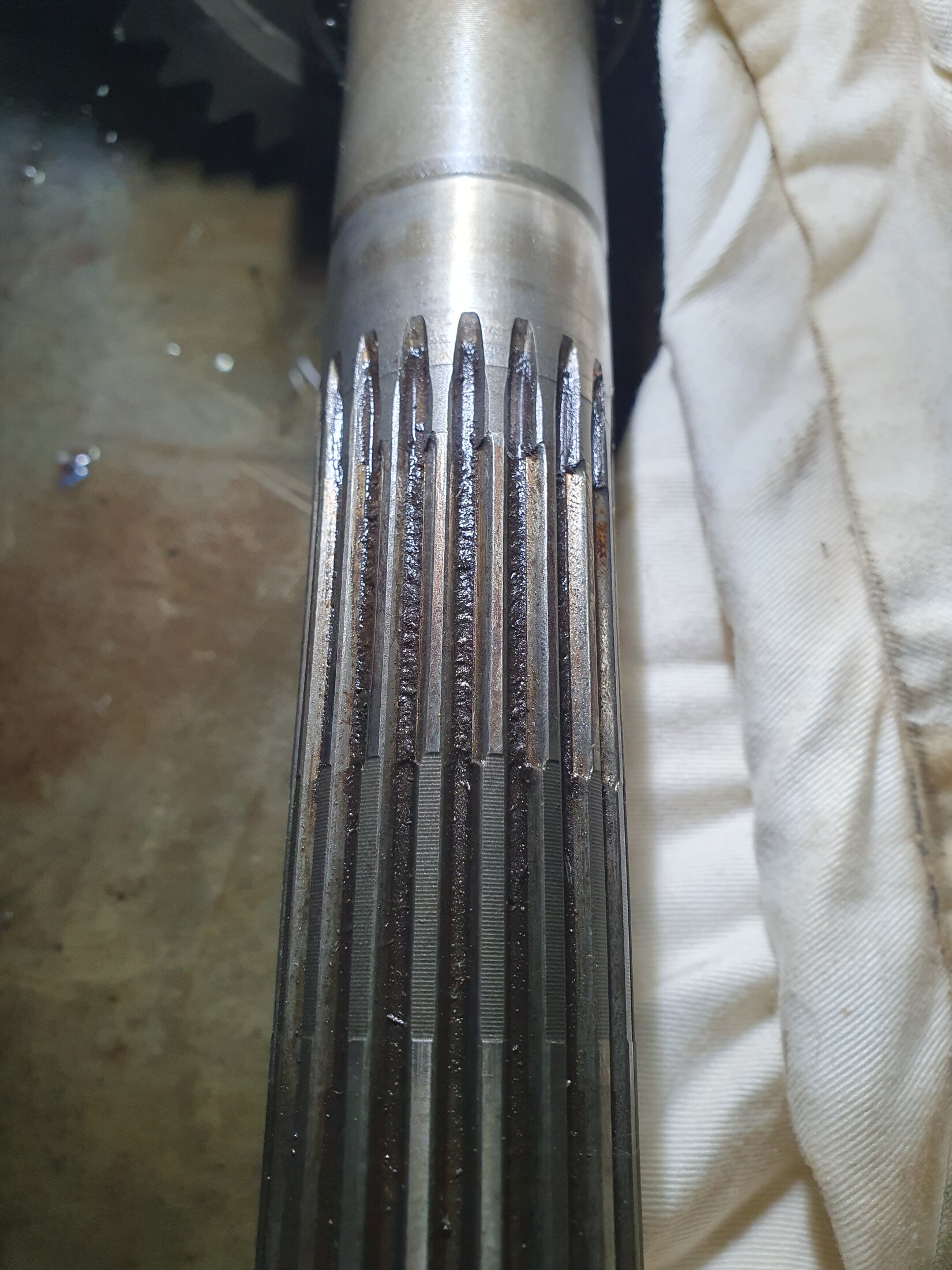

Are they considered to be an adequate repair for fitting to a shaft with worn splines on the narrow width of the standard Toyota gear, but good splines where the PTO gear sits?
Or only recommended to be fitted to a new shaft with perfect splines, to prolong the life expectancy?
