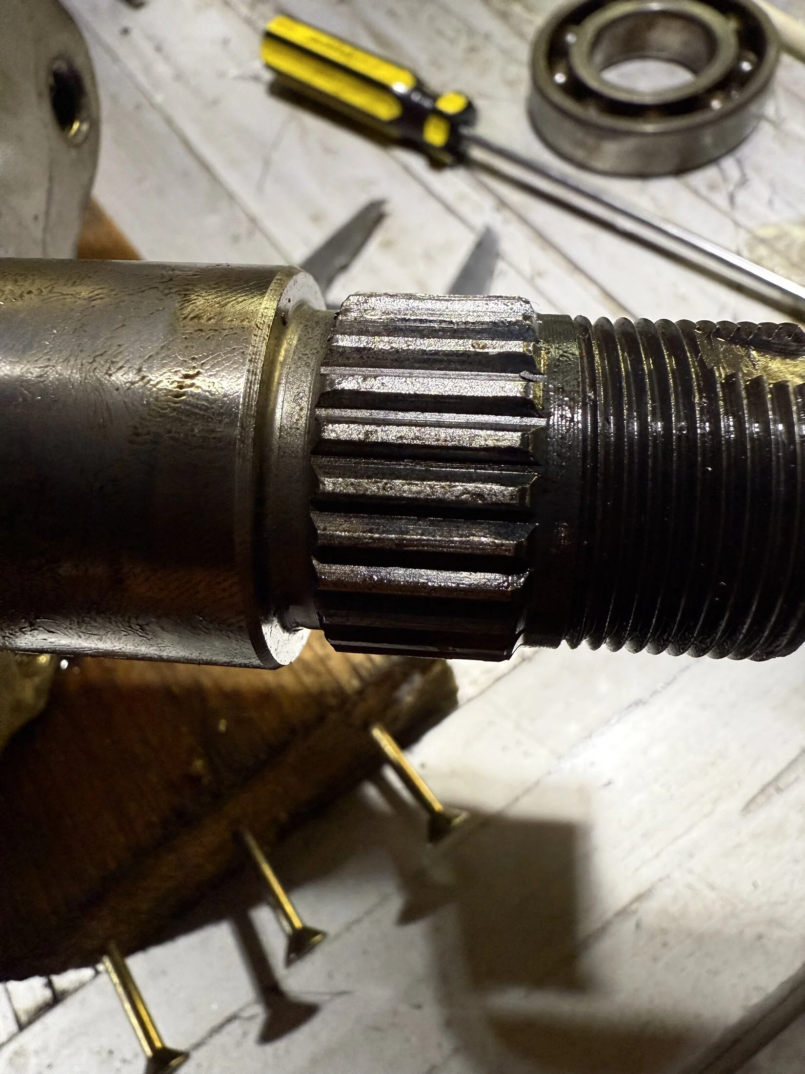

Now these chips don't seem too life threatening, just in the corner of the ends. I have used a dremel to smoothen out the flesh of the chips and popped it back in. However totally related this is, I have lost many sleeping hours haunted by these chips in the layshaft, always getting nightmares about how these chips could get worse when driven. Done my fair share of research but could not find anything specific. What do you guys think? Should I call it a day and close it in with the bearings or pop it out and replace the entire layshaft considering how the chips look? Also considering the wear on bearing surfaces and the counter 5th gear synchro assembly teeth as attached, that is also very terribly worn. I have also dremelled it and lost sleep to it as well.

The splines for the counter fifth synchro hub look a bit chewed, but if the hub goes on tightly with no play, they are fine.

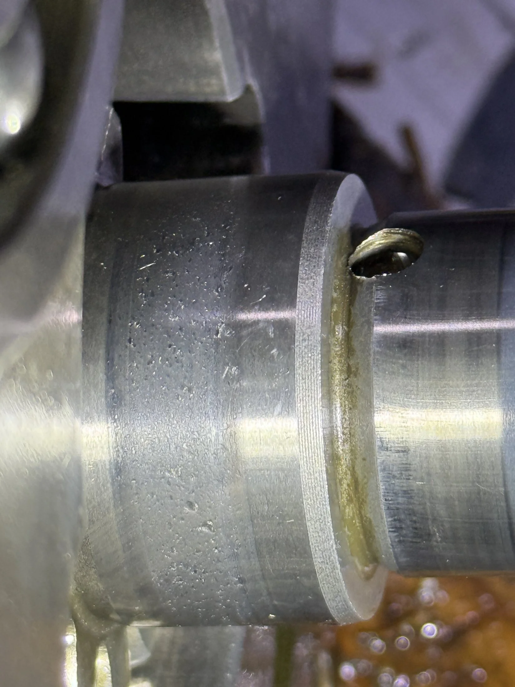

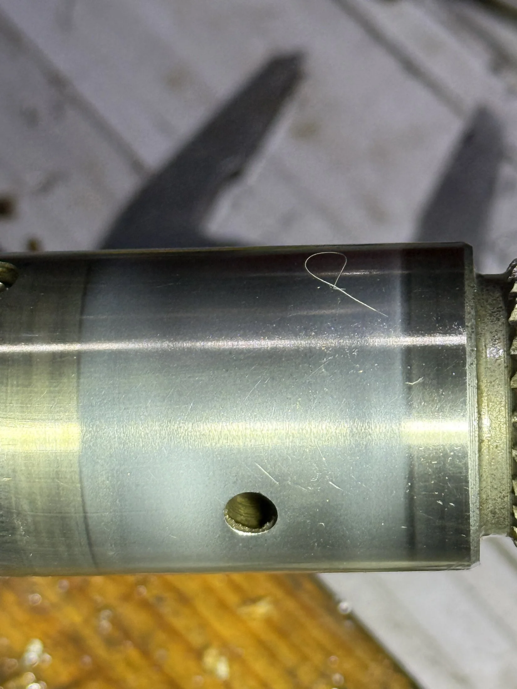

The layshaft bearing surfaces does see wear to it, have not got a micrometer to measure to factory specs but this is what they look like.
Tell me if the whole thing needs replacing or not. I am willing to do it just need to remove the untimely installed output shaft bearing.
Looks like there is pitting on the rear layshaf bearing surface, in which case I would say it needs to be replaced.
