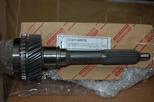

So, I finally pulled the trigger and have a new H55F on its way to Fred Anderson. Couldn't help myself.
Anyway, I need to swap the existing input shaft with the correct shaft for the 1HZ.
Anybody here rebuilt an H55? Looking thru the FSM, it looks like you can just pull the bearing retainer and seal, the shaft. Pull and re-press the bearing, swap over the needle bearings over to the new shaft and put it all back on the way it came off.
Looks simple, but some times it looks simpler than it really is:grinpimp:
Any input would be groovy
New shaft via Beno
