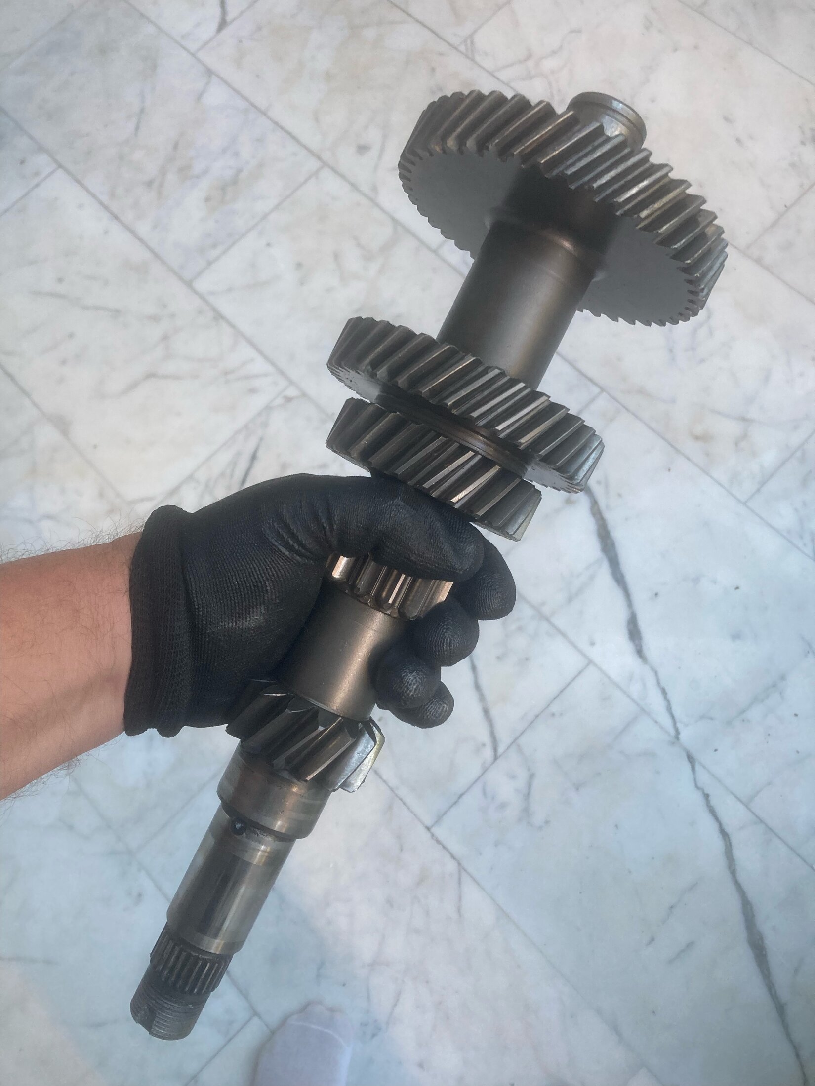

H55F gearbox Question:
Oct 3, 2024
1
1
Warsaw Poland
do this parts cross 334241-60050 with 334241-60060 ?
Firstly, your part numbers are incorrect, the part numbers are 33421-60050 and 33421-60060. -60050 is the 12H-T lay shaft, 60060 is the post-1985 H55F lay shaft for all other engines.
-60060 is not an official substitution and the different part numbers mean they will not be identical.
I believe however that they are interchangeable, but am not 100% sure. Hopefully Georg @orangefj45 can chime in and tell us.
Apparently the difference between the early and late counters is the width of the 1st gear. (Slightly wider) The later shafts are stronger.
I think that is comparing the pre-1985 H55F lay shaft (-60040) to the later -60060. -60050 was exclusive to the HJ61 and I don't know how these shafts differed from others.
