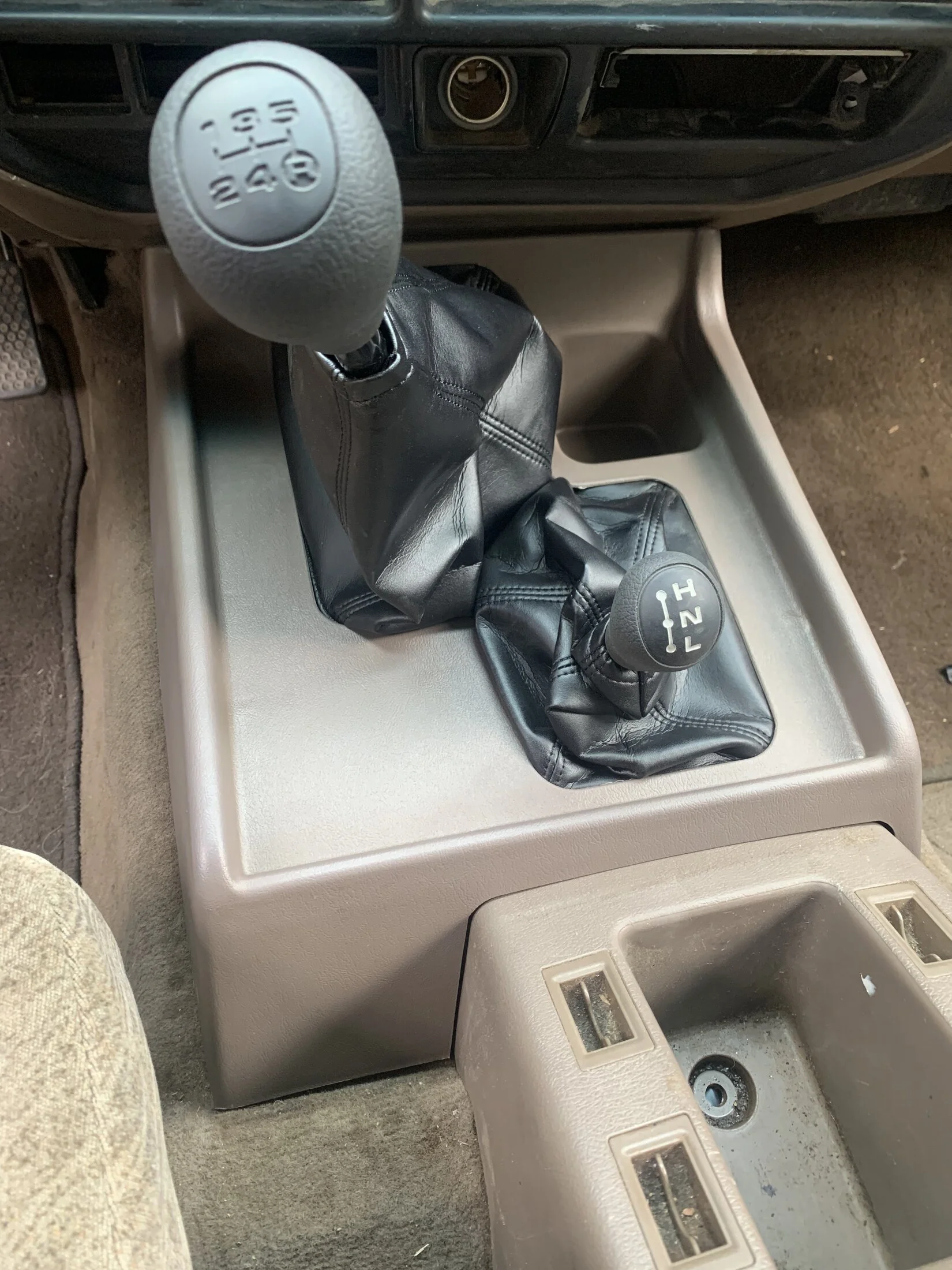

For me, unless I was doing a full true stock resto, The amount of money the sad abused plastic ones tend to go for made it easy for me to grab the DVS one. Especially mated to their center console, but that's a different story. Lol.

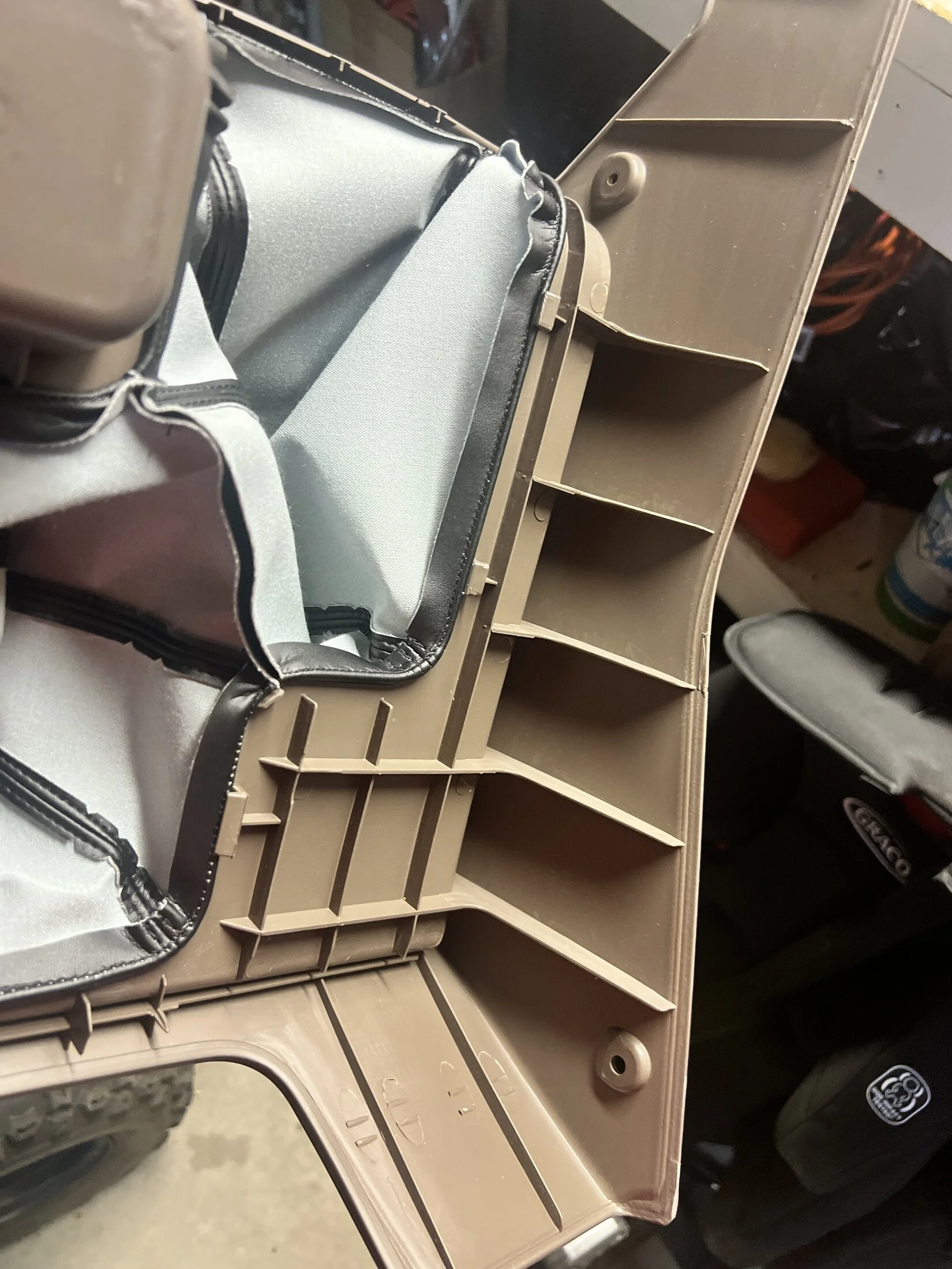

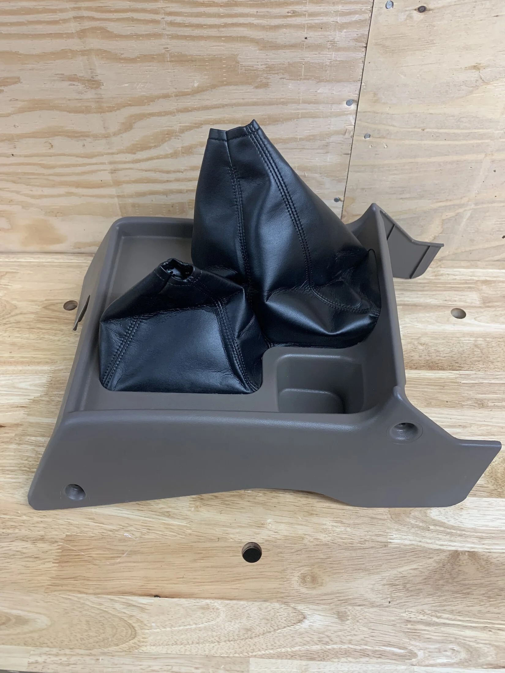

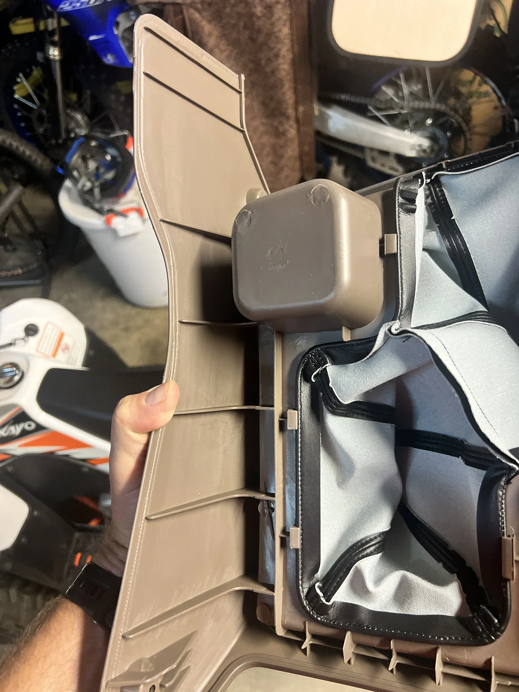

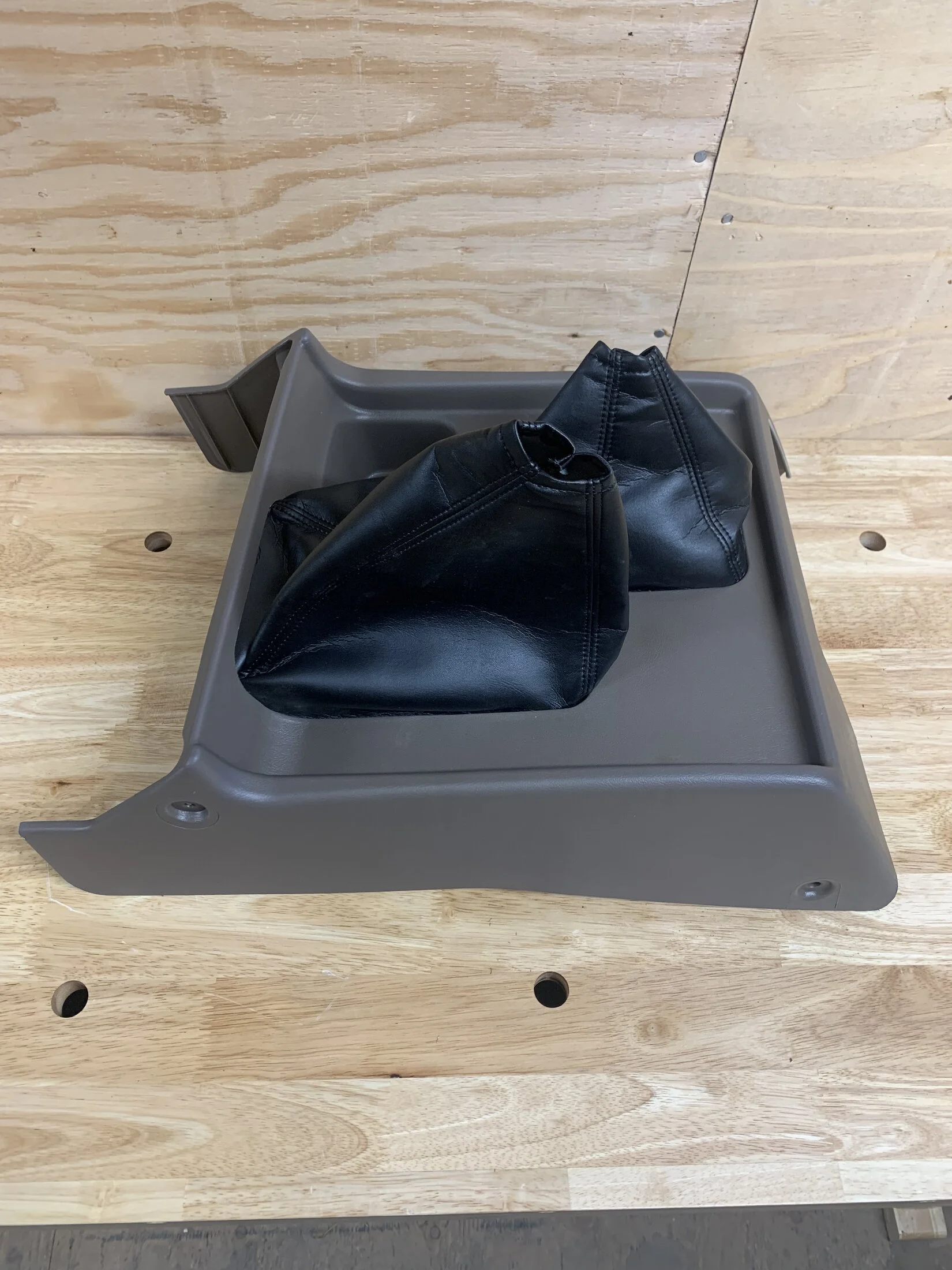

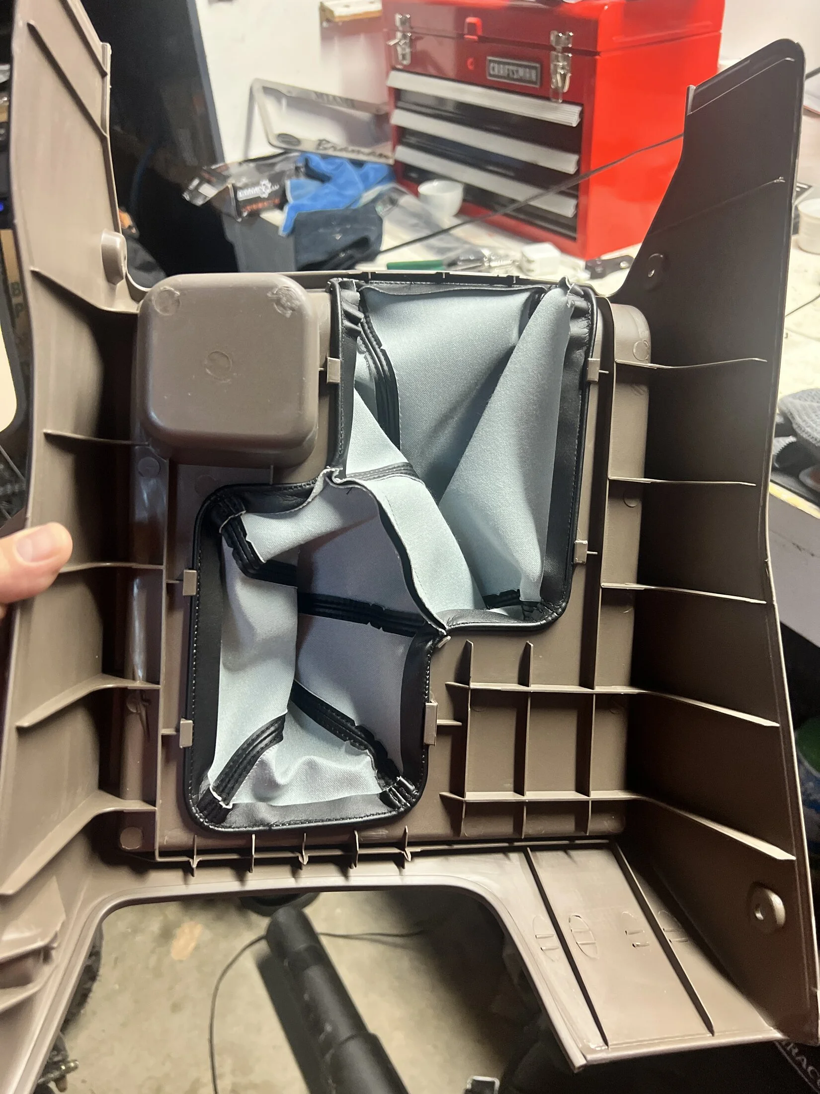

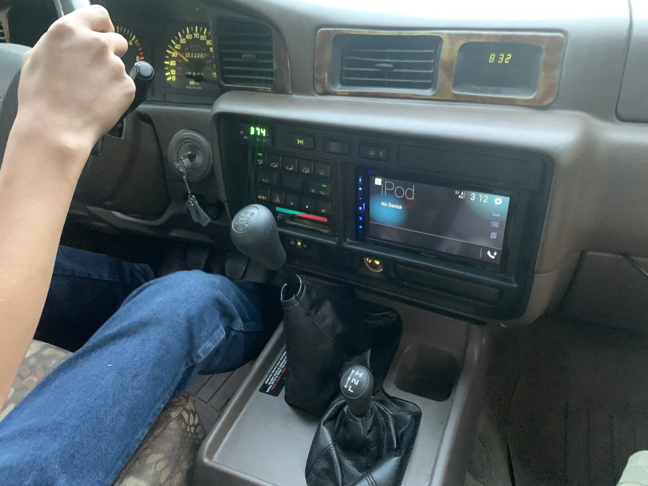

I’ve been getting these 3D printed. Kinda pricey, but still cheaper than a used factory original goes for these days. Available in tan or gray. $350 before shipping. Will be running another batch as soon as I get enough orders to make it worth while….

We had one scanned and 3D printed. It was very expensive due to R&D and the size of the printer needed to make them. Cost made it not worth bringing to market.
I am sure you know they are unobtainium and you probably sell them as fast as you make them. What material are they being printed from? You must be painting or coating afterwards?

No paint, solid color, comes with boot, they’re sold before they are made. No disrespect to @mac I wasn’t trying to hijack your thread….

Nice job! Did you model that yourself @mudandrock ? How many orders do you need for a production run? I'm interested.
Takes about 1 month start to finish. Production number does not matter, just has to be paid for up front. The plastic man is the one making the most money on these, I’m just bringing them to market.

A bunch of orders were made due to this thread. Just finished up the brown and they’ll be shipped this week. Gray soon to follow. If you want one just PM me and once you send payment I’ll get you in the queue.
