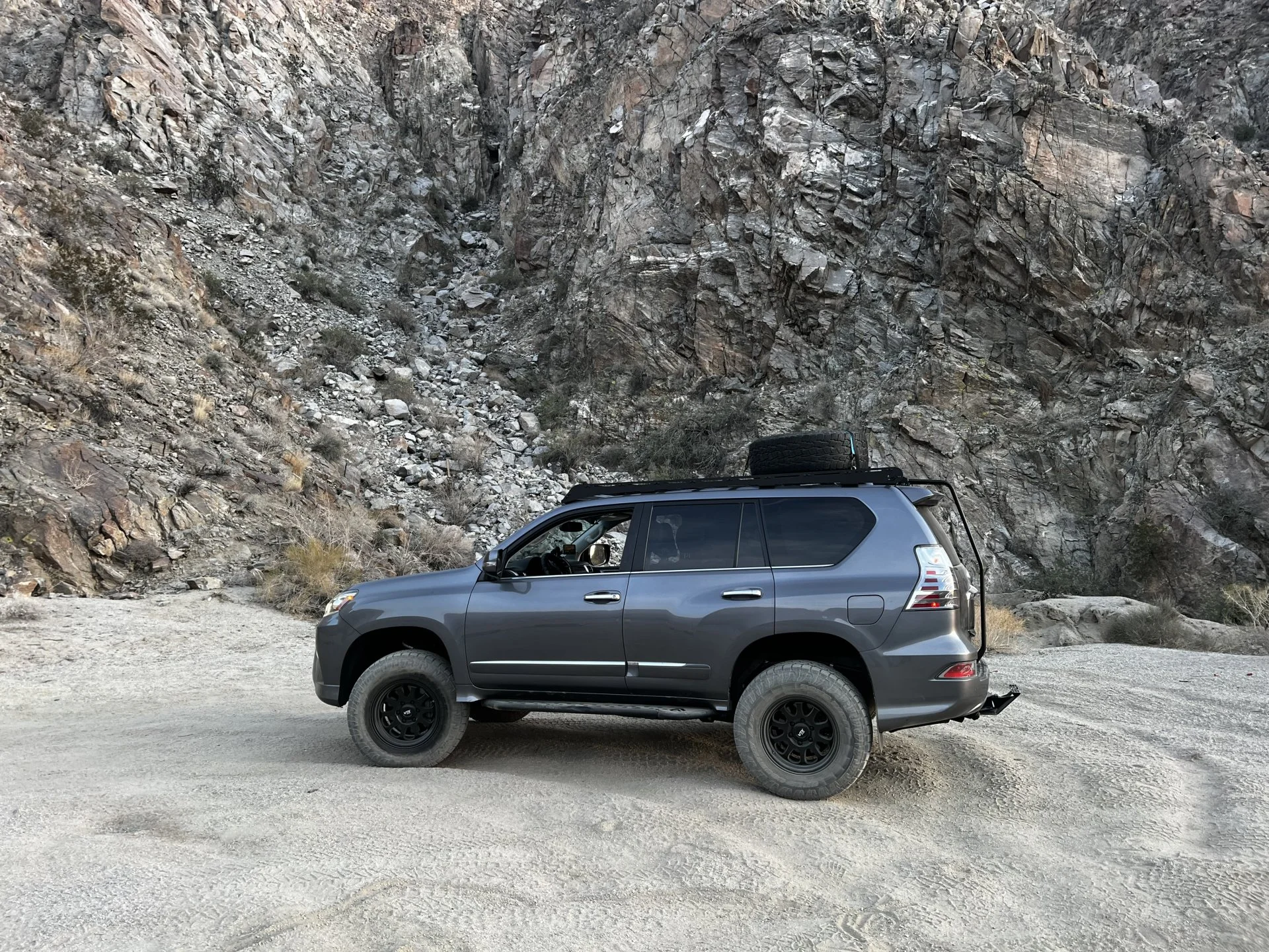

I did invest in a Prinsu rack so that I can carry a full size spare on long road trips or off roading. And if off-roading is just a day trip, then I don’t bother throwing it on the roof, if I have enough space in the cargo area.
Yes it is a pain to get it on the roof and tied down, but it’s not that bad. Beats spending over 1k on a hitch solution or adding additional weight with a steel bumper. To each his own. Cheers!
