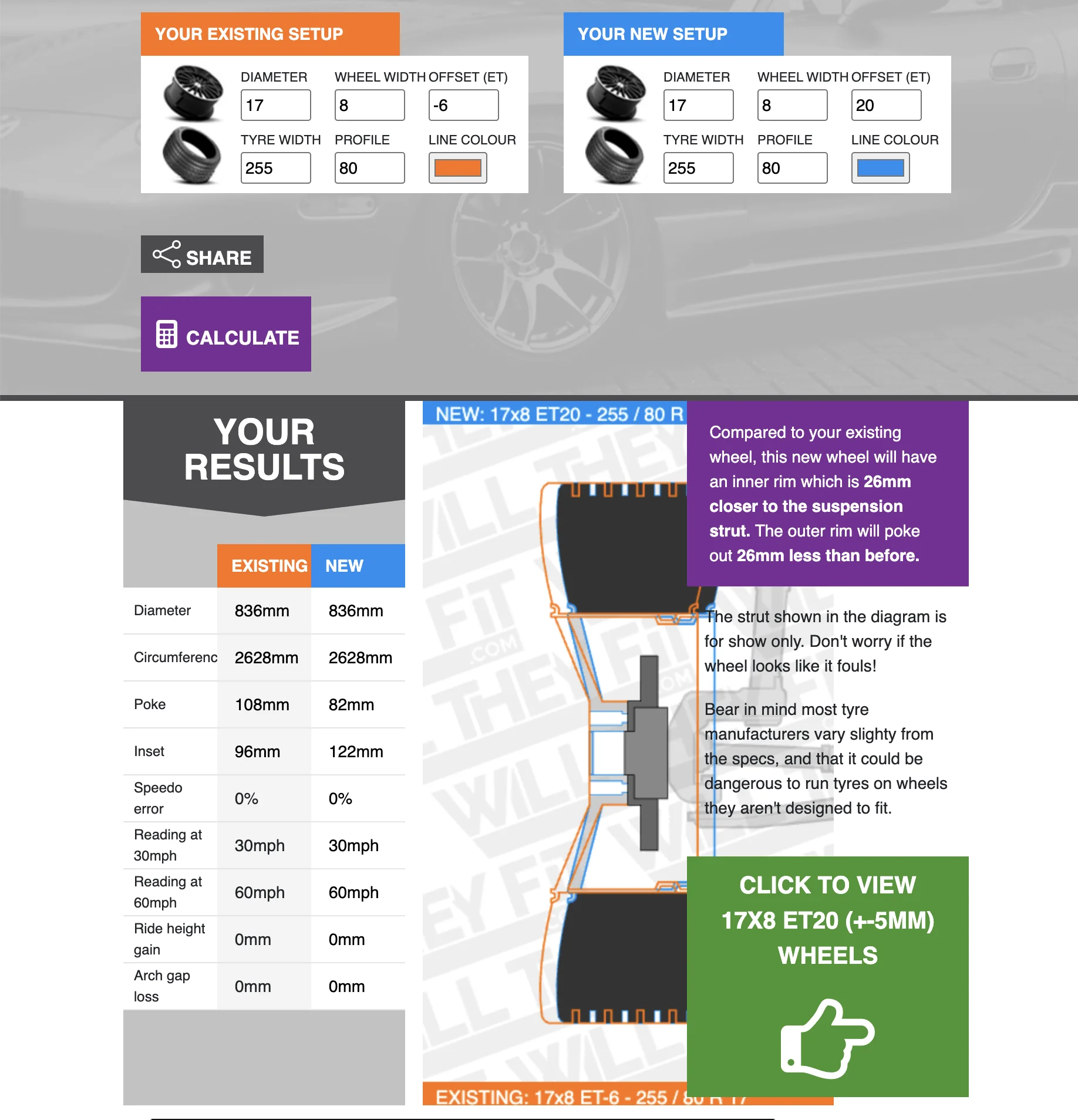

Background time. There's a lot of reasons I am pursuing changing up the wheel/tire package on my GX, which buckets into one project goal to either get a more aggressive or taller tire while minimizing any extra unsprung weight at each corner and without creating a situation in which I have to find a speciality shop for an alignment and/or cut and trim extensively. I'll go into more detail later as to why these are important. It's a lot of juggling to make this "happy medium" happen.
Let's say I'm going with the 255/80/17 tire. The wheel sizes and offsets being considered to pair with this are:
  • 17x8, 20mm
  • 17x8, -6mm
  • 17x8.5, 0mm
An 8.5" wide wheel technically works as per the tire manufacturer, but blowing the tire off the bead when airing down to ~15 PSI will always be in the back of my mind, and peace of mind is huge off-road. This rules out an 8.5" wide wheel for this tire size. So then the options are 17x8 20mm and 17x8 -6mm. As far as which is better for this application, here's how I'm deciphering things:
  • The -6mm offset wheel sticks out further from the vehicle, but has a longer scrub radius. This means that there's a higher likelihood (in concept) of hitting the body mount, which with this tire size isn't too likely, but can't be ruled out. [Someone correct me if I'm wrong]. It's likely that caster will have to be maxed out for -6 to work.
  • The 20mm offset wheel tucks in further, and will likely clear without issue, but running too wide of a tire on this offset can mean rubbing the UCA. In essence, this is 26mm tighter to the suspension than the -6mm wheel, which translates to 1.02" closer-- or it can be looked at as the -6 being 1.02" further out from the hub.

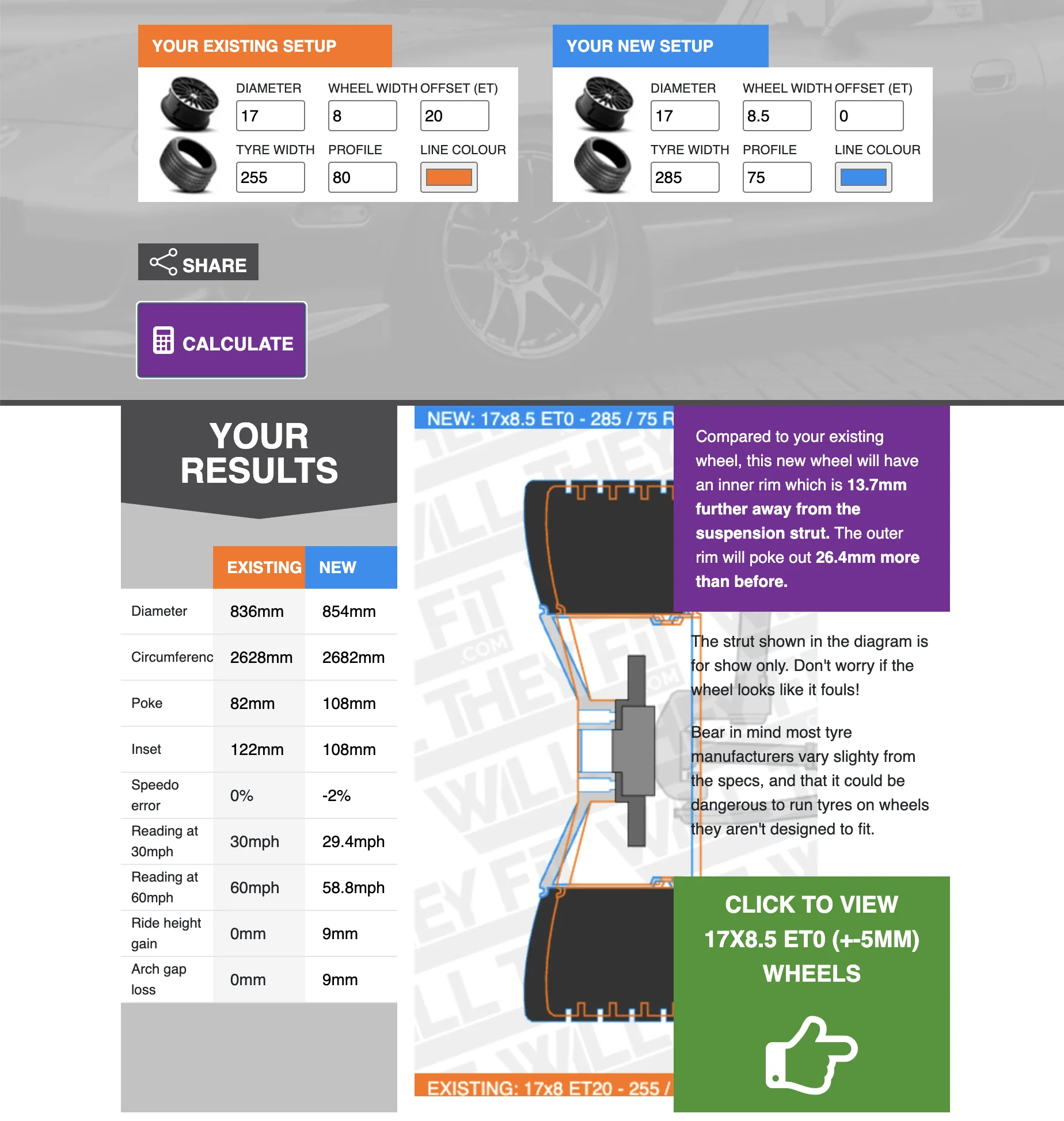

For the hell of it though, let's say I were to do 285/75/17. This opens up the option of a 17x8.5" 0 offset wheel. Here's how it compares to the 17x8 -6 offset wheel:
And here's how it compares to the 17x8 20mm offset wheel:
Math tells me that with 285/75/17 being 33.9x11.3" and 255/80/17 being 33.1x10.0", the 285/75 is .8" taller, which is really only .4" more tire per side. This alone shouldn't be an issue fitting my GX (which has a BMC and Ironman bumper) as far as I can tell. But the 285/75 is 1.3" wider, which is over a half inch more per side. There's also a 17x8.5 -10mm offset wheel that's an option, but I understand that brings an even higher likelihood of needing to trim/cut/align in a specific way. In any capacity, the benefit of picking the 8.5" wide wheel even with 0 offset is to run a 34-35" tire, which goes back to the need to trim/cut and do a maximum-caster alignment.

So coming full circle, the decision again comes down to whether I should go -6mm or 20mm offset for a 17x8" wheel.
I may have missed it, what's the link to where you got your numbers?
Just get a normal set of 17x8.5, 0-offset wheels, 285/70R17 tires of your choice, and call it good :). I know you like Toyos and the AT3 in that size is pretty darn light. Or, if you want to run the 255/80R17, get the OEM TRD wheels, which I believe are +15mm offset and 17x7.5, which would be a perfect fit for a pizza cutter tire like that. With a narrow tire and positive offset, they should tuck very well and rub less than the wider and zero or negative offset wheels. You should be able to find C rated tires in both sizes and SL-rated tires in the 285s, both of which are relatively light as well.
