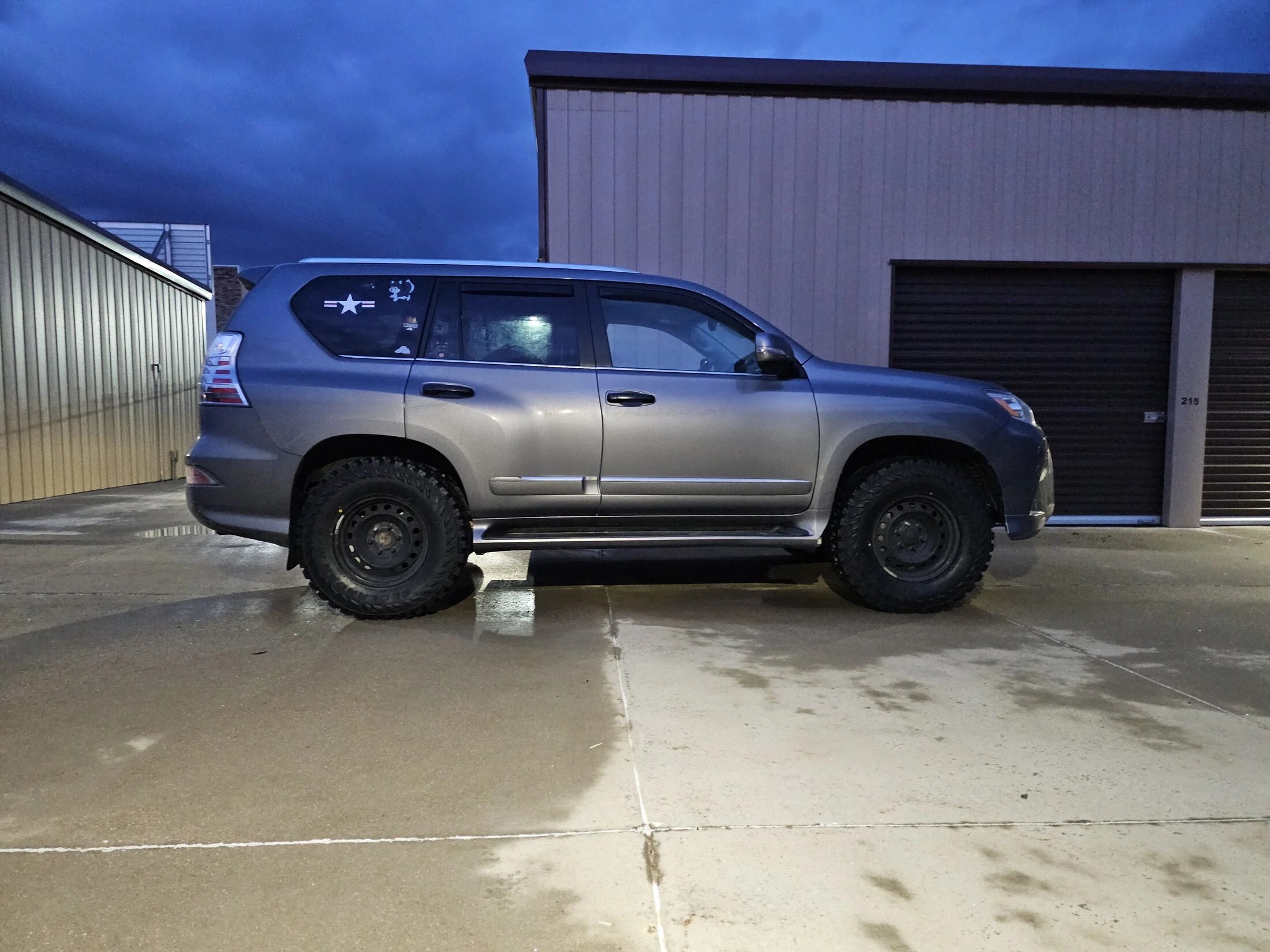

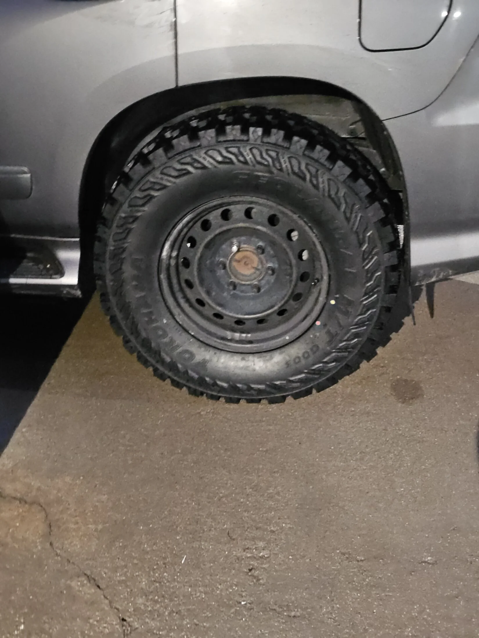

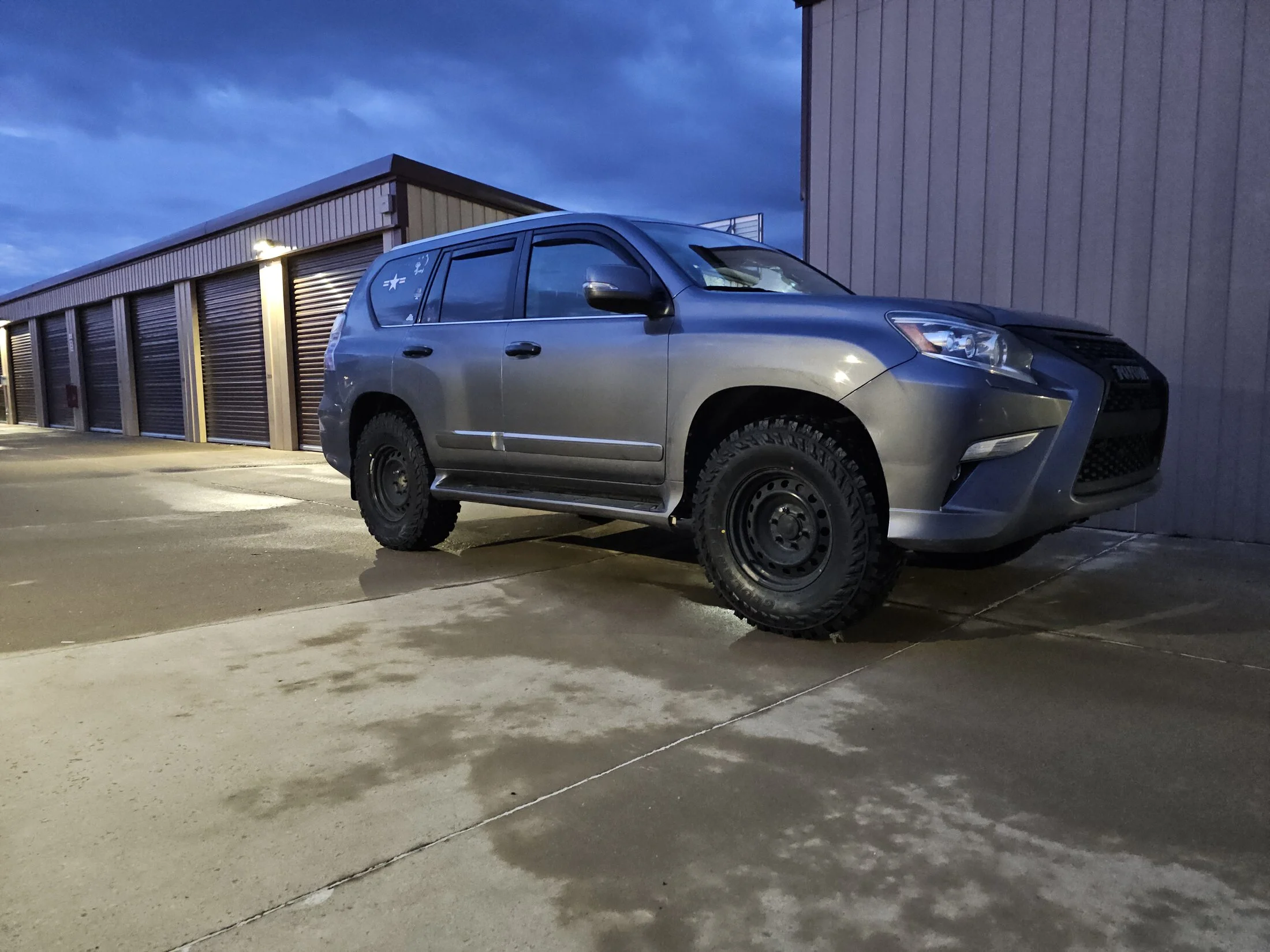

285 75r17 Yoko MT G003 on a GX with 1.75 of lift in the front and none in the back other than the 2nd and 3rd row delete.
