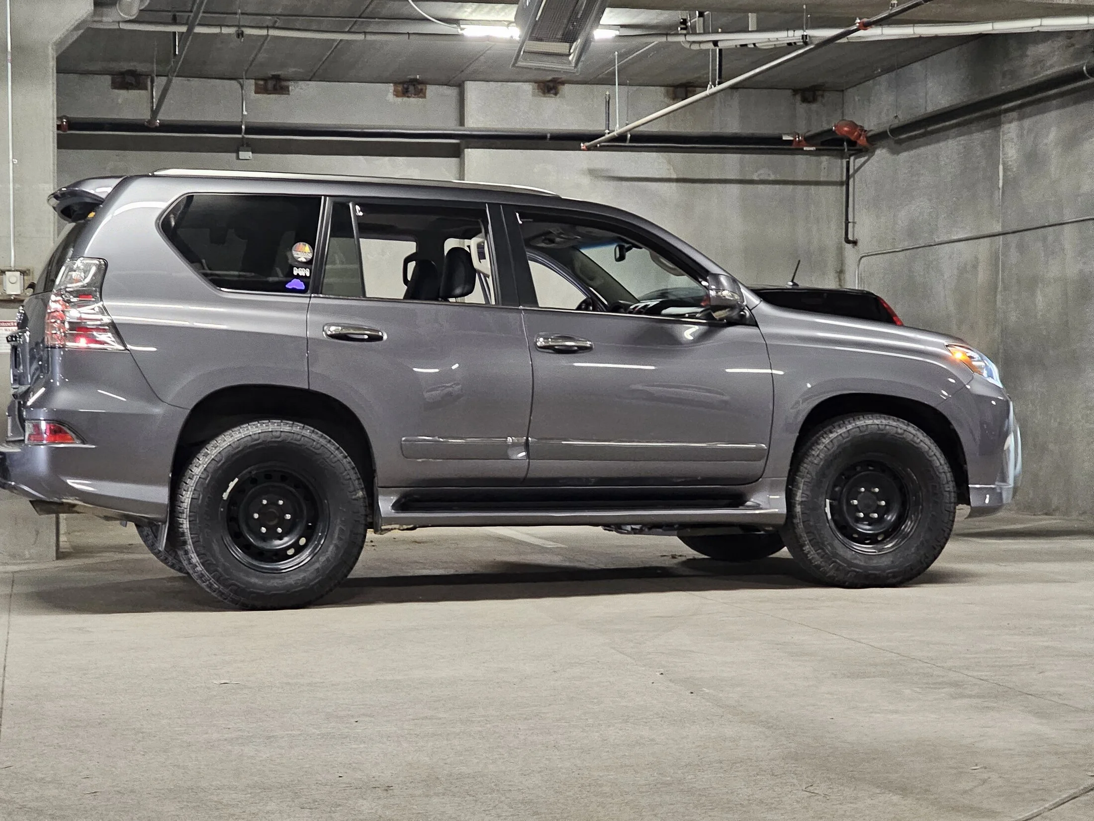

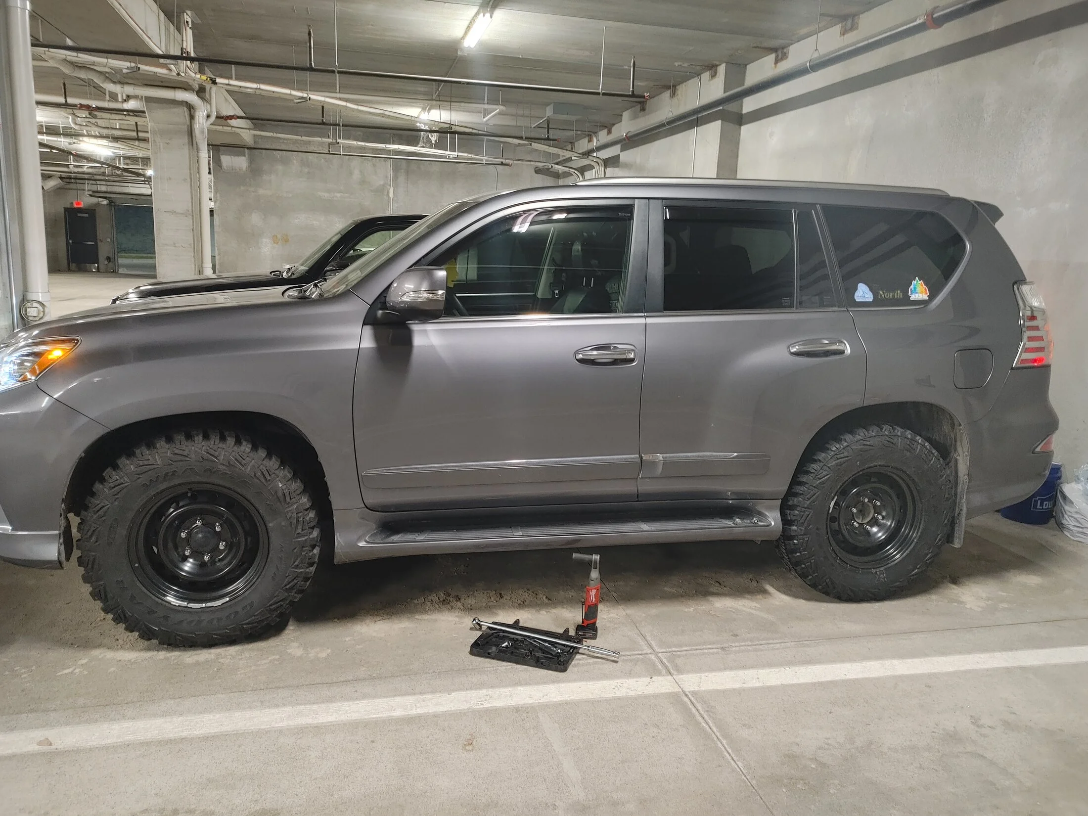

For Lift i would advise Bilstein 5100s with corn fed spacers for the back. I did 1.75F and
.75R. Just enough for clearance, not enough to need anything else, at all.
For wheels i would recommend 17x7.5" oem steelies from ebay, they can be ha for about $93 shipped.
I would keep the single use sliders(oem steps) to protect the body pinch weld. Take em off when they are jacked.
If you just aeateticaly want them gone, there are youtube videos with the steps to remove the step portion and cut the plastic fascia.
You can also buy the Prado rocker/valance panel, some have done that.
If you get armor, I would cut the bumper to correspond with the armor.
ARB power train skids are about $650
My fuel tank skid was less than 400 shipped.
If you push back front and rear fender liners and deal with the fastener for the step. You should be able to run a 285 70r17 or 255/80R17 with no rubbing on oem wheels after an alignment.
I ran those sizes before stepping up to big 34s.
Included pics with both sizes. Truck was unlifted in both pictures.
