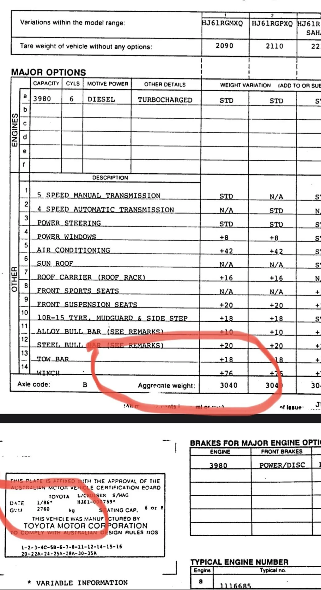

I have a 1988 HJ 61 manual, and came across this document a while back….
On the document it shows Tare weight, Aggregate weight, and the GVM on the compliance plate. I am wondering what the Aggregate weight is as it is more than the gvm….
Thanks!
Gross mass is total weight allowed when a vehicle is loaded down.
Aggregate is gvm + max allowed tongue weight from a trailer
From that paperwork max tongue weight is 280 kg
