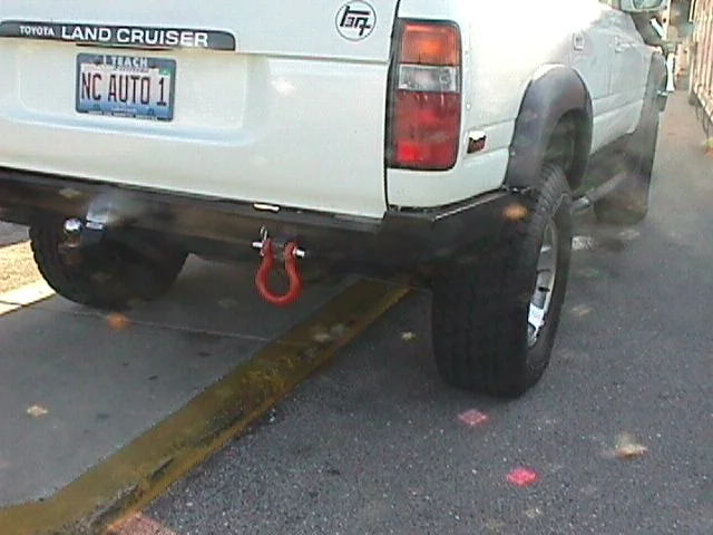

First pic is of the old, too close and no-kick-out version.

Gumby, nice sliders. One question, do you think the outter tubing towards the rear of the slider sticking out further than the front portion is positive or negative? Just looks like it might cause to to get hung up easier than if it was a single tube running equally spaced down the slider.
Curious because i plan on adding the tubing to my homemade sliders soon.

8th paragraph in the write up. The bump out works great. I did get wedged once, but i drive it hard knowing they will keep me off stuff. The only way to get hung up on the bump out is to get them both wedged. Otherwise it pushes off.
