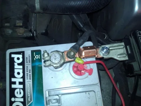

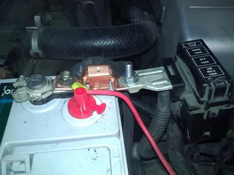

What parts did everyone use to connect the positive terminal? I've been to Autozone twice now and can't find something to extend the positive cable far enough to reach the post.

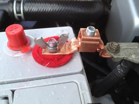

I used a Blackburn #3/0 Stranded to #4 Stranded Type-BC Single Conductor from Home Depot ($5) by removing the hole connector from one and combining it with another. Pictures aren't great.
Thanks zmcnelis. I picked up a couple of those copper connectors and ended up hooking to the marine post.

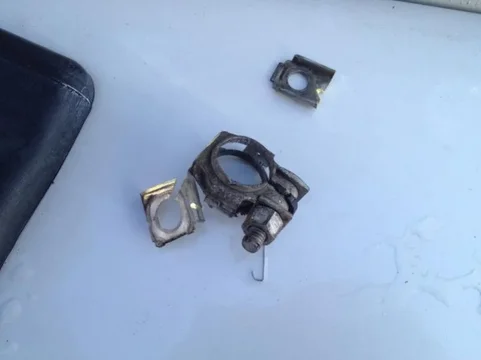

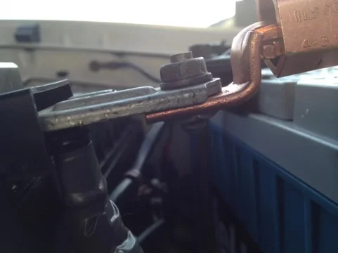

I got pissed off at the thought of going for another trip to the hardware store for a bolt and nut so I cut off the bolt from the OEM positive terminal and reused it.
Final result.... For now.
Now to fab a better clamp, but in the meantime:
3 trips to autozone (all a waste) and 1 trip to home depot later I'm at least back in business.
