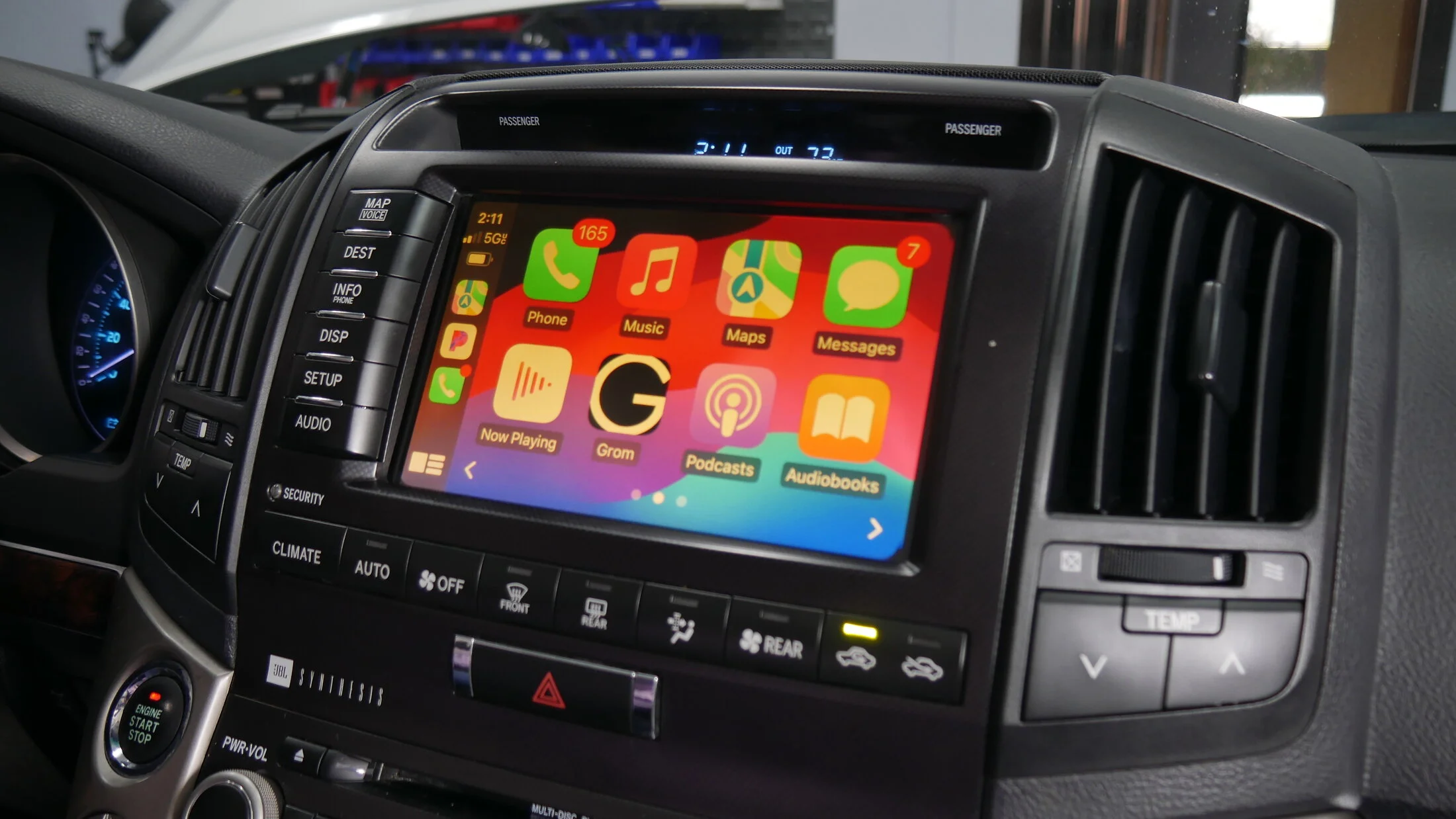

We recently installed the GROM VLine VL2 system for CarPlay Android Auto integration into the factory car stereo of Toyota Land Cruiser 2010-2012. Here is step-by-step install video:
We show how to connect the system to the back of the stereo and display and how to route the cables to the glove compartment to secure the unit there. CarPlay and Android Auto fully integrate with the stereo's touchscreen, buttons, and controls. Here is the demo video:

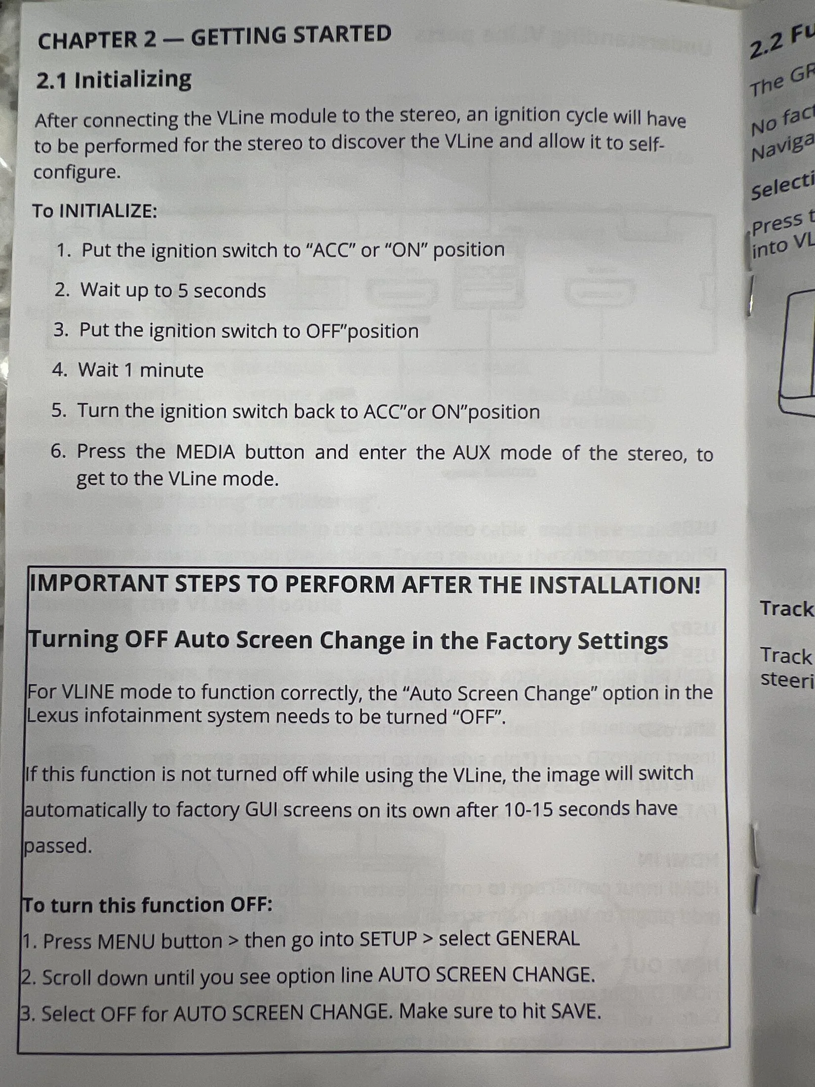

Most annoying: When put into reverse in backup camera activates as it should, but when put back into drive, it switches back to OEM nav unit and needs to manually be put back to vline/carplay
Mangler,
I believe there is a setting in the OEM head unit* that determines whether or not the display reverts back to the nav/maps screen after a short period of time using the climate, audio, etc. I.e., you are on the map screen, select the "audio" hard button to change stations, and then it flips back to the map after 5-10 seconds. I found it annoying so found the setting to undo that behavior. I don't know if that is contributing to what you are seeing or not, or if you've already tried this, but figured it was worth mentioning in case it helped resolve your issue.
Good luck!
* definitely is on my 2015 LX; can't remember about my 2008 LC I sold
Mangler,
Good luck!
THANK YOU! This has been driving me bonkers
I will look into this for sure!!!
Bottom is this page has the steps needed
Big thanks to @c4xplsv and @Valgrind for noticing this.
Finally got around to trying it on my 2010 LC and it works perfect and as it should now!
Double checked my included instructions to make sure i didnt miss this step, and it was NOT included in my instructions.
