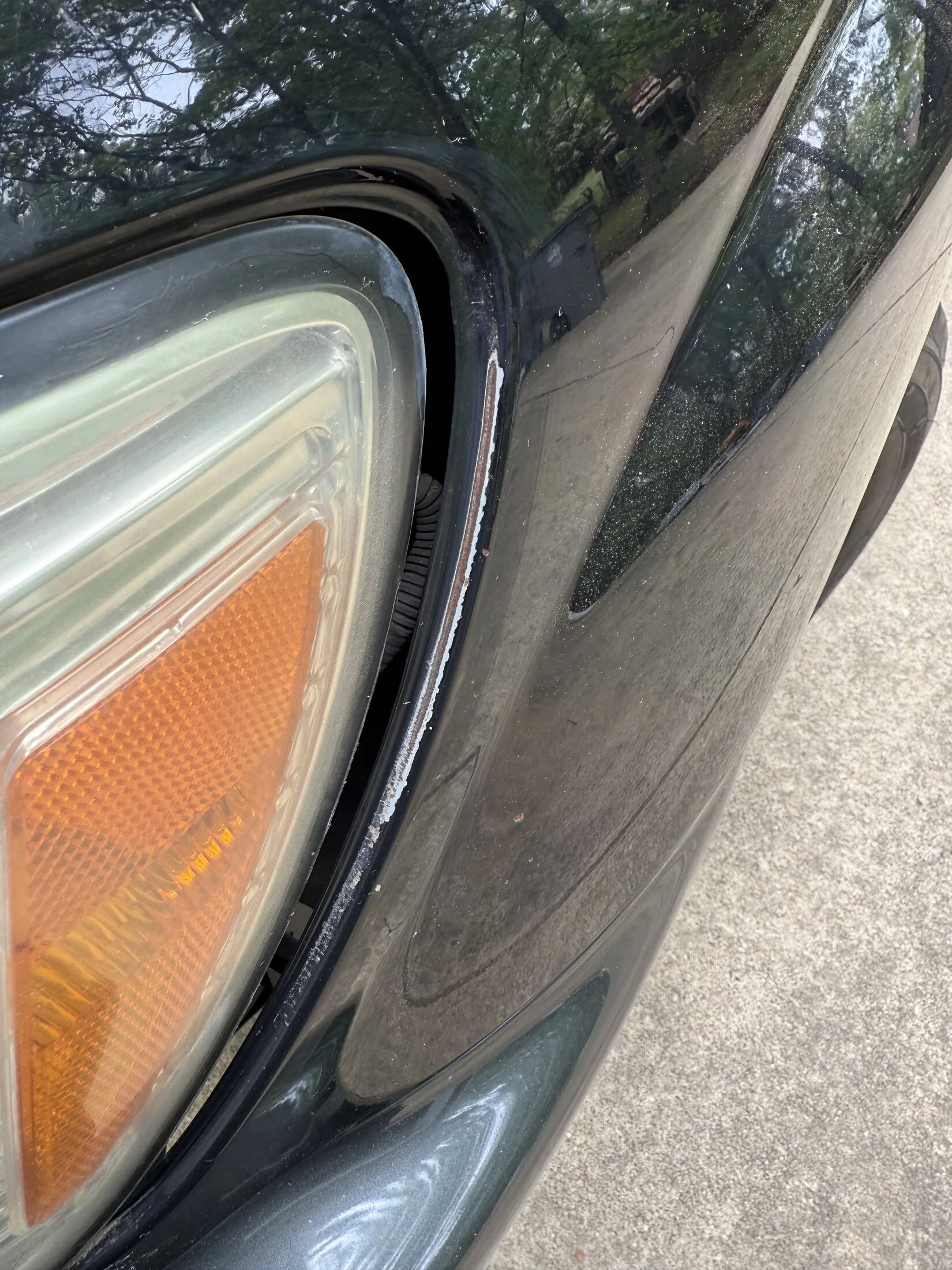

Well, less prevalent but still there. Could this be AHC?
Well, I believe we have a winner..
It appears the headlight assembly was rubbing on the fender.

Yeah, I’m wondering if the vibration that clearly telegraphed to that light / fender was a canary in a coal mine for something…
Brand spanking new OEM CV’s btw.
