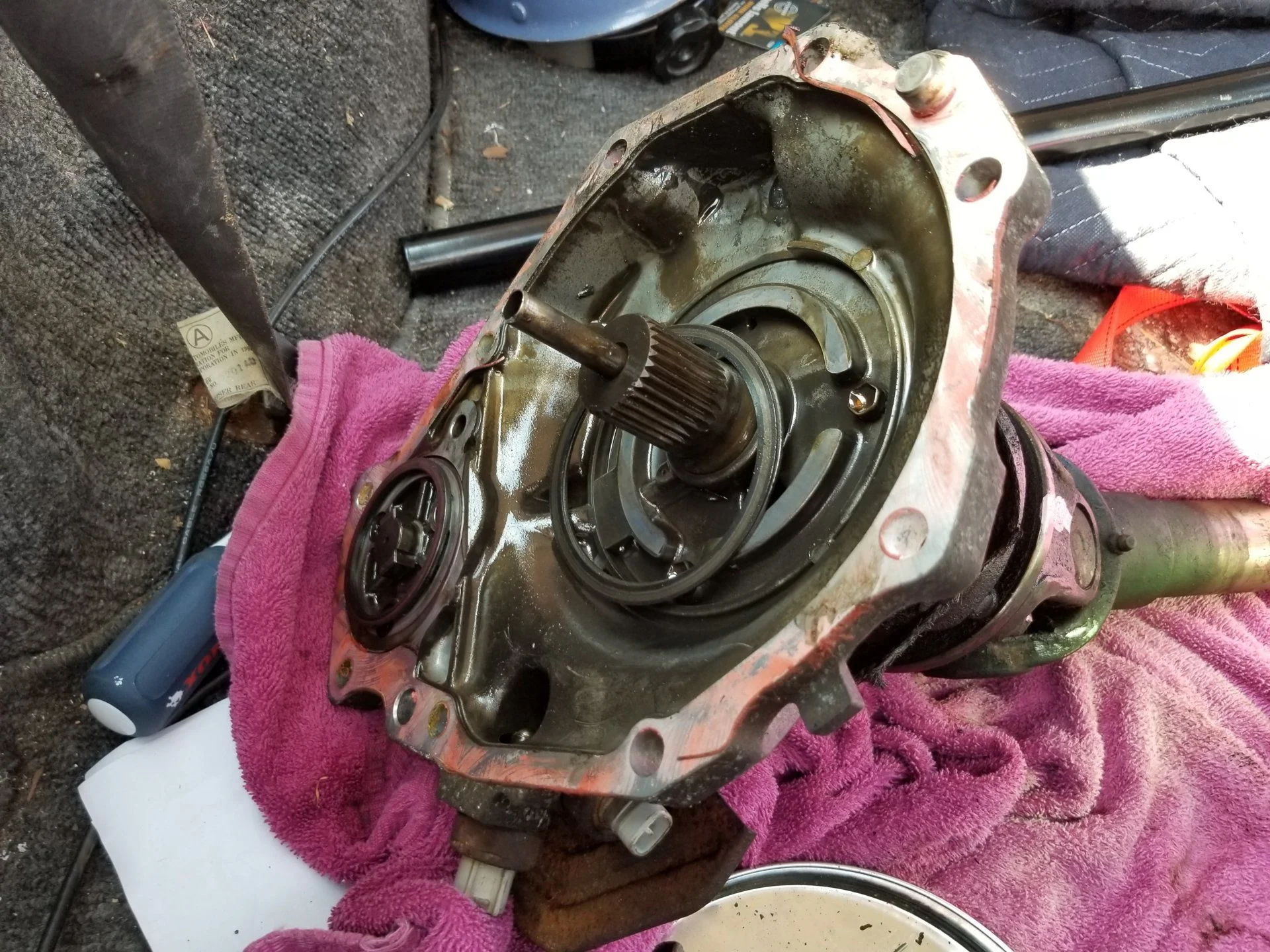

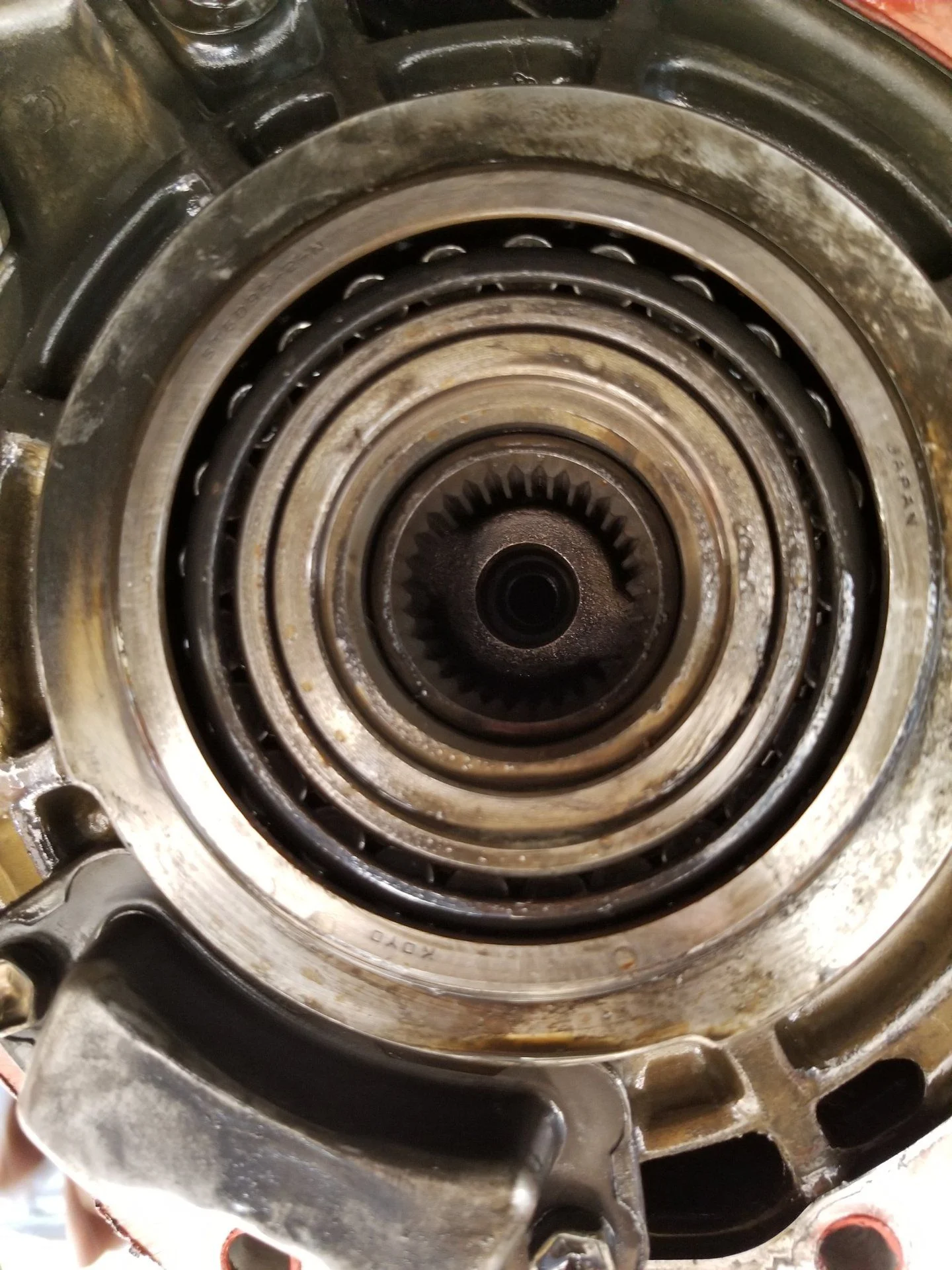

Still waiting on my mechanic, he checked the diffs, breaks all good. The transfer case was just drained and chunks of metal where in it. So we know that's shot, assuming the trans is good at this point. I think the trans is good, there was fluid in it and it never acted up before. So assuming its the transfer case....
What are my options, I see a lot out there, but I trust you guys. It's a 1991 FJ80 with 33's on it that will eventually have 35's, but that will be it on size. It has center factory and ARB rear locker, will eventually have front. This truck was for trips to go camping, fishing, hunting. What are your thoughts on what I should replace with?
It's not your DD right? Pull the transfer case and see what's chunked. If you're lucky you can just clean it up, put in new bearings and swap in the Terrain Tamer lower low gear and underdrive high gear. @OTRAMM did mine and I'm super happy with the results. You'll end up with 3.3:1 low gear and 10% underdrive which just about makes up for 35s. 33s might even feel down right peppy. Of course mines a 1FZ.
Worst case you pull the transfer case, open it up and more than the gears you're gonna replace are damaged and you have to find a used replacement. You could still take the opportunity to swap gears. I have a used transfer out of my 80 with low gears but I don't know if it's different than what's in a 91.
