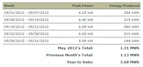

Here is this months production. My last 2 Xcel rebate checks have been for $124 and $102. That is right about where I expected giving a 10 year payback at around $12k. My original estimate was $7K so that make a huge difference in the final system cost! Winter's checks will be less of course but I think the average will be close to $100. It is a great feeling getting an electric bill with negative numbers on it.

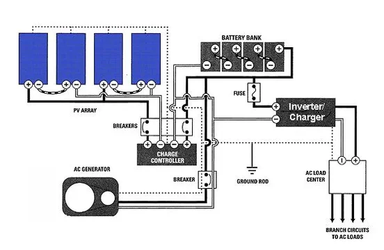

Here are some charts showing the difference between a off grid and grid tie system.
At a bare minimum for a DC offgrid setup you would need the panels, batteries and a charge controller. If you plan on utilizing this to power your home you need to convert the DC power into AC utilizing inverters or microinverters.
The main disadvantage of a grid tie system is that you are not energy independent or immune to power outages. If I have a power outage in my neighborhood I loose power too, even in the day time. I priced a battery backup and it added nearly $10K to my cost. Keep in mind I have a larger than average system. For that price I would rather install a whole house natural gas generator for $3-5K for the rare instances of a power outage. If the perverbial crap hits the fan I'll have other things to worry about than powering my house/fridge etc.
