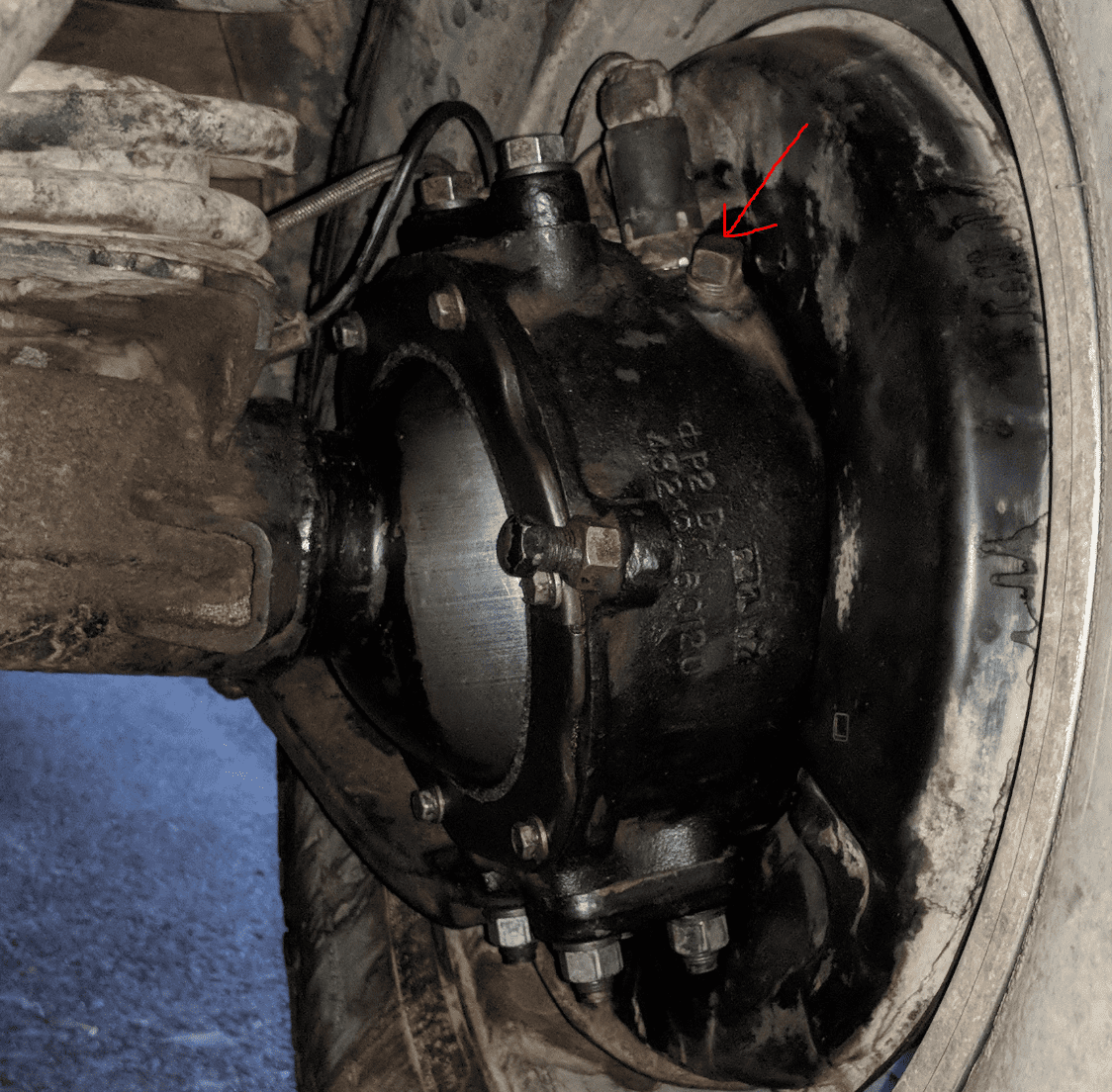

green arrow is the breather hose that needs to be clear?
where is the tube on the axle? i guess it is where the tube connects from the birfield to the axle?
also what is the blue arrow please?
Nope, the blue arrow is pointing to the ABS sensor plug. The Red Green arrow is pointing to the ABS wire.
The breather hose is further toward the center of the truck on the other side of the spring mount next to the bake line attachment.
