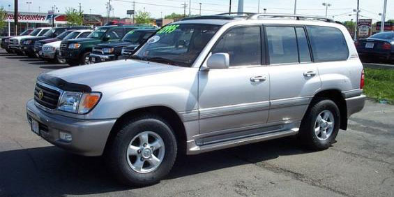

i got myself a 2001 land cruiser early last summer and ive always liked it; the adequate v8 and impressive stock off road capabilities were an attraction for me. however. If im honest i was always more of a sports car fan till mid summer when my friend took me on an off road trip and i realized how much fun it was. fast forward to currently, i find myself and a few friends getting together to off road quite a bit but we all have stock vehicles so now its time to upgrade and find some new trails. Problem is the options are little overwhelming when considering.. so i figured id ask you guys. any advice as to what to upgrade first is appreciated, im not going to be taking super serious trials so no 35 inch tires and big lifts for me, though, it maybe something to consider in the future. for now im looking at some 33 inch general grabber at2's because they supposedly have good snow and wet traction (we get a TON of snow, ice, slush, and rain here) and im also looking at some 18 inch 5 spoke 2008 tundra wheels that i could paint black and not need to worry about scratching them up.. their being offered very inexpensively so i may start there. a lift would be nice (i know you can fit the 285-75-16's without one) but problem is im still a student and slee is quite expensive but its still possible. anyways enough from me id like to hear what you guys have to say. i will post pictures soon; i have a new camera im still figuring out. feel free to post pictures of your own land cruisers ive seen some really cool 100 series on here.
The wheels:
Not my land cruiser but its the same color and window tint:
P.S. about the running boards i know they have to go but its too cold out this time of year so they'll come off when it warms up or next time it goes to my mechanics shop, which ever comes first
