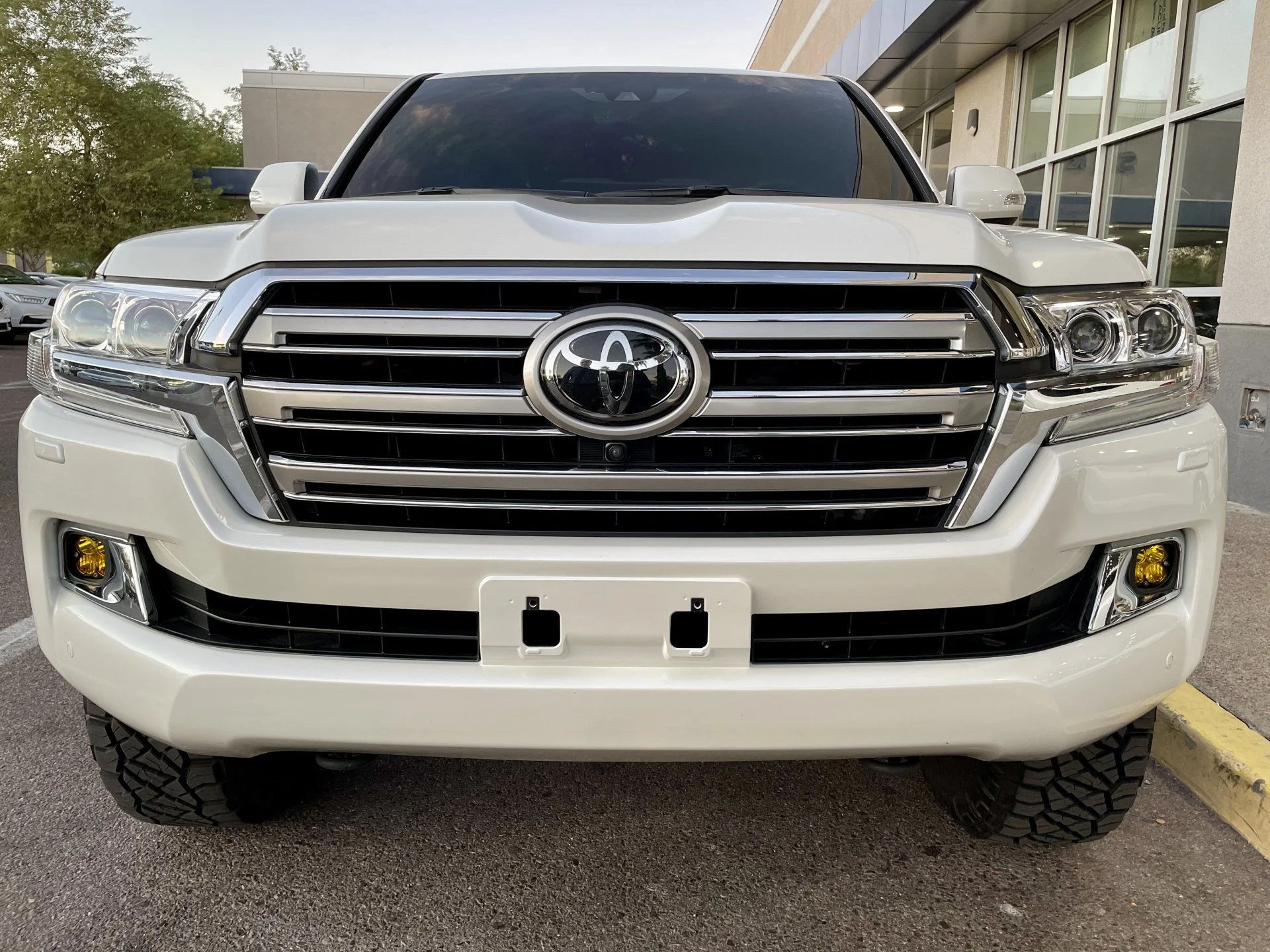

While I appreciate the value and effectiveness of the LightForce's, I'm hesitant to mount anything to the oem bumper or especially something designed for the license plate holder. Too many occasions in which I'm parallel parked, and my daily commute is down a rutted out sand and clay road that makes for lots of vibrations and fine dust.
The ability to replace/improve an existing light source, whether it's housed in the fogs or headlight framework is appealing to me. I will be on the lookout for HID's or LED's with the characteristics you highlighted. Cheers.

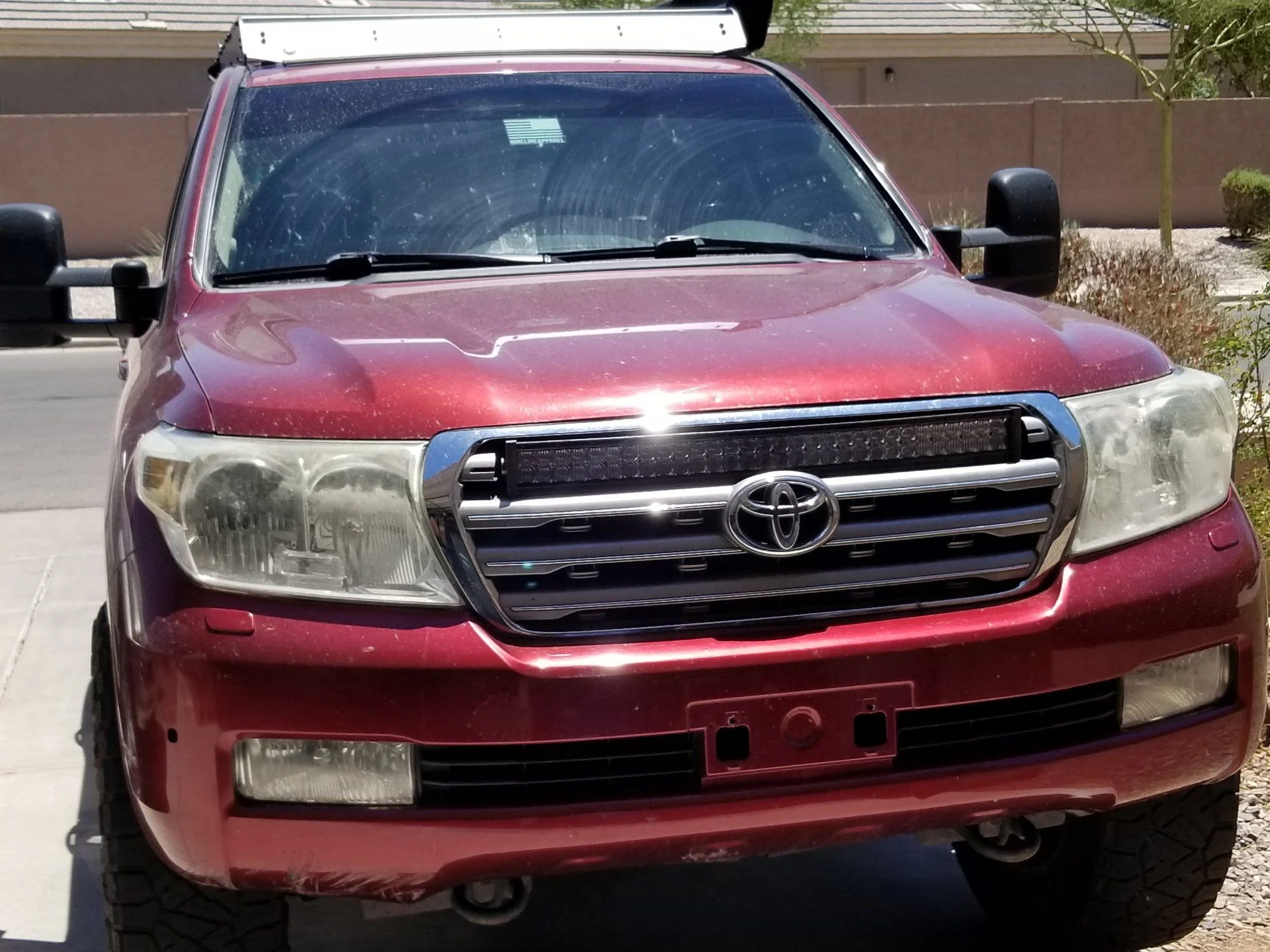

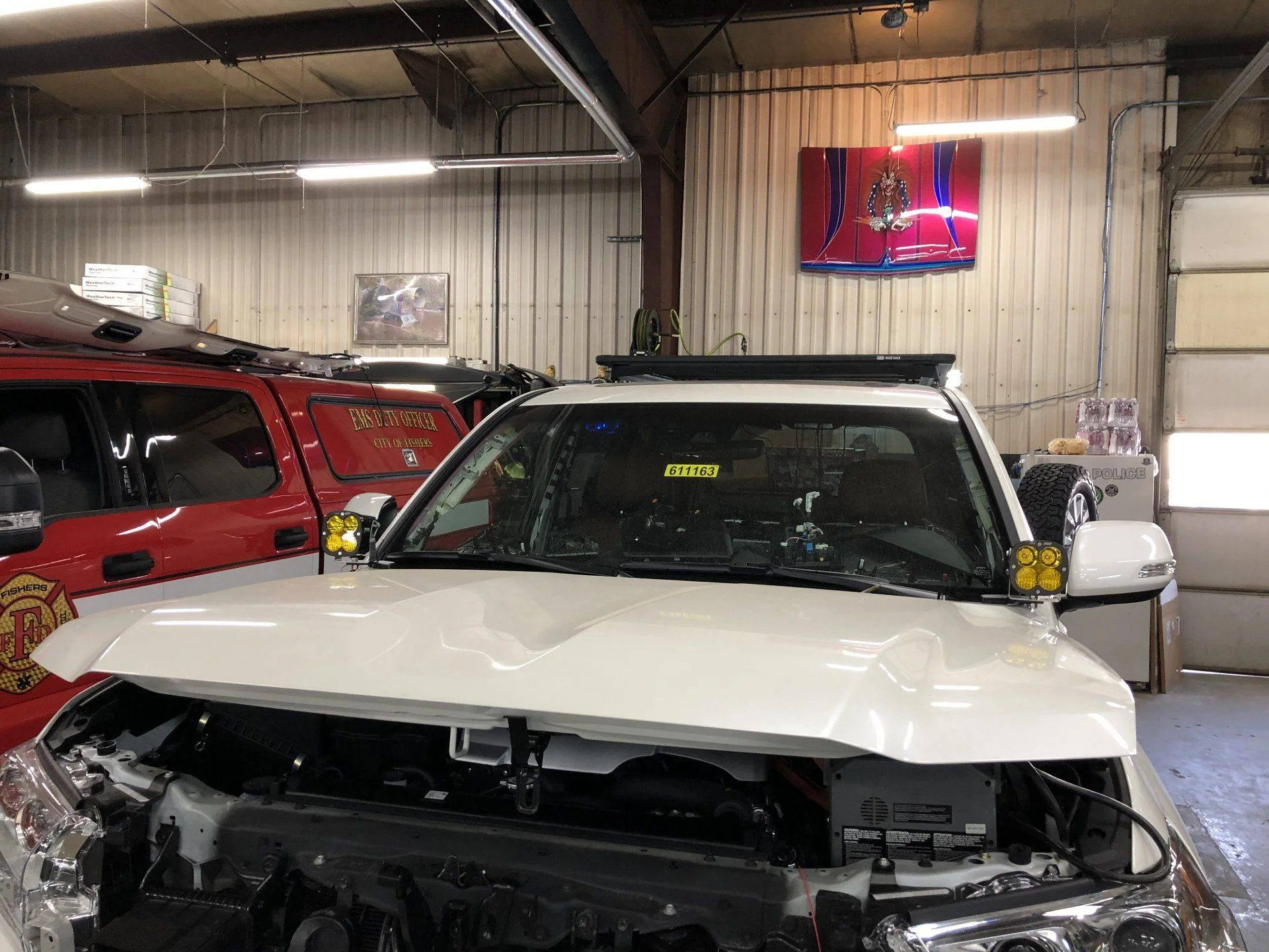

It takes a little fab work to make brackets to hard mount to the metal behind the grill, but it's not too difficult. My 90$ Amazon light bar isn't the best out there but it's held up for a few years now. Led headlights made all the difference in the world for the older style lights in the 08.

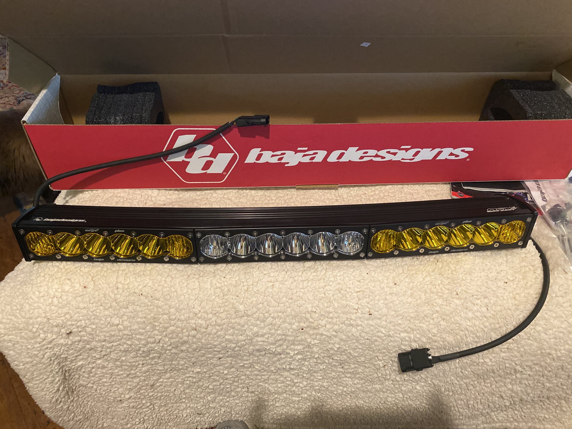

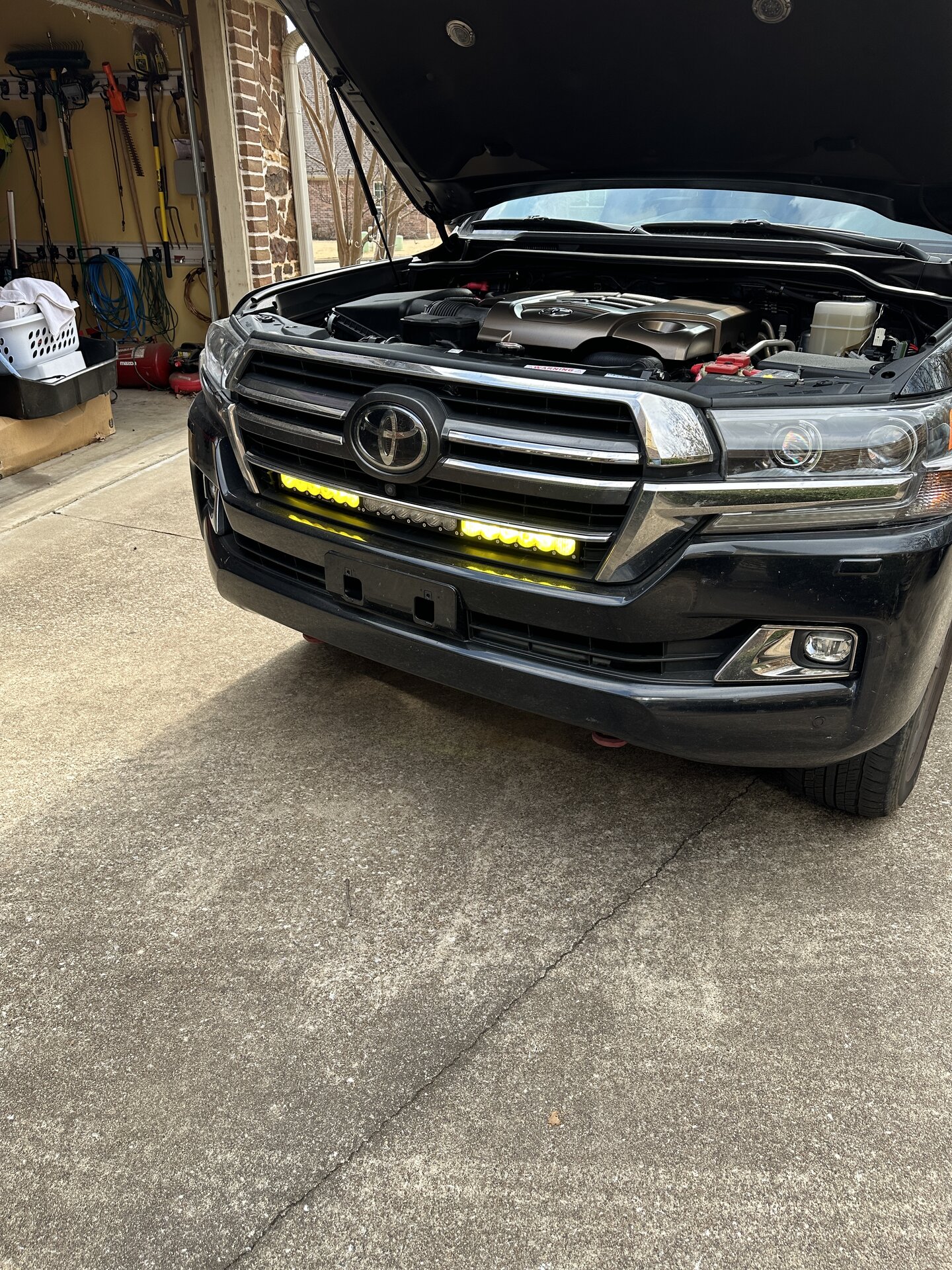

While my grille (Heritage 2020) is different I think they can all be cut to fit a light. I went with a Baja Designs 52-3003DC which is the 30" Curved ONx6 Dual Control amber drive, white spot. Although a cheaper version should fit too.

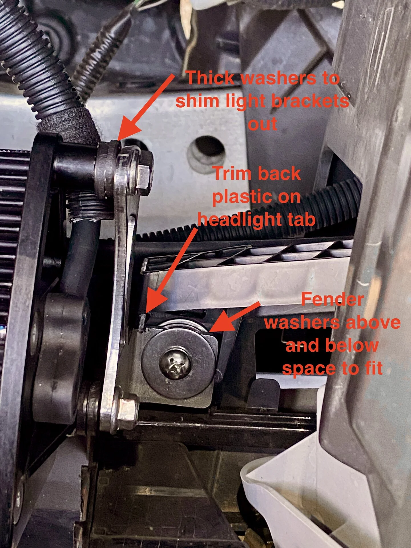

Did you have a mount you could directly screw into, or did you mod/customize something that was already there?

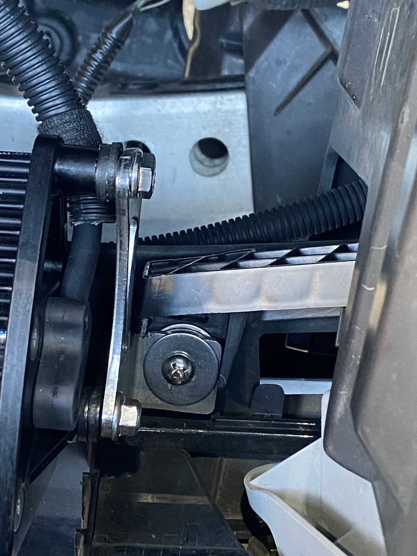

That screw head in the middle picture is a mounting point of the headlights (at least 2016+ models). The Baja kit came with SS side brackets which I has to space out with some thick washers to achieve the OEM hole spacing. Then replaced headlight screw with a longer one and some fender washers to get correct height to clear grill. Only mods to the car was cutting out stats in the grill.
There is a folded sheet steel crossmember that joins the inner corners of the headlights together, roughly at the bottom of the grill. It should provide a sturdy enough mounting area.
Then behind the grill is an assortment of potential mounting places on the metalwork that is in Front of the radiator / supports the radiator

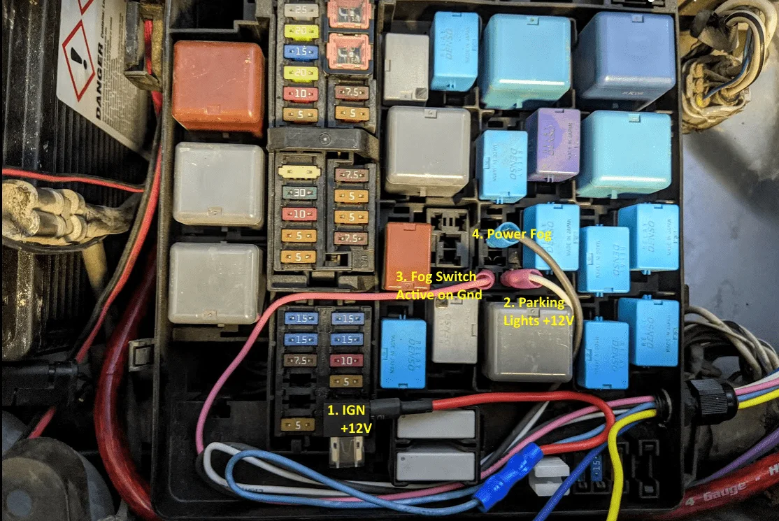

I REALLY miss this mod I had on my old truck. DEFINITELY saved me several times missing bucks/does throughout the year being able to spot them long before they were meeting me at 55 mph. Has anyone used any of the STEDI lighting harnesses to tap into OEM wiring, or is the usual thing to go for the switchpro hub?
I had a SPDT setup that was clutch in my old rig and I'd like to mirror that if possible with KISS in mind. My hang-up in just pushing forward with this is that I'd need a relay point under the hood and I am a big fan of some of the fuse blocks, etc that some of you have concocted. I don't like the idea of just tapping into OEM wiring when possible, but there's no alternative I can think of to get the same setup I had before without defiling the existing wiring.
